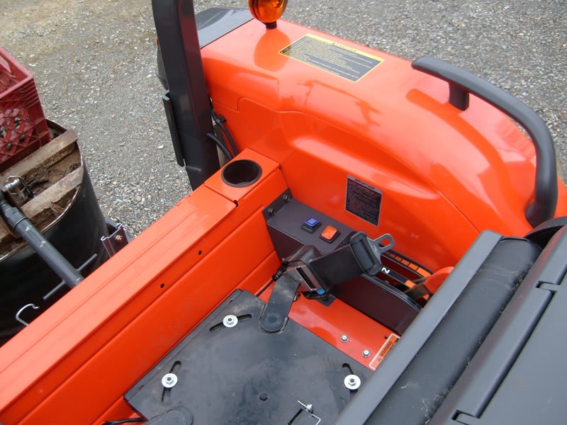

On my 4240 I mounted two switches in the steel panel that has the slots in it for the cruse control and HST Gear selector. I ran the power from the wire harness on the other side of the seat. I found some sealed rocker switches on ebay. I wanted something that was easy to reach and could be toggled with gloves on. I didn't bother with lighted since they are the only things in that area and I find that I can turn them on and off without even looking at them.
I went with this style of switch but one is blue while the other is green. That panel is easy to remove so I just drilled two round holes and then used a file to turn it into a rectangle.

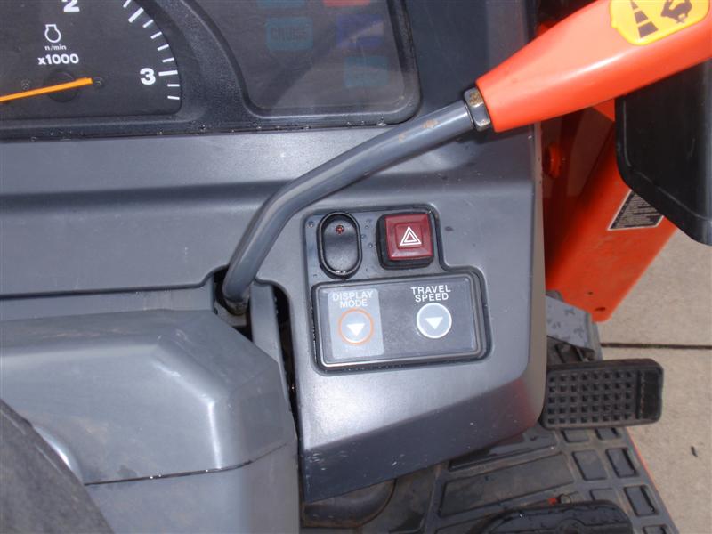

I drilled a hole in the dash for the original Dorman switch and later enlarged it to fit the better one from Digikey. I don't have a photo of the new switch, but this gives you the idea. Same basic place, just a rectangular switch now.

Not sure when I took this picture but here's my switches.
I guess I used the orange switch not the green one. I got 4 different color ones.
