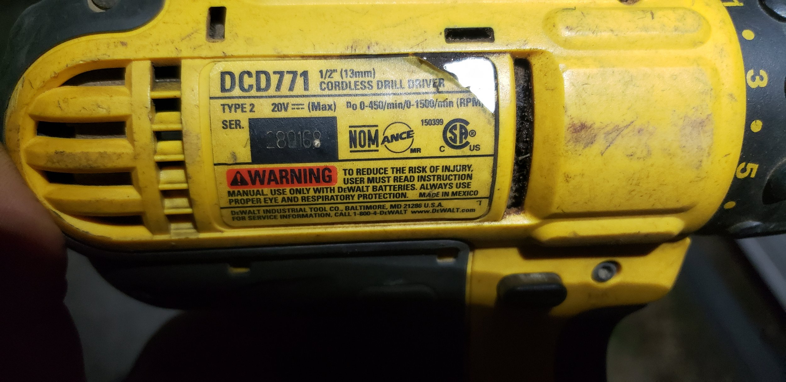

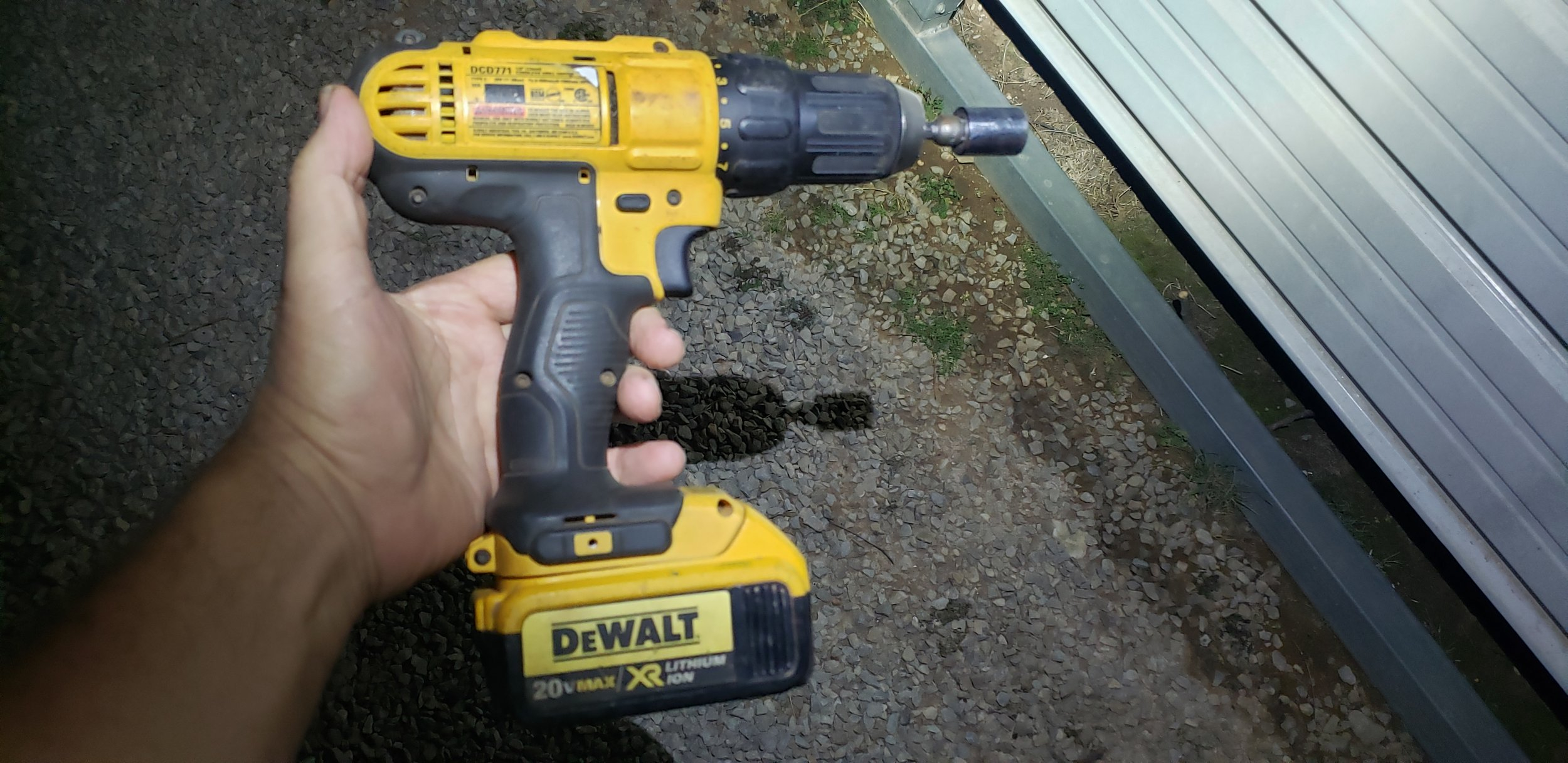

Made mine today.
Easy.
On edit, mine comes apart when drilling counter clockwise, so i am going to weld the coupling nut to the cap. Also, my 3/4” bolt head needed a little grinding to fit inside the 1” galv pipe cap.
I probably should have used 5/8”, but once welded, it wont spin anymore.
Thanks for the inspiration J Coastie

On my 25' fifth wheel, I welded a nut on years ago and used a drill for the landing gear. I recently acquired a 1/4" impact and the first time I used that, I twisted off the adapter. I just make sure I also have the right size socket and ratchet to do it by hand if this happens again after I've gone back to my drill.

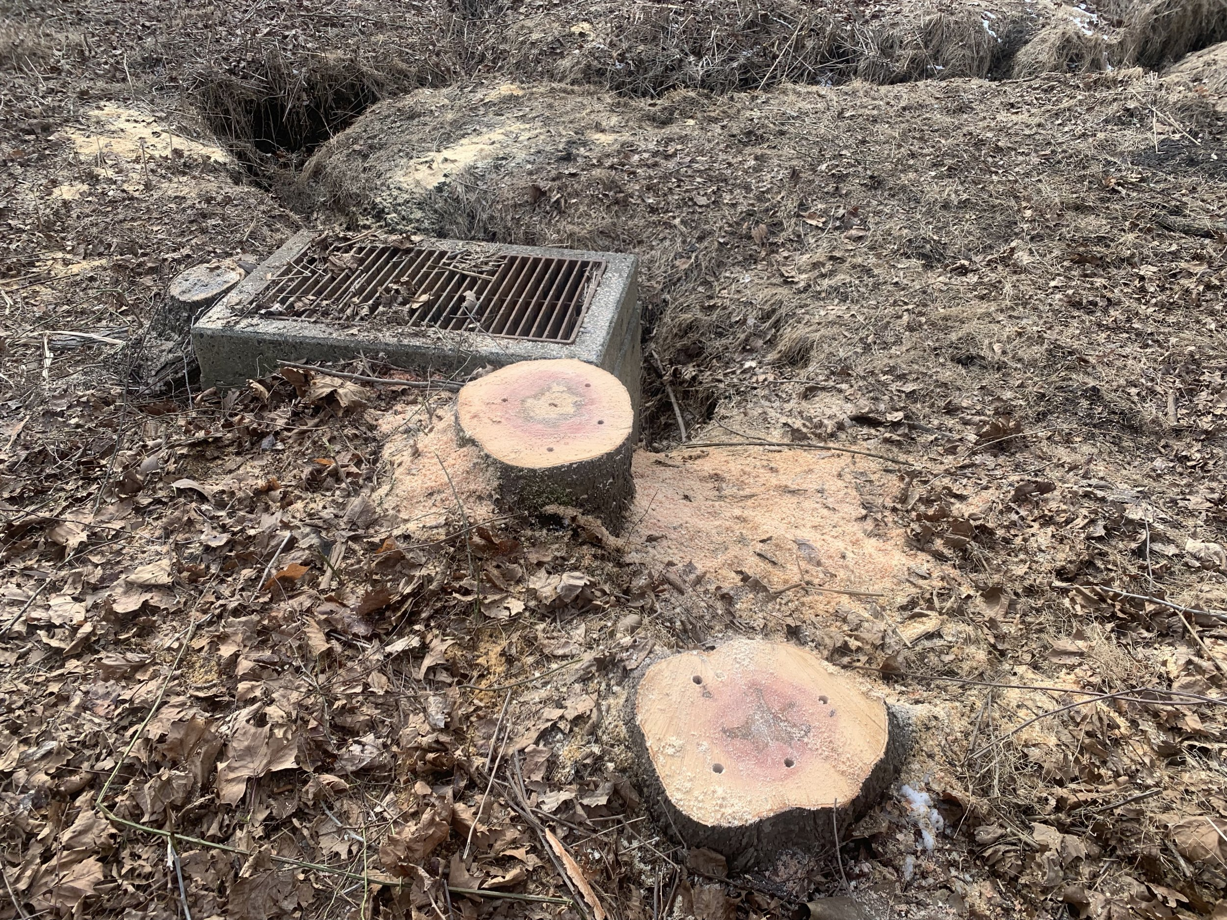

Yeah be careful with the new powerful drills. I just cut down several trees for an HOA and farm customer today.
After I cut them, I drilled the stumps for Roundup with my 60V DeWalt and a 1” bit. I was dead tired and not paying attention. Drill got me and took my wrist for a spin.
I didnt set the clutch properly.
/ 12k Trailer Jack Drill Adapter #32
Hay dude, save yourself some trouble next time and just put the Roundup all the way around the cambium layer on top of the fresh cut stump, it will do the job, no hole drilling required. Charlie.
/ 12k Trailer Jack Drill Adapter #33
I did both thanks!

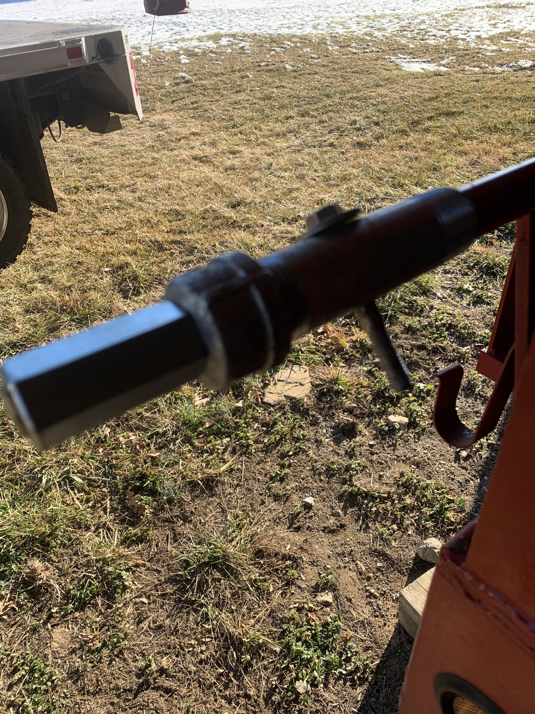

Modified my dump trailer jack drive with a standard 1.5" x 10 spline manual slack adjuster and drive it with my cordless drill, works good. I think they are geared at about 24-1. It is kinda slow but so is the manual crank.

I drilled a 1/4" hole in the pipe adapter with a 1/4" grade 8 bolt with the head cut off, just the right length to engage two of the splines of the slack adjuster.
With a fresh 3amp battery and my cheap john Craftsman 19.2 1/2" drill I had no problem unhooking my dump. I use high setting to get the jacks on the ground then switch to low and lift it off. The drill is rated 400 in lbs. My brother is a Milwaukee dealer so he sent me a 1/2" 18v 500 in lbs drill kit, anxious to get it and try it.
/ 12k Trailer Jack Drill Adapter #38
How does your drill fit over the jack tube? Mine wont open that big.
/ 12k Trailer Jack Drill Adapter #39
My drill don't have enough power to direct drive. I drive the 9/16" adjuster screw on the slack adjuster to get the 24-1 power reduction.
