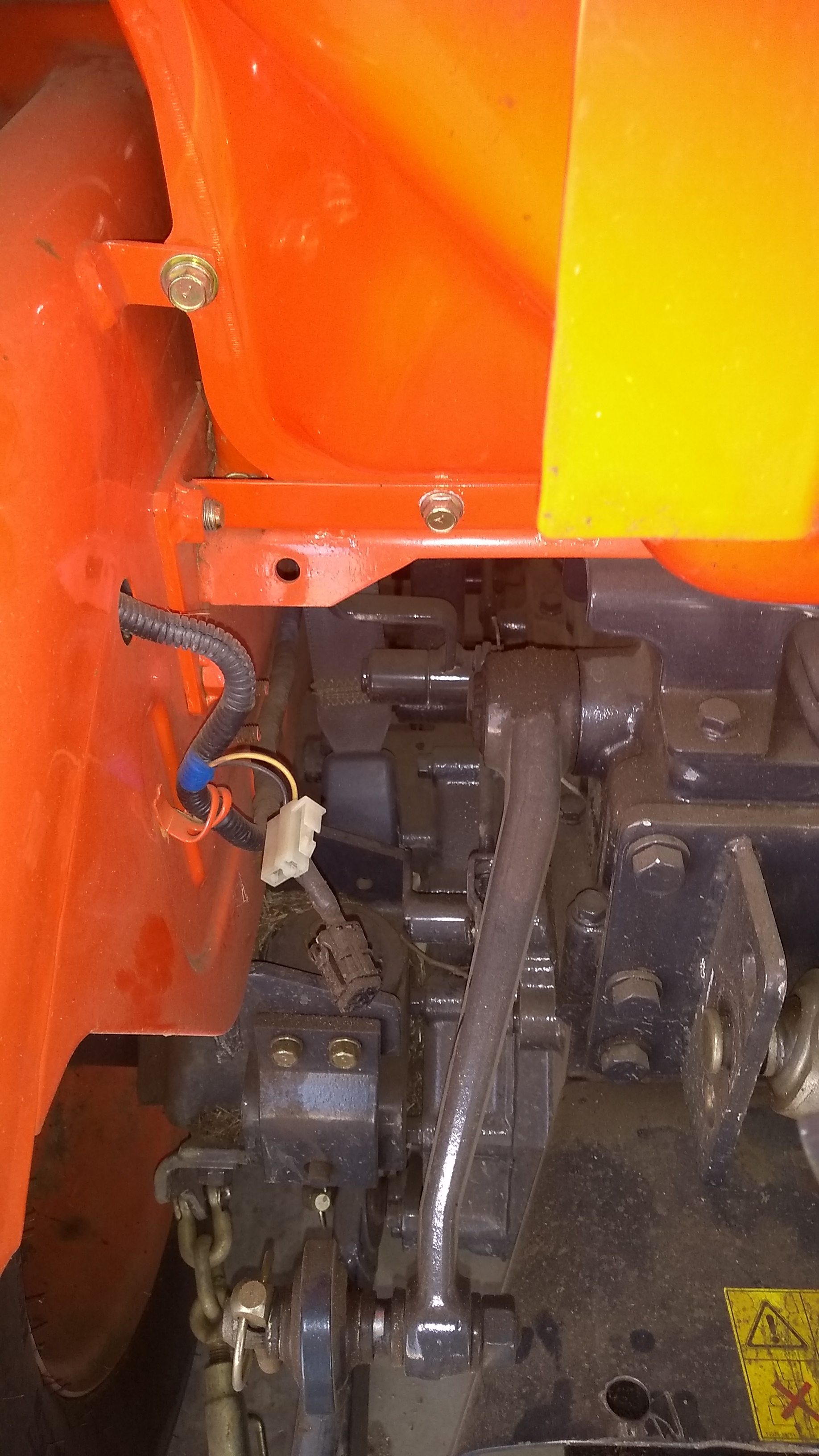

I installed a lighter on my Cub Cadet Z Force mower where the correct size knock out plug already was. I wired right to battery with a fuse holder, 20A fuse right at battery +.

Mounted very near the same place as you. I have two sets of extra wires near. I guess one is for worklight. I am not sure about the other. The first will only be hot when I have the lights on? The second set never seems to be hot. It is possible that I am not getting good contact. The plug ends are difficult to clean due to their location.
I don't know if all kioti models are the same, but my CK3010 had a pair of wires on the right that are active when the ignition or acc is on, and on the left it has a white rectangular plug that is active all the time, even if the tractor is not running or ignition/acc is on.

I seem to have two sets of wires at the back of tractor. One is for an optional worklight and i am not sure about the other. I have checked the fusebox and they are hot but i am not getting juice at the plug ends. I have checked the fuses. What am I missing.

They're probably hardwired to your light-switch so that you can turn the worklight on/off from there. That's the way it is on my 4105. OFF/Hazards/Front-lights & Hazards/Front-lights & Worklight.
I only have the one pre-existing wires/connection so I can't advise where your second set would be switched to.

The second set was not labeled but was hot when the lights are on. That should work. I never could get the work light pigtail hot.
