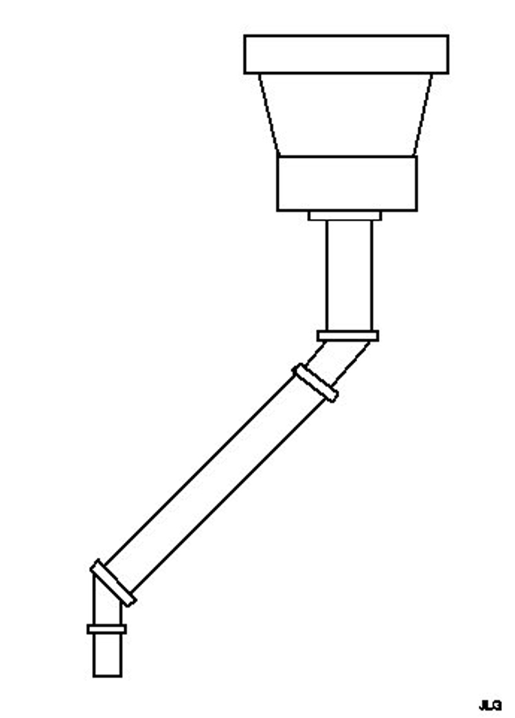

I don't know if this idea will help you any or not. I needed a third hand to hold the funnel to put hydraulic fluid in. What I did was make a funnel from PVC. I used a 4-2" bell and then 45* angles with short pieces of pipe. The pipe diameter was sized to fit snug into the transmission of the tractor and the last piece long enough to make the whole thing stable even when full of oil. It works great. Maybe something similar would work for you. See the attachment above.
