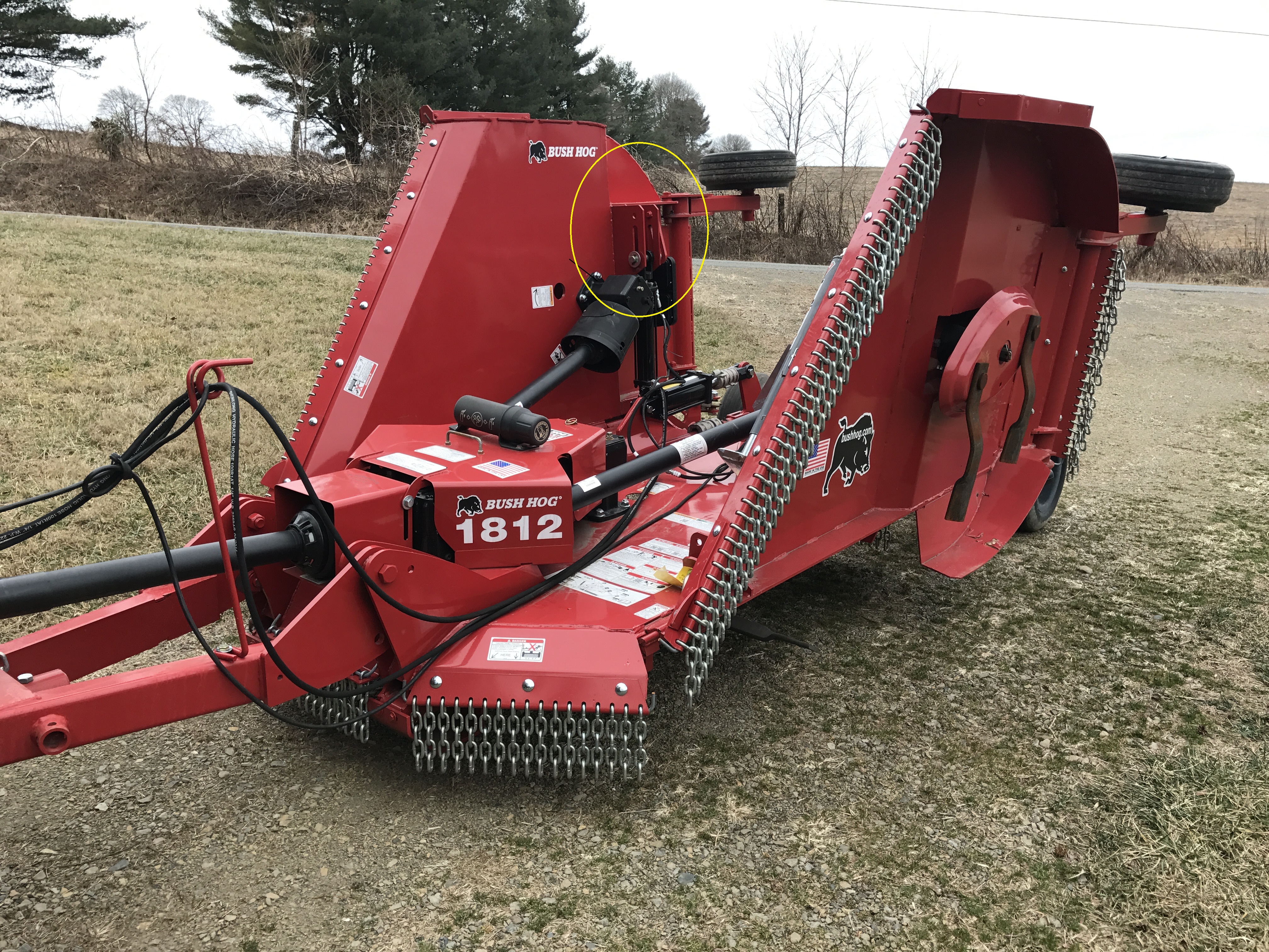

My 5740 only has 1 set of remotes and the batwing is plummed to run that way. After it lifts the unit off the ground then the hydraulic fluid is diverted to the wings to fold up. That is why I was asking. You only have to have 1 set of remotes to operate a batwing if it is plumed corectly for it..
   / 12' Bat Wing With L6060 #20
How do the wings float? Seems if you put it in float everything would come down. I guess if you have your height cylinder adjusted correctly with shims it would be ok though
