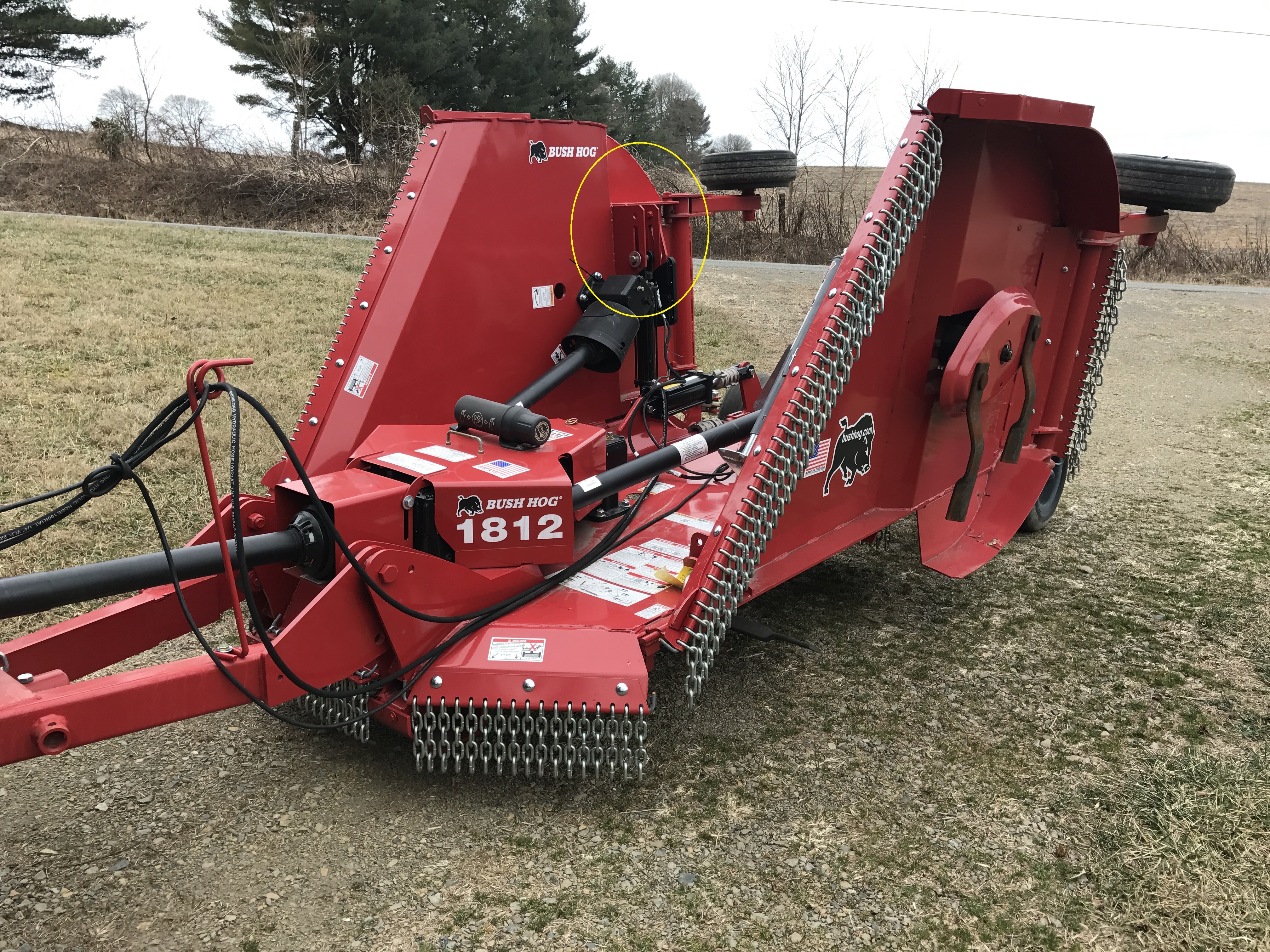

How do the wings float? Seems if you put it in float everything would come down. I guess if you have your height cylinder adjusted correctly with shims it would be ok though

My Bush Hog brand 12' BW has channels the ends of the hydraulic lift cylinder that the ends float in. This allows movement of the wings without any float action of the hydraulic cylinders themselves. The wheels on the wings follow the terrain moving the wings up and down. The channel is circled in yellow.
