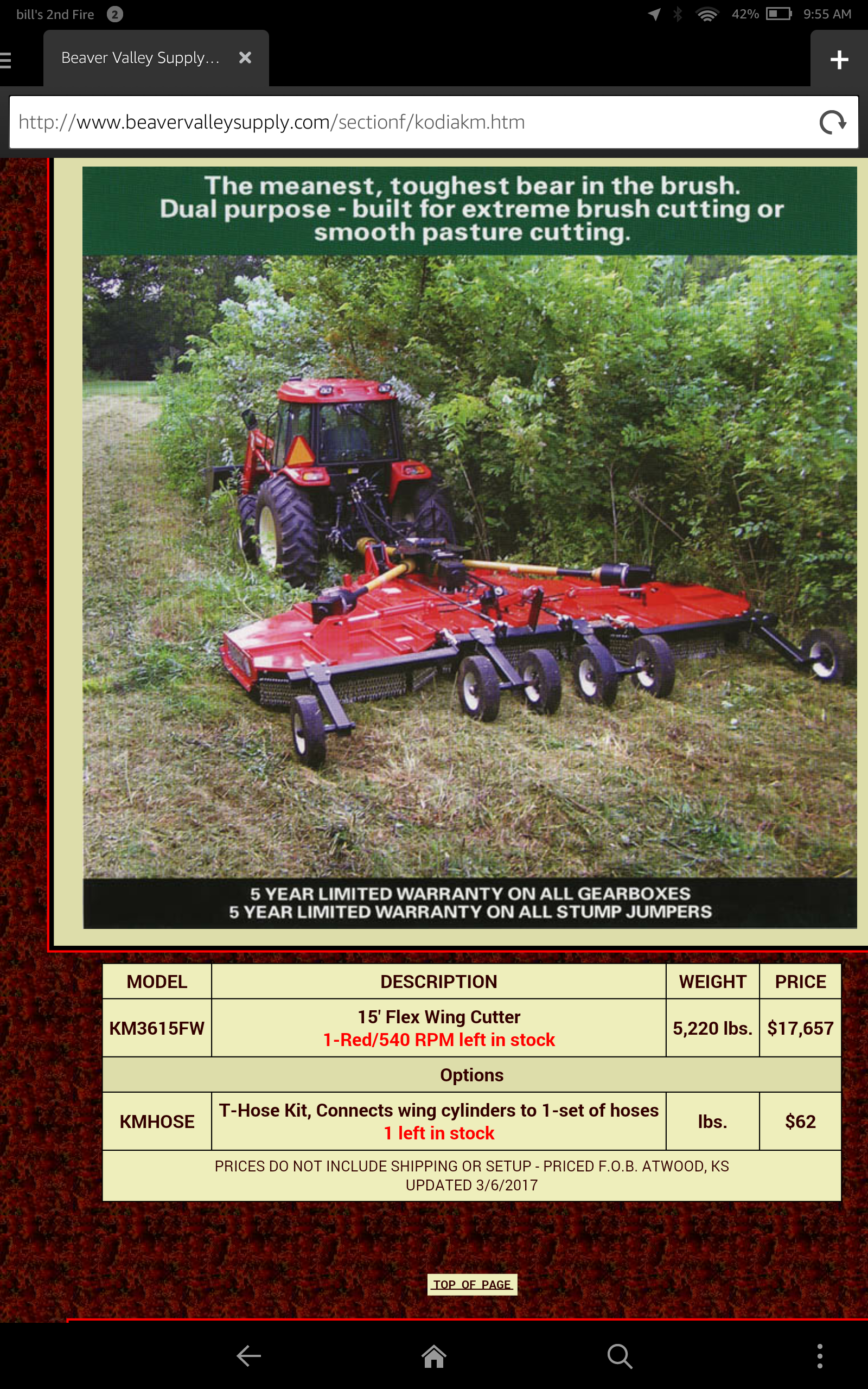

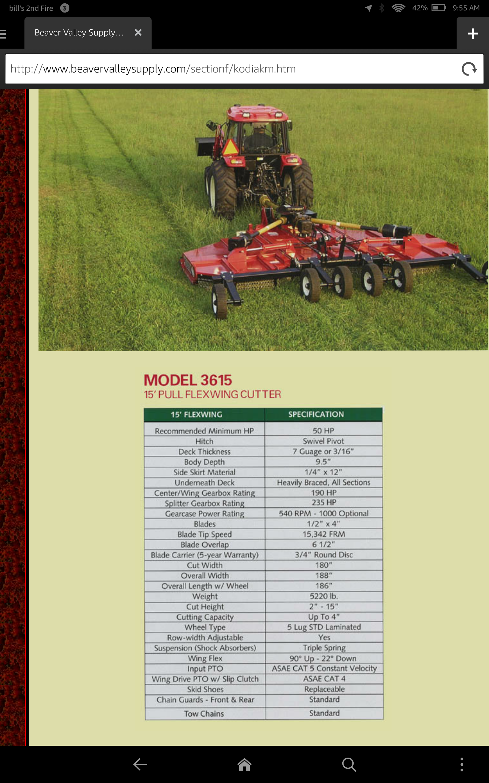

SDT,
Tractor envy here. M9960 very desirable machine, would take very high interest rate or family emergency to consider downsizing. Is HST a significant advantage using a batwing mower?
At any rate , Kodiak offers a 15' mower with a 50 hp requirement. Just a FYI for comparison.
