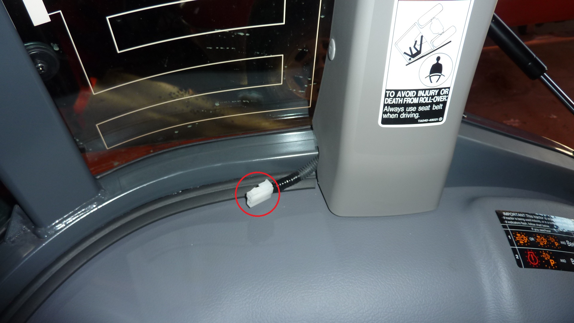

Anyone know the purpose of this connector? It's on the left side of the cab behind the support pillar.

Uhmm. I always assumed it was for the quarter glass defroster, but since you have the defroster I have no idea. I'll look into it.
/ L6060 Cab Questions #65
I am not so good at reading wiring diagrams, but it appears to be on the same circuit as the cigarette lighter, and fused at 20a. Had some type of generic lable like "power connector"...

I assumed it was some sort of DC power connector. Not sure what it could be used for but it could come in handy. Maybe for powering something outside the tractor by running a wire through the open window? The same could be done on the opposite side using the cigarette lighter socket.
In any case, thanks for the information!

That's on all Kubotas, even open station machines. So pretty sure not for a defroster. On the economy Ls for the past generation or 2 it's taped under the left fender. On cabbed Grands it's under the pillar over the left fender. I think it's under the fender for open station Grands as well, but haven't looked.
Pretty sure it's a generic 12v accessory circuit. It's a commonish HAM radio power plug. Original 2 pin Power connector for VHF/UHF Power cords - Power source side | Powerwerx although I forget which gender you need. Powerwerx has both. Or cut it off & put an PowerPole on or better yet something weatherproof if it's open station.

It just ties to the lighter circuit. I used mine to put a small switch panel in to the pillar for a few accessories.

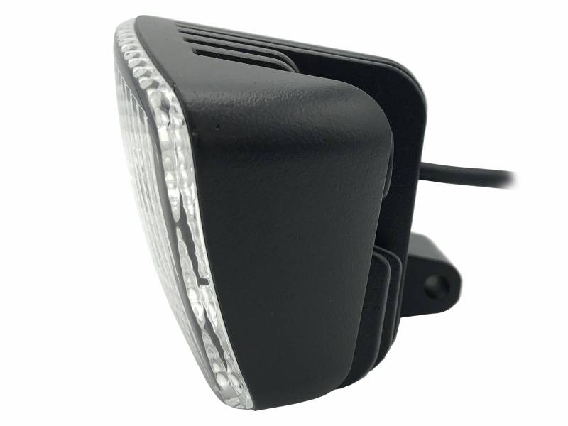

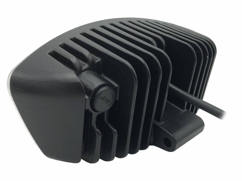

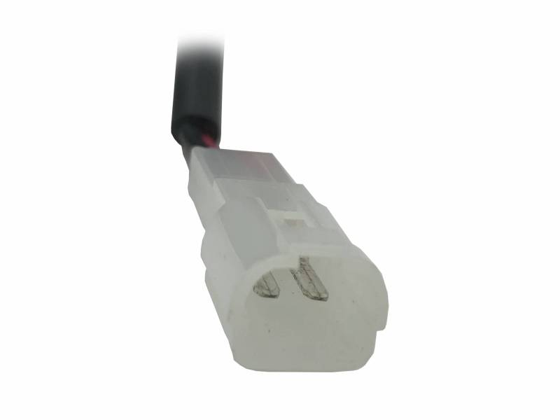

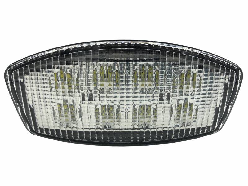

Anyone use these TigerLight TL3240 LED cab worklights on an L6060?
LED Work Light for Kubota Tractors, TL324 Agricultural LED Lights; from Tiger Lights
Not cheap at $95, but they are supposed to be plug & play. They appear to have the same profile as the Kubota OEM halogen cab lights but the connector looks different.
I have a bunch of LED work lights laying around the shop that could be altered to fit the L6060 but it would mean making new brackets and cutting off the OEM connectors. Also, they won't fit in the alcove molded into the cab roof like the OEM lights. They would protrude forward a few inches and block a bit of the view out the cab windshield. A very minor point I'll admit but it can be an issue when working with the FEL at full height.
Can anyone verify these TL3240's are truly plug & play on the L6060? If so, are they bright enough to make them worth $95?

I don't recall what the connectors looked like when I replaced mine. I prefer soldered connections with heat shrink.
As far as the lights, the photos posted look to me like they will splatter light over a very short distance.
I installed 1/2 flood, 1/2 spot leds.

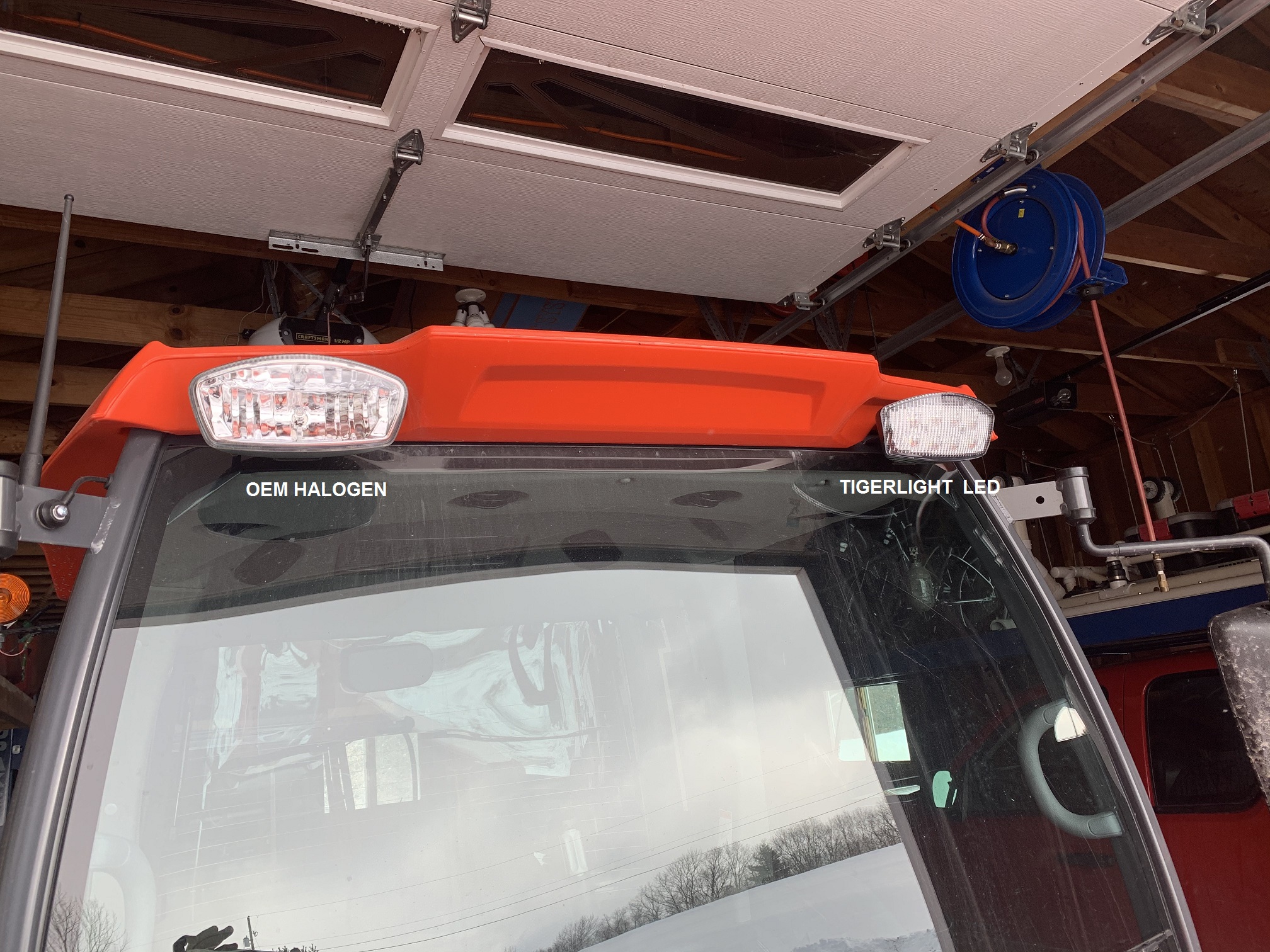

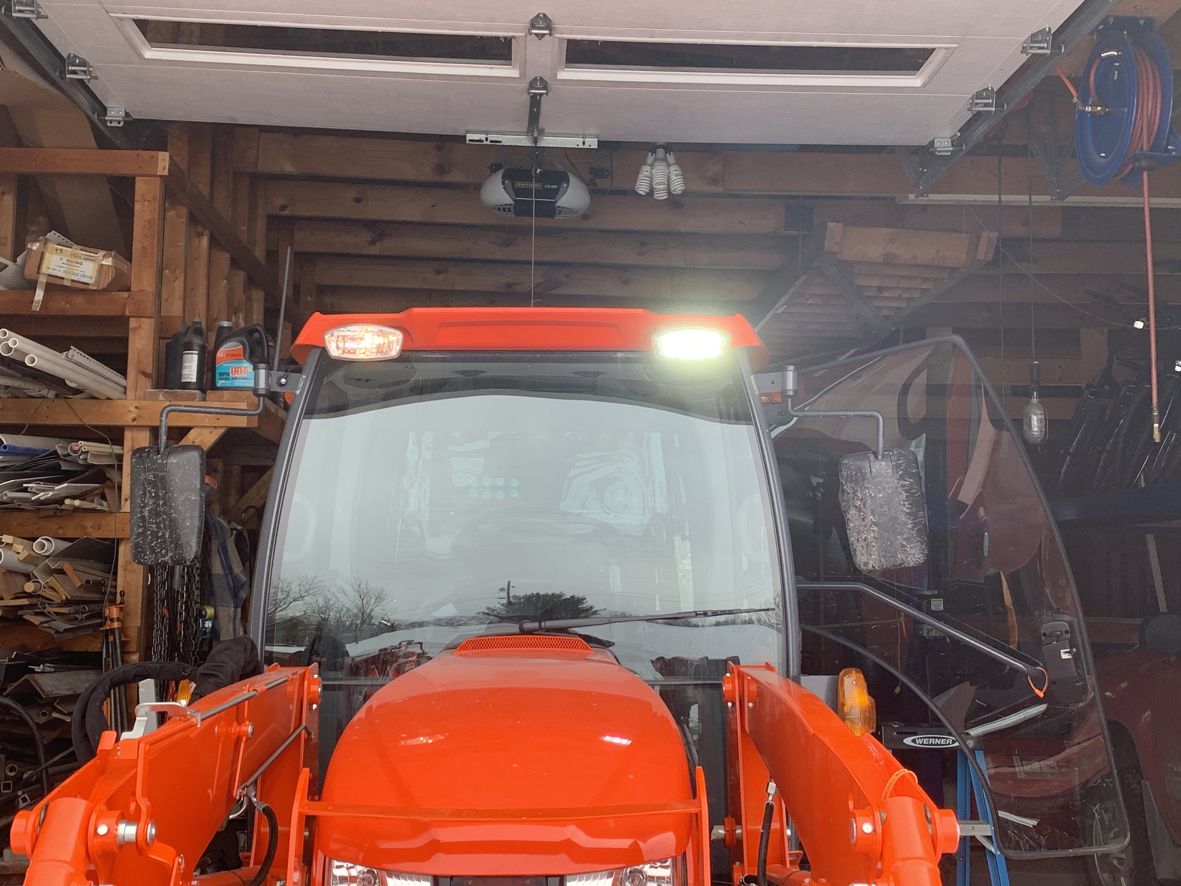

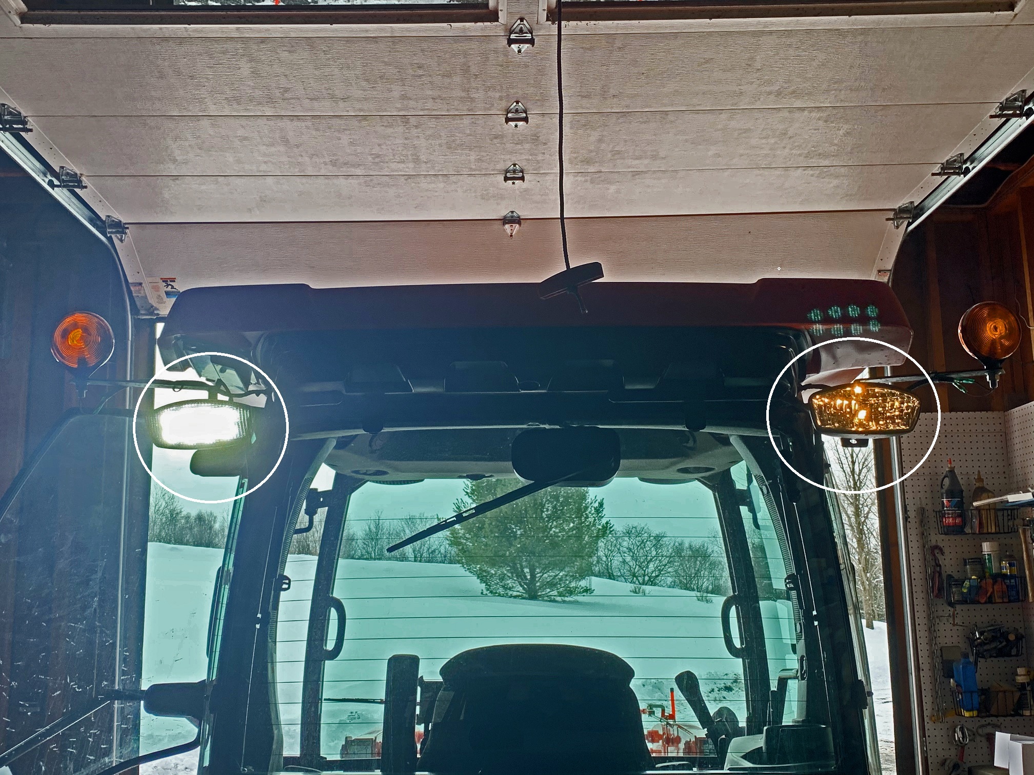

I went ahead and ordered these Tigerlight cab work lights. They are a direct replacement for the OEM halogen cab lights on the L6060 as well as many other Kubota models. The connector and mounting bracket fit perfectly.
Although it's difficult to see in the pics, the Tigerlights easily throw 5 times the light compared to the OEM halogens! In my case, this will make night work a lot easier! Well worth the $$ IMO.

Thanks for the post. I have bookmarked this. I have too many projects at the moment but new work lights are on my list. To you happen to know if these lights will also work on the rear?

Yes, they will work on the rear. All four lights are the same. It isn't easy to tell but the second pic shows a comparison from the rear. It's a 60 minute project at the most. The hardest part was separating the electrical connectors.

Yes, I put them front and rear on two L6060’s. They fit perfectly and make great light. I bought them from Larsen Lights.
