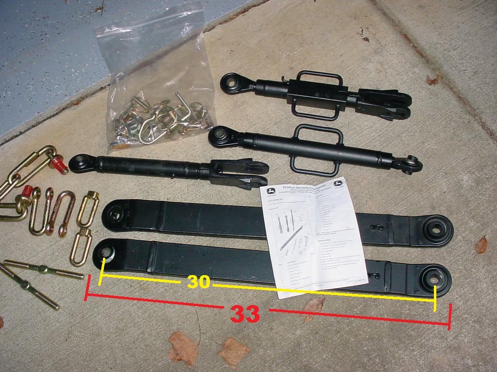

I'm about to purchase the 3pt hitch arms used and the seller tells me he believes they're off a 110.
Can some measure there 110 tlb hitch componets and post the specs? I'd hate to waste the money if they won't fit.

Are you looking for the hydraulic set # LVB25340(top n tilt) or the standard set # LVB24858
/ 110 TLB 3pt hitch question #3
The set that I have is 7/8'' thick 33'' long. JD # LVB24858

The set Doc shows looks correct to me. If it were me I would try to get a set of telescopic arms instead from a 4000 series tractor. Way easier to hook up a clevis hitch box blade if you have the telescopic links. I fought with the standard hitch arms for four years and it was a chore to hook up the equipment by my self. The new telescopic arms made it easy to do.

All of attachments that I have hooked up were light weight (), back blade 600 lbs, landscape rake 300 lbs. The box blade I"m going to hook up weights 1250. I can't move it by hand!!! I got a feeling I will be looking for a set of telescopic arms like you have.

Well, they turned out to be the correct 3pt hitch. I also picked up a grapple for the backhoe.
The hitch looks to be near unused and I go it for a fair $275.
