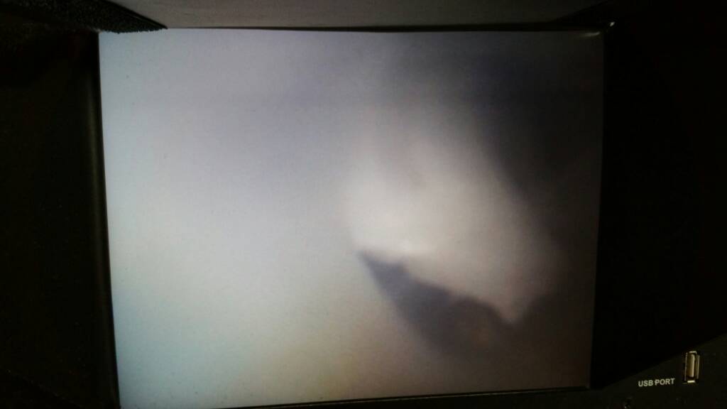

As a home inspector I have been involved in a half dozen water line breaks under homes as a result of impacts on the plastic water lines during construction. I have several cameras that I use to locate the source of the leak. Recently I discover a 10 year old leak that I guestimate was spraying about 5 gal per min into the crushed rock weeping tile and eventually running down the sewer line via the sump. If I did my math correctly that's about 5.5 million gallons. Lucky for the sellers the leak was before the meter. The wight poly line was like a rock penetration. 20170919_135403.jpg20170911_113300.jpg20150402_150325.jpg
