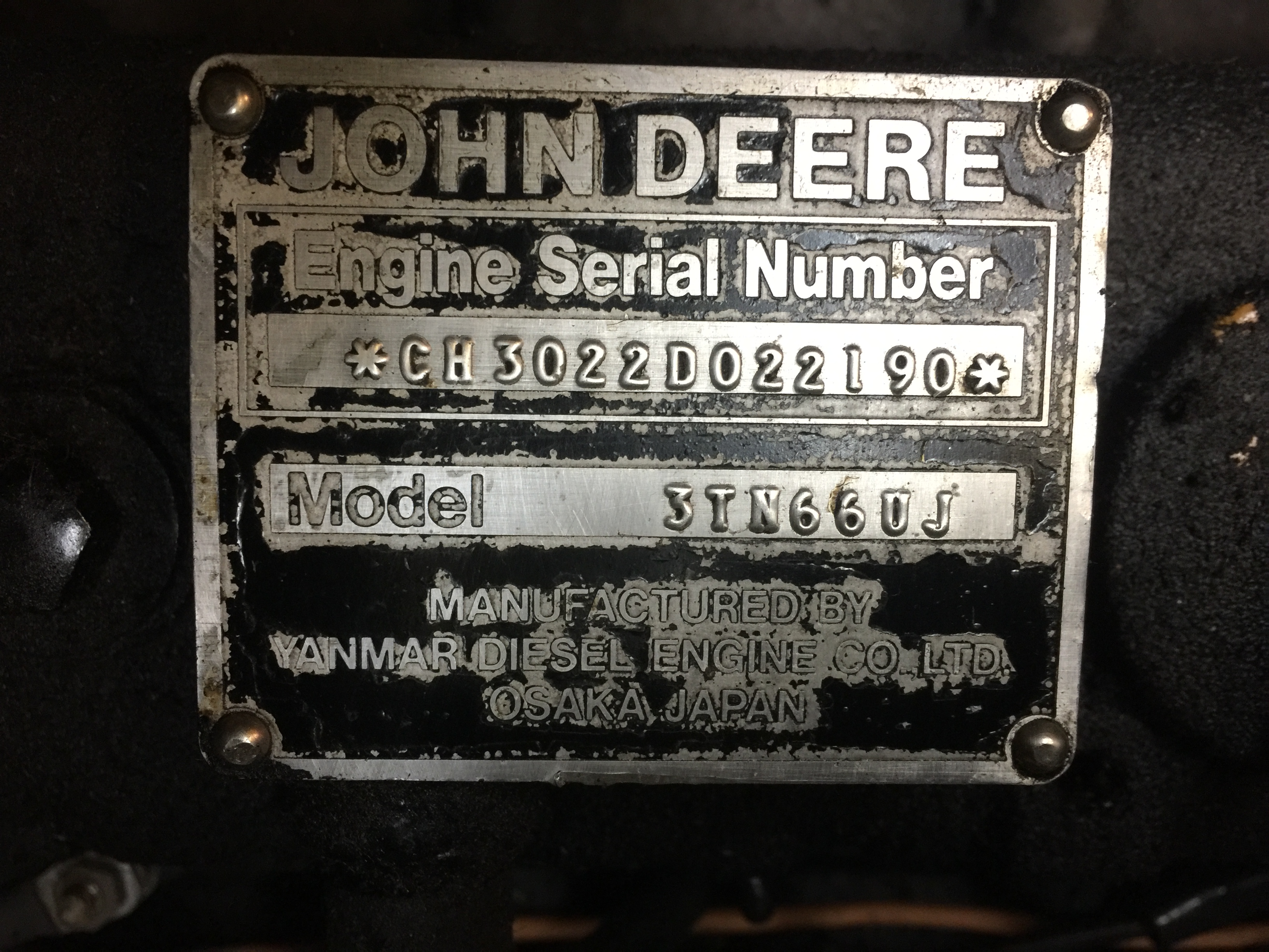

Hi Dave,
You'll see the 332 engine plate down below.
Tonight I did as you said I should not do, and fired up an inductive load. I had previously powered inductive loads with the 3 hp router, and I suppose the welder is a mix of resistive and inductive, and both of those ran fine, but I didn't load the router. So tonight I plugged in my 2 hp air compressor. This isn't a modern compressor where they have fudged the hp ratings. This guy is 30+ years old and is a real 2 hp. I chose this mostly because the compressor was closer to the tractor, easier to plug in and a heavier load on start. The first thing I noted was belt slippage. Then I applied some extra belt tension and the engine slowed down. After a bit, it managed to get the compressor going and from then on it didn't need the additional belt tension, and the engine ran fine cranking out 220 volts from the generator with the compressor finally running. Obviously, I need to go with another increase in pulley size on the generator. The 332 engine on my machine is running at 3220 RPM at full throttle with no load. TractorData.com says that it should be running at 3600 rpm at full throttle. A 6 inch pulley should spin the generator at 3750 if the engine is running at 3220, so this sounds like the next step, and if my torque curve is like the one you posted earlier, then this will be above the peak like we want.
Now I have to find a 6" pulley with a 1" bore.

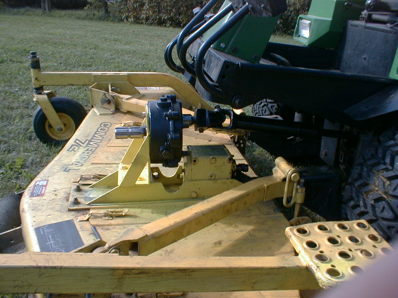

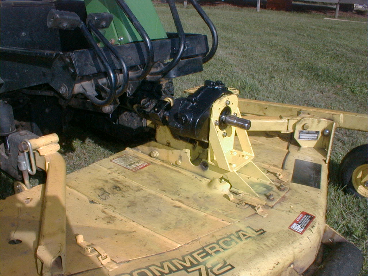

   / 10Kw generator powered by JD332 garden tractor #35
No idea of the exact engine rpm. I would estimate 2/3rds throttle. I set it for 60 Hz based on a Kill-O-Watt meter plugged into the 120v generator outlet. The gearbox can ride full time on the mower, I just have to reconnect the drive shaft. Note that the WinPower runs in the opposite direction as a result of this hookup, but there is no consequence as far as the output is concerned.
I generally take the gearbox off because its very heavy and puts a lot of downforce on the deck. I leave the mounting bracket there full time, though.PIC00076.JPGPIC00077.JPG
