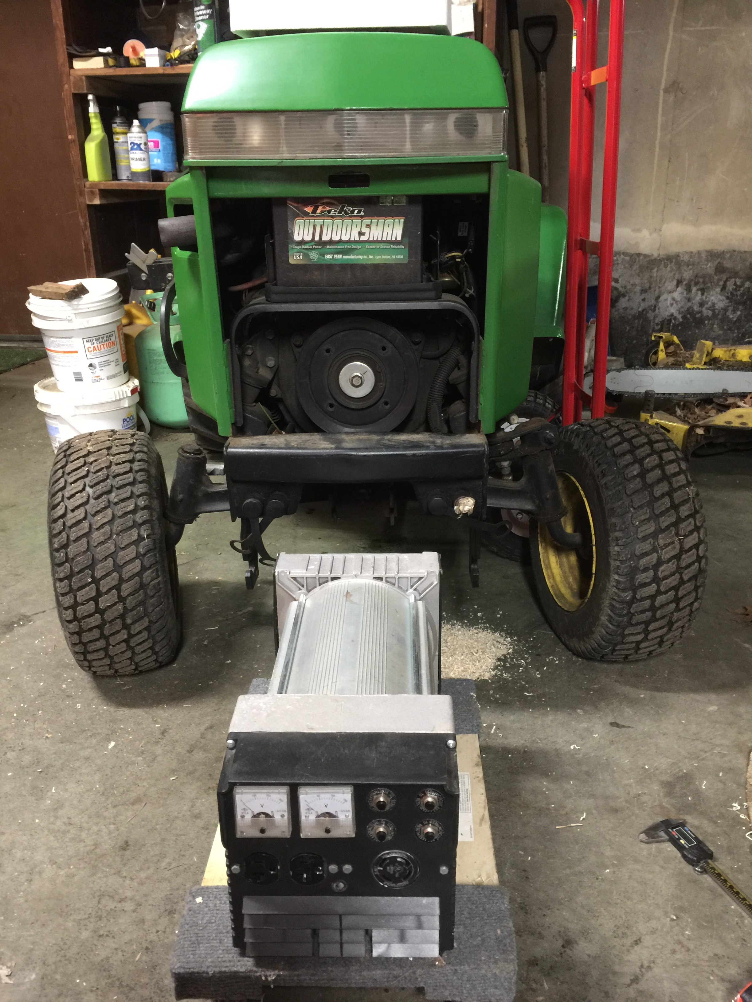

I figured I'd post some progress on this generator project I have going. I picked up one of these 10Kw generator heads from Harbor Freight a few years ago in order to build what I'm now finally working on.
Here's the generator itself. Somebody has said that this isn't really a generator, but it's an alternator. I'm not sure of the distinction, but it does generate electrical power, so I'm going to loosely refer to it as a generator.
Generator Head - 1, Watts Max, Belt Driven
It has been my plan to mount this to the front of my diesel JD332 garden tractor and run the generator with a belt up to the tractor's PTO pulley. Up on the tractor, the output pulley is 7" in diameter.
So I'll post some photos I took as I was putting thought into how to build a mounting bracket. You'll see the wood mockup pulley I cranked out on the lathe just to check for clearances for the belt, etc.
It's pretty amazing how nicely this thing tucks in under the PTO pulley.
   / 10Kw generator powered by JD332 garden tractor
#2
Here's a pic showing the mounting bracket that carries the generator head. Considering that this is an experimental prototype, I figured I'd build it using available materials. I have a lot of oak lumber laying around, so that served as the primary mounting bracket. The generator sits on a glued-up OAK panel that's hinged on the end opposite the pulley. The belt tension right now is limited to the weight of the generator head. I need to build a tensioning bracket with a screw or something to get better control on the belt.
To date, I have fired it up twice now. The first couple times I had a 3" pulley on the generator, so to get 3600 RPM on the generator, I had to run the tractor throttle at just a little over idle. I think that's a bit too slow for the engine. Still, with this configuration, I was able to run a 3 HP wood router with no issues at all. I was also able to run my 120volt wire-feed welder off it. If I ran the router and the welder at the same time, I noticed a significant drop off in voltage. I'm guessing that the belt is slipping on the little 3" pulley. So a 4" pulley is the next thing to try.
Many people who have driven these generators with a belt use two-slot pulleys. The engine only has one belt slot on the pulley up there, so I'll have to get by with one belt.
Here's the pic:

cool project. was the router or welder under load? to get the 10kw you will need all 16 horsepower. for any real use i would want it running at at least 3/4 throttle.
   / 10Kw generator powered by JD332 garden tractor #4
To get any kind of continuous 10,000 load, you will need close to 20HP...
Running those engines slow, makes voltage recovery slooooow to react, and that is very hard on most things electrical, like motors...

true, but you can pick the pulley size to put the engine throttle where you want it and get the 3600 rpm at the generator.
   / 10Kw generator powered by JD332 garden tractor #7
The PTO on your 332 is rated for 3600 RPM, so on the Gen head you'll want a pulley the same size as the tractor's if you ever hope to get near full electrical power.
