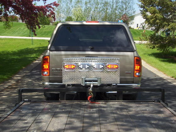

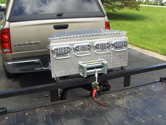

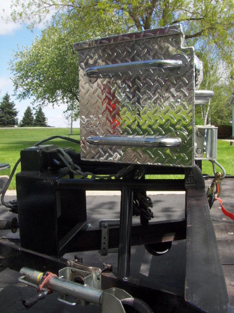

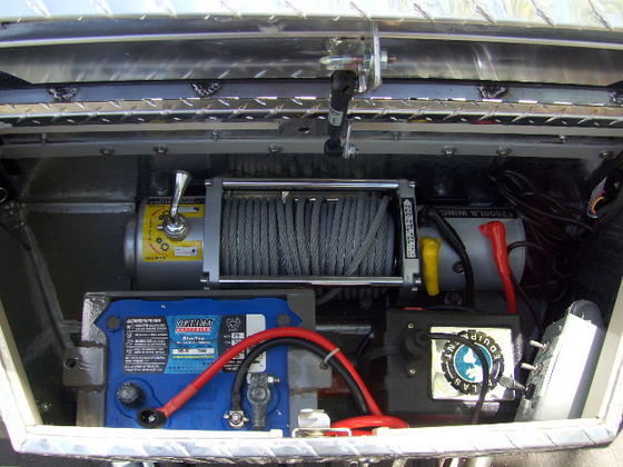

Here's what I made for my trailer. The box is attached to a 2" draw bar so I can move the winch to my truck receiver, or just remove it altogether.

/ 10K winch on trailer questions #11
Nice job! I was going to suggest a tool box arrangement, but you beat me to it with one on steroids! :D
+1 for battery on trailer (just remember to keep it charged).
/ 10K winch on trailer questions #12
It's guys like you that make the rest of us look mediocre.
Nice build. I especially like the lights. I've been debating about adding work lights to my trailer somehow. I now know how to do it.

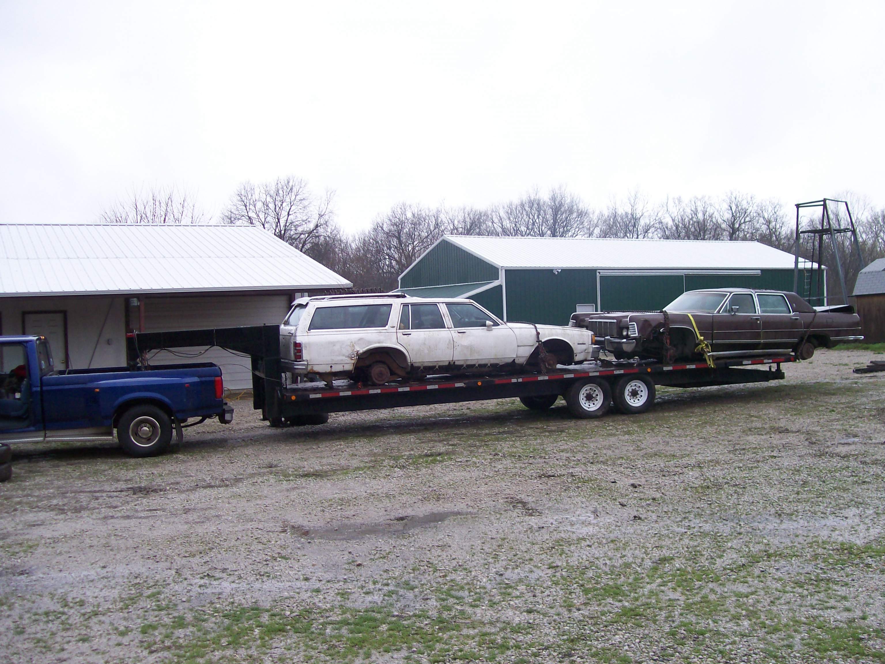

Only a few hundred times some didn't even have wheels 8K ramsey to the truck bat. On larger loads I use a doubler block.
