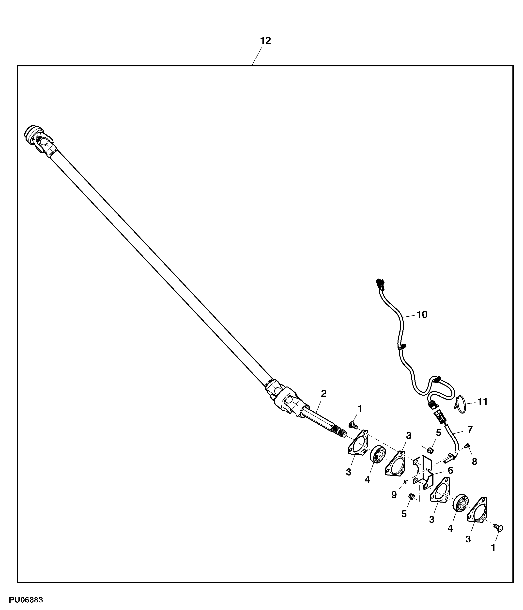

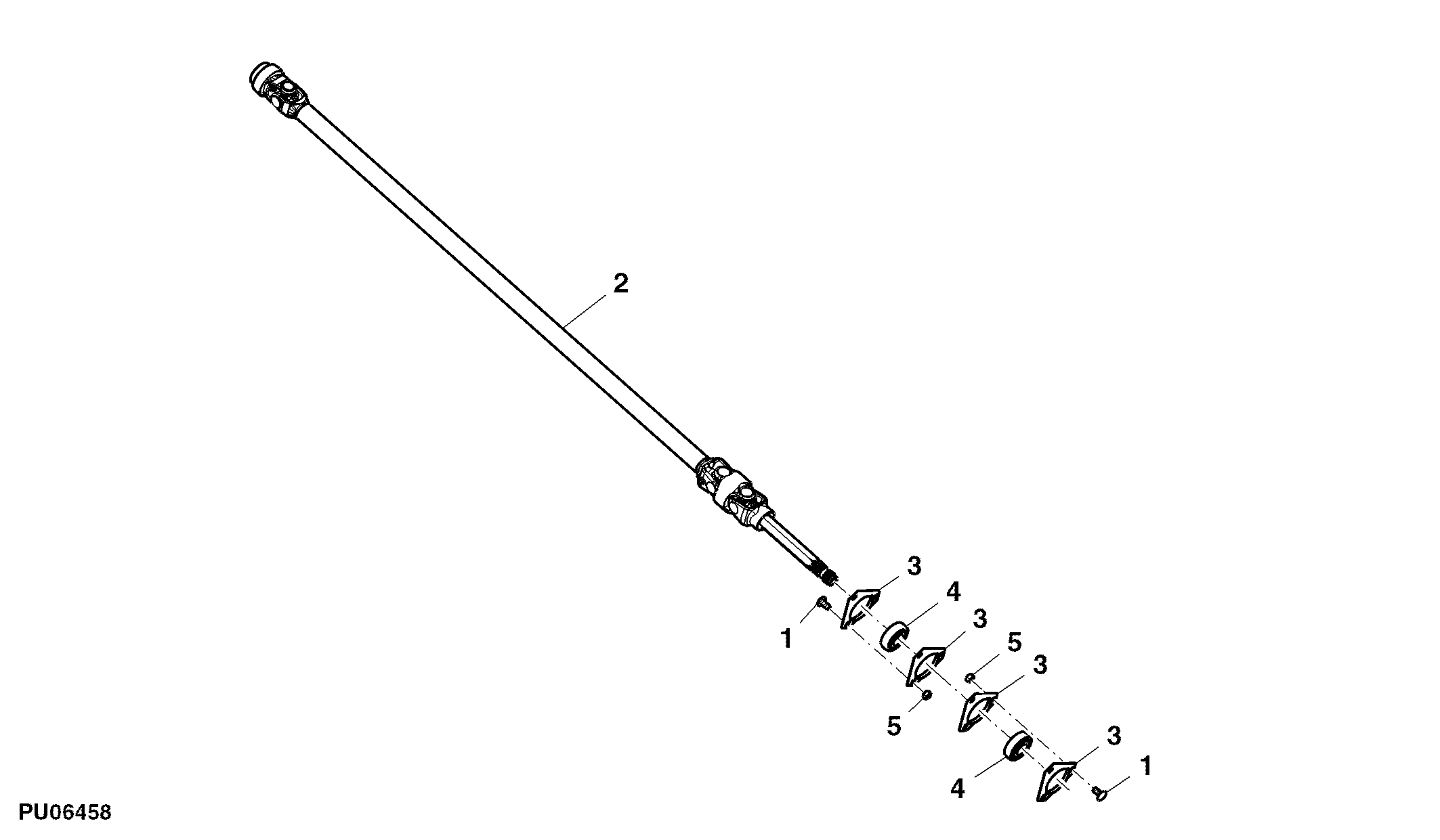

So JT, what is your serial number? This diagram is for 210001 - 310000, that should be the ones that have the RIO (including the 1025r's) as they first ones did not have it.
Here is the proper front PTO kit that had the sensor I mentioned (I mis-spoke when I said it was the hitch, sorry)
Front PTO (210001 - 310000)

My bet is you have this front PTO without the sensor, and your serial number falls in the range I posted above:

The service manager did stop at the house to take a look. Thanks to diagrams supplied by kennyd I was able to determine it does have the correct shaft assembly with the sensor. The service gent took a quick look at the wiring and it appears to be hooked up correctly. Since there is no adjustment to the sensor location, he's going to order another one. Hopefully, this will be all it takes.
kennyd, I'm assuming the serial number range you've given are the last 6 digits of the full number. If that assumption is correct, than I should be OK. The machines I have are 222913 and 222594 ... not sure which is which but both in the range you listed.

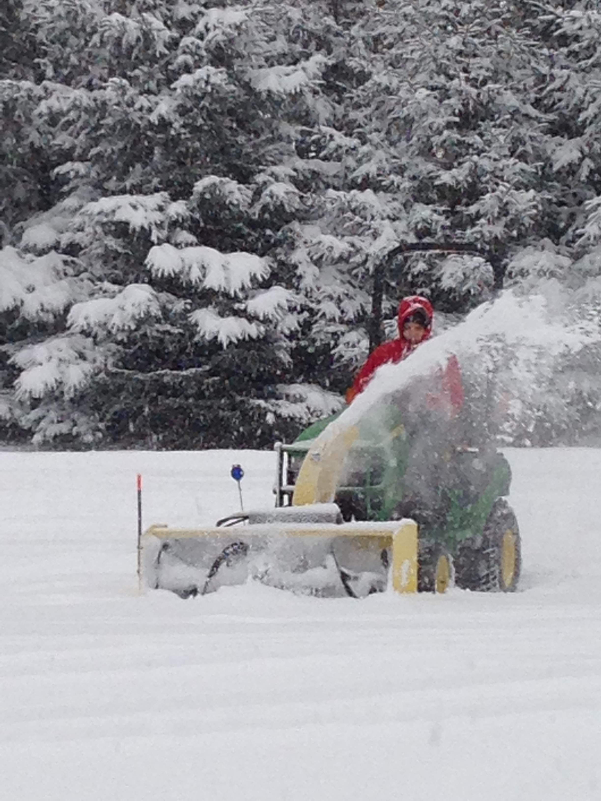

There's no adjustment to the sensor location, but the gap spacing appeared quite sensitive to me. I spent a fair amount of time ensuring the gap I set was accurate - and the thing is hard to adjust assembled too.
I put it on app. 2 weeks ago, & mine works fine (can reverse w/o snowblower or engine cutting out).
