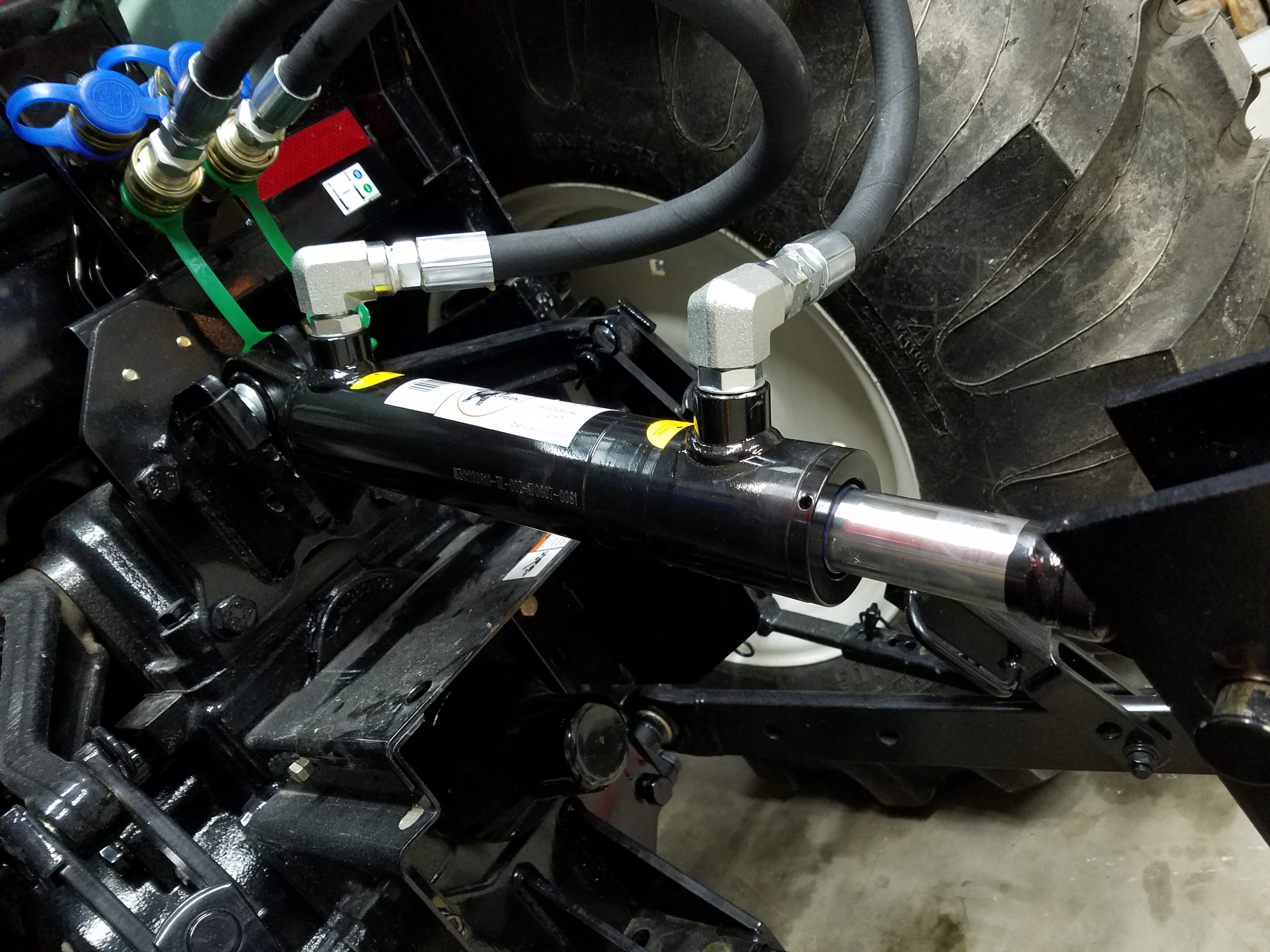

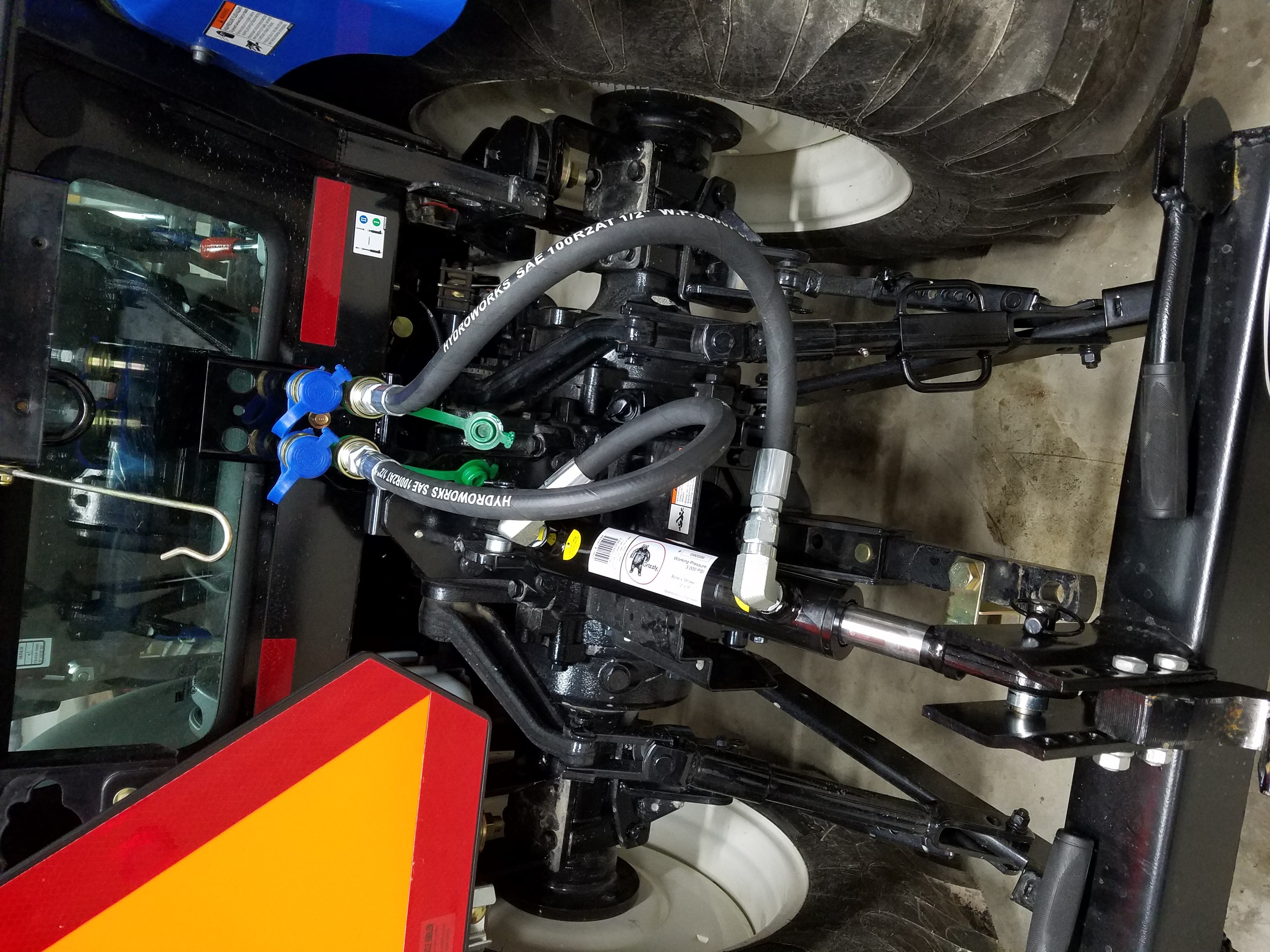

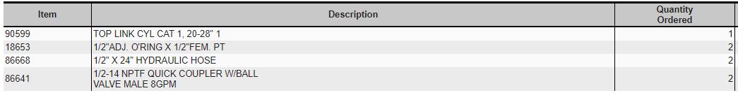

Thanks to everyone for the advice. The parts arrived and the install was straight forward. There is a restriction orifice built into the link so adding one is unnecessary. The range is great and movement is slow and steady. I attached the parts list below. $181.29 shipped.
View attachment 535055View attachment 535053View attachment 535054
Thanks for the pics and parts list. Ordered that verbatim and installed it yesterday. I've never had a hydraulic top link before, so I'm probably showing my noob-ness, but what do you do with it when you're not using it or have it hooked to an implement? My stock one would flip up and hang on the hanger. This new one is too heavy and won't quite go vertical (due to the hoses) to snap into the holder. Do you just let it hang?
Also, my remote is neutral in the middle, and then a forward/backward position. It rockets in either direction. If careful, I can inch it in/out with the lever, but it's very finicky.

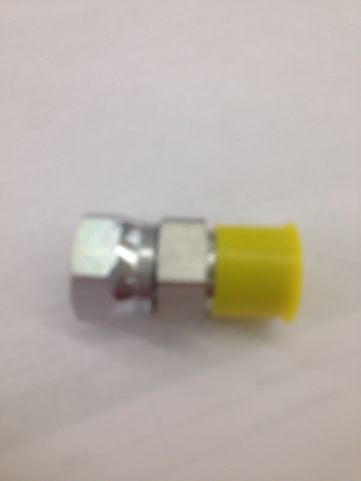

A little more info. I called a friend who works at a local TSC and she was able to locate some identifiers for their 1/2" NPT Swivel flow restrictor fitting:
The SKU No. is 1256783.
The item number is BMP-8FPXR-TSC
She was not able to find any data on the size of the orifice, but she took three views of the fitting on her cell phone camera and sent them to me. They are a little out of focus, but still helpful, so I've attached them below.
I'm pretty sure the orifice is about 1/32. I'm using one of these in their 3/8" NPT size with 3/8" hoses on a 3" x 8" Grizzly cylinder that I've added to my 84" Woods snow blade to allow me to offset it hydraulically. It allows adjustment quite slowly, which is just what I wanted. It should work well on your 2" toplink cylinder.
BTW, for anyone reading this who wants the 3/8" size, here is the TSC identifying info for that:
The SKU No. is 1256782.
The item number is SMP-6FPXR-TSC
These fittings can't be found on the TSC website. In fact, the only hydraulic fitting shown there at all, after multiple searches, is a Pioneer poppet-style quick connect. :shocked:
I would definitely call ahead to your local TSC to make sure they actually have the fitting on the shelf before you make the trip into town. :)
