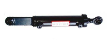

Thanks to everyone for the advice. The parts arrived and the install was straight forward. There is a restriction orifice built into the link so adding one is unnecessary. The range is great and movement is slow and steady. I attached the parts list below. $181.29 shipped.

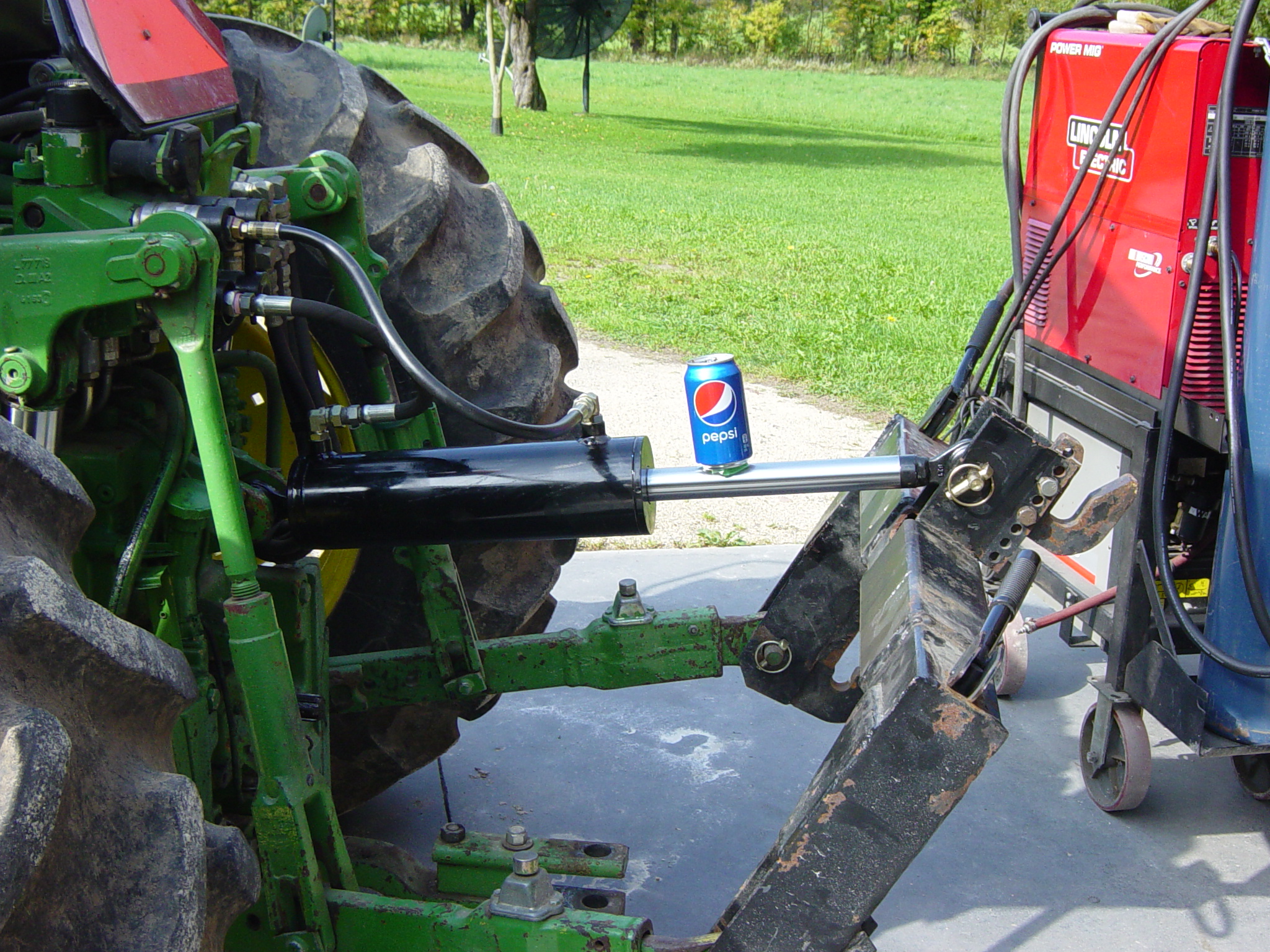

Gents,
Any chance of a picture of some sidelinks the way you folks built them? Winter is coming and ya never know but I might need a little tractor project to give me an excuse to stay warm over a welder.
/ $100 Hydraulic Top Link #67
Gents,
Click on my DIY remotes link in my signature. Post #6 has pics of my top and sidelink
/ $100 Hydraulic Top Link #68
Thank you Sir! #7 also has a shot. Not exactly sure what the top of the cyl is connected to on the tractor.
