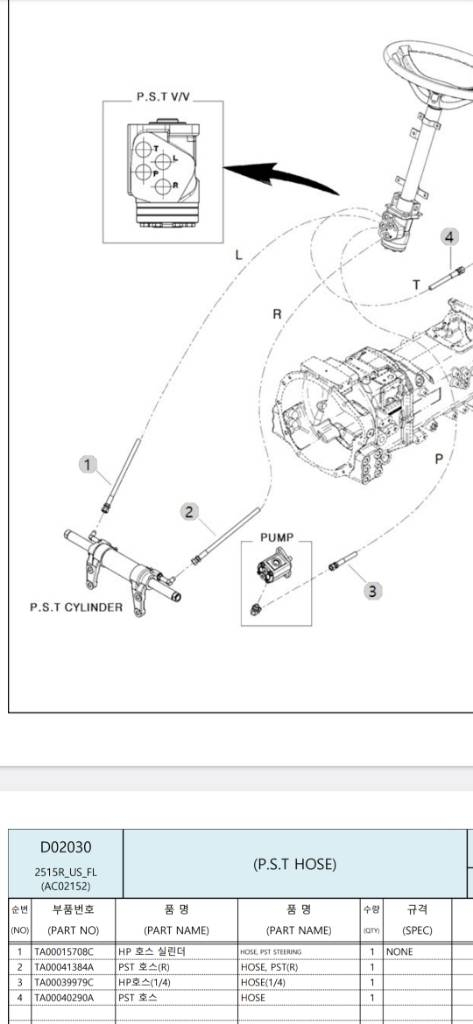

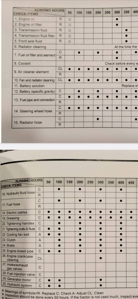

There are some items on the 100 hour maintenance checklist for my 2515H that I don't understand. Does anyone know what the engine breed pipe is? I'm supposed to check it. Also, what is the steering wheel hose? Is it some kind of power steering fluid hose?

Not sure what it is referencing, but besides the major 50h service chassis lube and general check hoses, nuts and bolts and fluids goes as far as maintenance schedule in user manual should be sufficient.

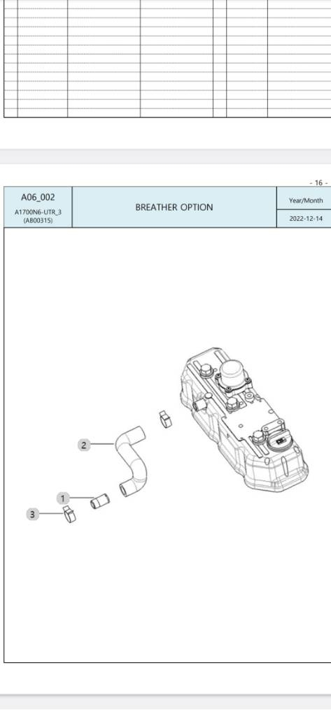

Does it refer to a crankcase breather tube? Just checking it isn't blocked up?

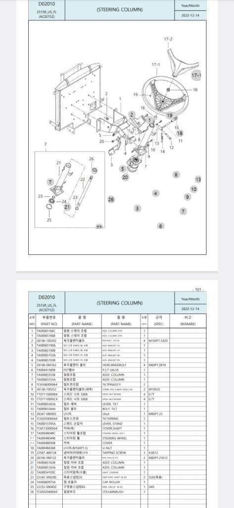

See parts diagram below

My assumption for steer wheel pipe is just check your power steering hydralic lines.

As for the "breed" pipe, it's probably a misprint but I'm not sure what it should be.
/ 100 hour maintenance #10
It's the crankcase breather. Just make sure the tube/pipe isn't clogged by debris.
