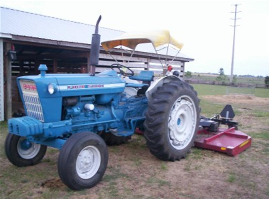

'Big enough' is all you need.
here's my 1975 ford 5000 and a 10' 3pt mower. She mows like a dream. i have (4) 80# pillow weights on her and (2) 50' suitcase weights as well.
soundguy

When you're on a schedule like mine (2 younger kids in 4 sports of which 2 I coach, 2 businesses, and now possibly 15-20 acres of pasture to cut and a small farm to maintain) "big enough" is too small.
I want to get the mowing done fast. I have other things to do than sit on a tractor all weekend pulling a "big enough" mower.
