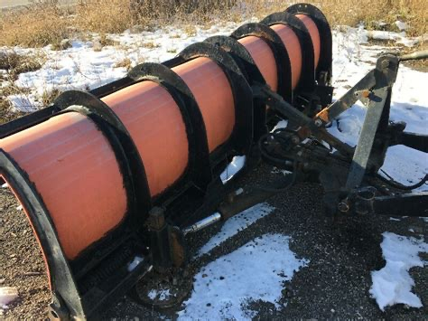

I think the upper 3 point link will have to be rigid piece of steel, not a chain.
The front point has the float option, which would allow it to float over bumps. Also, the moldboard trips.
If I used a chain, I would not be able to “scrape”.
This is what I am trying to achieve-on a more limited budget. Note this plow is trip-edge, mine it moldboard trip.

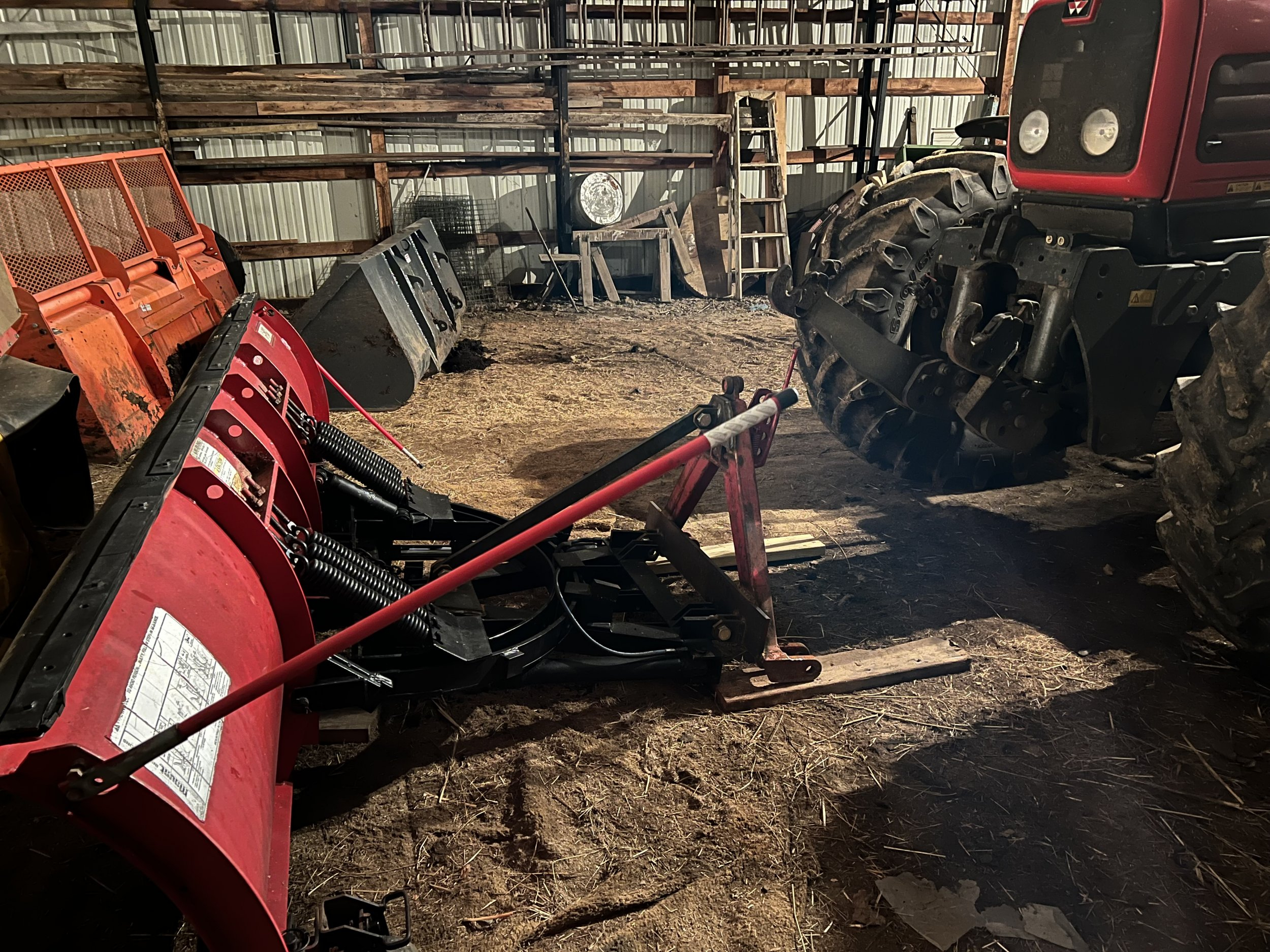

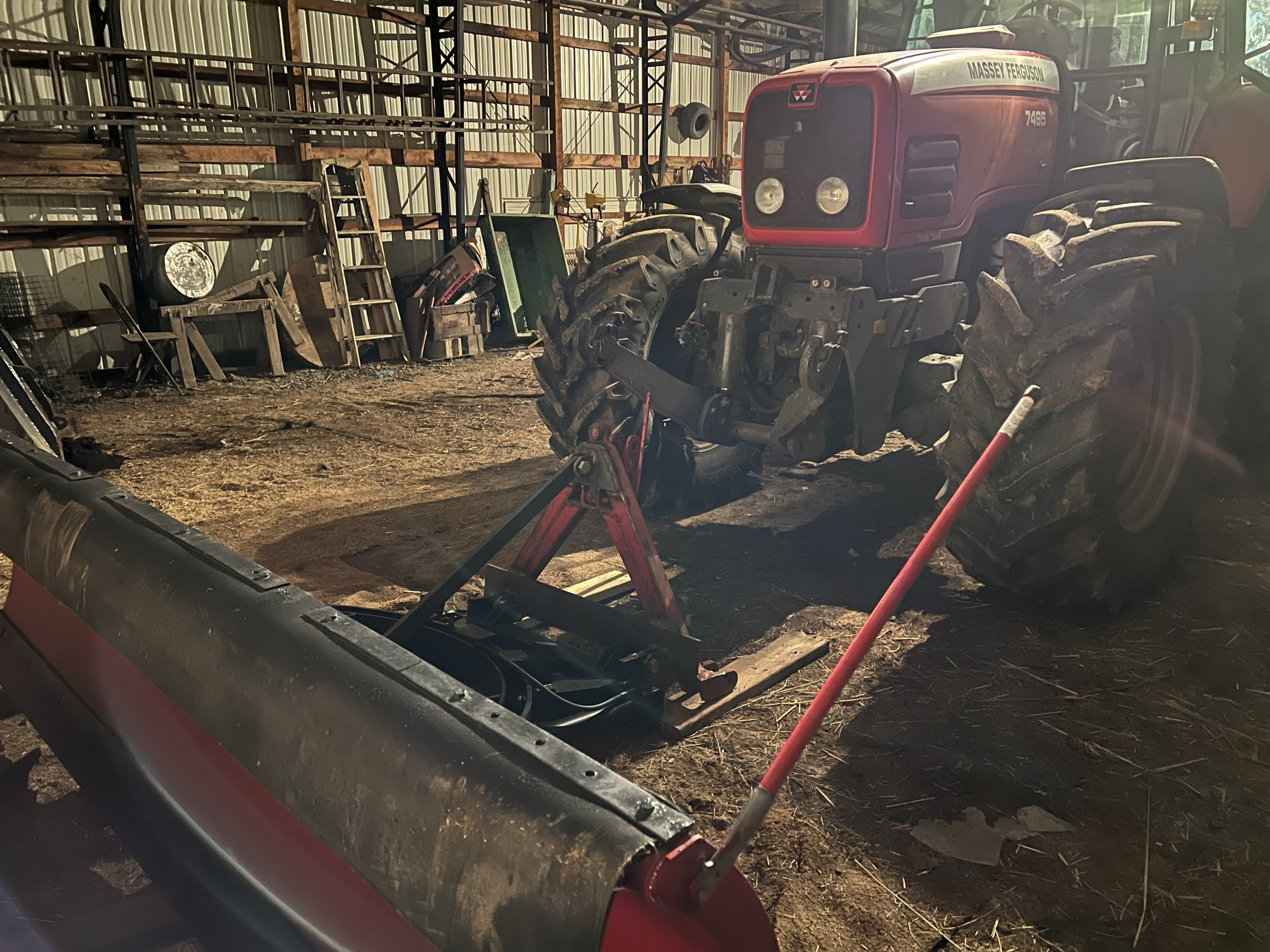

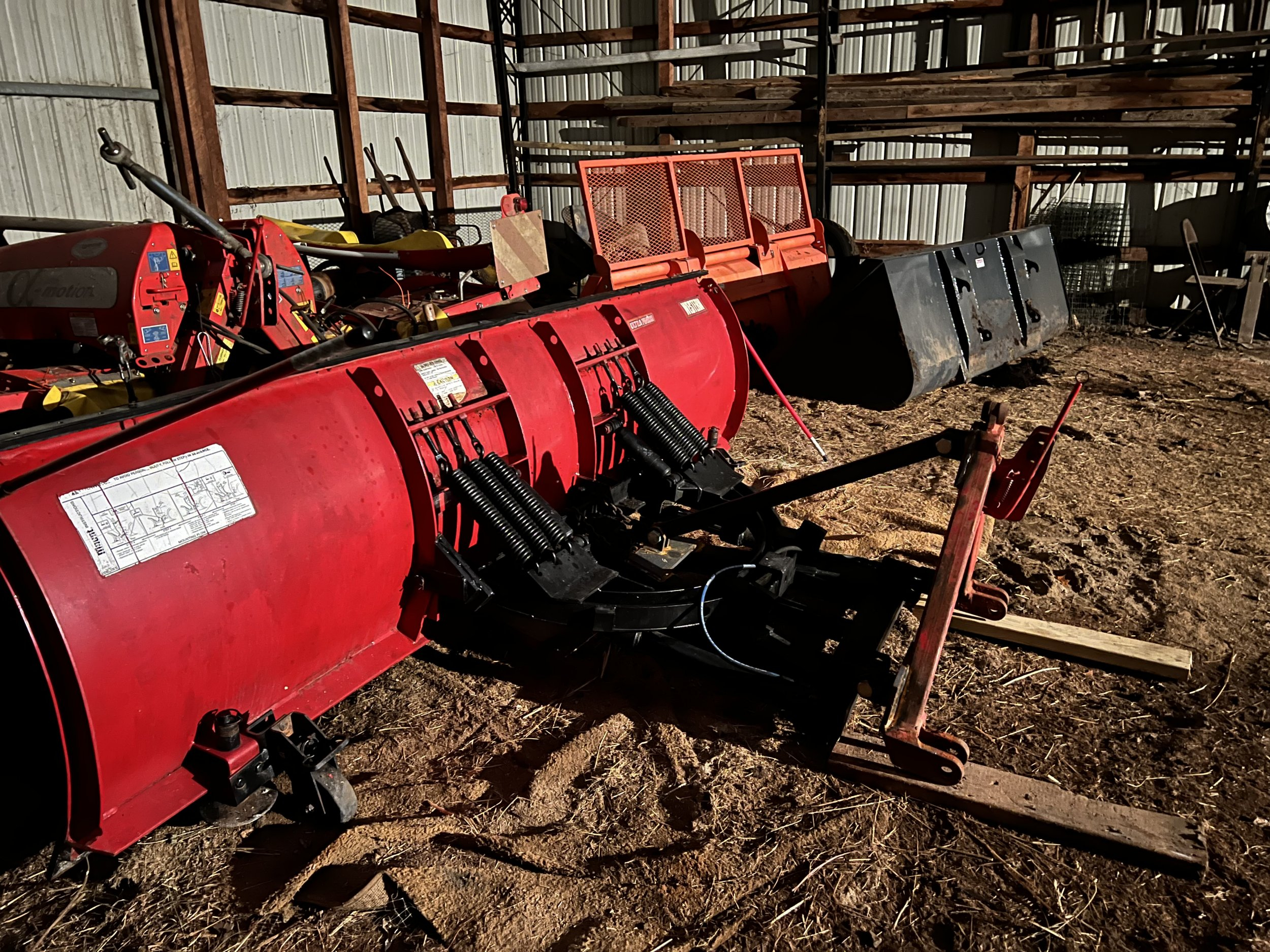

So I finished up a bit more work on the plow. Bolted on the new cutting edge and drilled out a piece of 3/4” to make the top link “rigid”.
Not sure if this will work. I think I might end-up bending the top link? Maybe not. The moldboard trips, but :unsure:
Sorry the pictures are crappy. It was dusk and the lights weren’t on.
   / 10’ Western Heavyweight conversion to Tractor front 3 point hitch ? #39
I think you're probably safe but even a 1/4 or 3/8 x 2" flat welded on the 3/4 to make a "T" would make it very unlikely to bend and as you say there's the trip action...
Once there's a little kink in the straight line of the top link it might get worse, at least bend more with a lesser impact.
The more I think about it the more I'd suggest reinforcing it because even with the trip there's a momentary impact that's trying to lift the 3 point hitch and all the linkage. All going through that t/l.👍
#40
I’ve seen quite a few home made front hook-ups like mine with just straight flat stock that weren’t bent, but maybe I should have done a “T”. I was thinking most of the force is down low and will transfer energy through the lower links.
