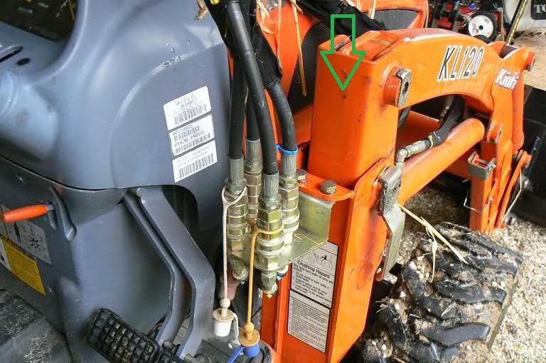

Do you use the hydraulic top link with the backhoe in place? (seems unusual) If not, a single diverter valve for the grapple totally solves your problem. Like I said I prefer to divert the dump/curl circuit for that. It frees up an operating hand and everything is contained on the loader frame.

Great - all you need is what I posted in the first paragraph of my first post. (post #4 in this thread)
Look at pdf "installation guide" in the second link. Scroll down to "step 3 - hydraulic plumbing." The $110 valve I posted in the first link is just like the valve in those instructions. You probably want to attach it to the loader frame where I indicate in the attached picture. You take the quick-connects off the curl hoses and attach those hoses directly to the solenoid valve. Buy 2 short hoses to run from the solenoid valve to the quick-connects, and run the grapple hoses to the solenoid valve just like the diagram. When you want to remove the loader, you just remove the electrical connector from the top of the solenoid (it's included with the valve) and detach the hoses as usual. Unlike the kit in the pdf you have to buy your own momentary push-button switch and wire. Instead of a bracket I just tapped two 1/4-20 holes in the loader frame to mount the valve. The valve doesn't come with any instructions. If you go this route let me know and I can put together the simple wiring diagram.
Now your grapple is totally independent of the rear remote and you can operate the grapple with your joystick hand. The small disadvantage of this setup is that you can't operate the curl and grapple cylinders simultaneously. That has not been an issue for me. You do get full rate control of the grapple through the curl valve.

Here is that link again with instructions for the solenoid diverter valve:
http://www.hydraulicstore.com/images/pdf/Trausch_Dynamics_Selectplus.pdf
It works for me from multiple computers.You may have a ribbon pop up asking permission to open the pdf file. It's just a little too big for me to attach directly to this post. If you still can't open it you can pm me with your email and I'll shoot a copy to you.
You don't need to worry about power beyond - that is for installing a full function remote valve or running your backhoe as a full remote valve. All you need is the diverter to control your grapple and you can run the BH or toplink from your existing rear remote valve.
