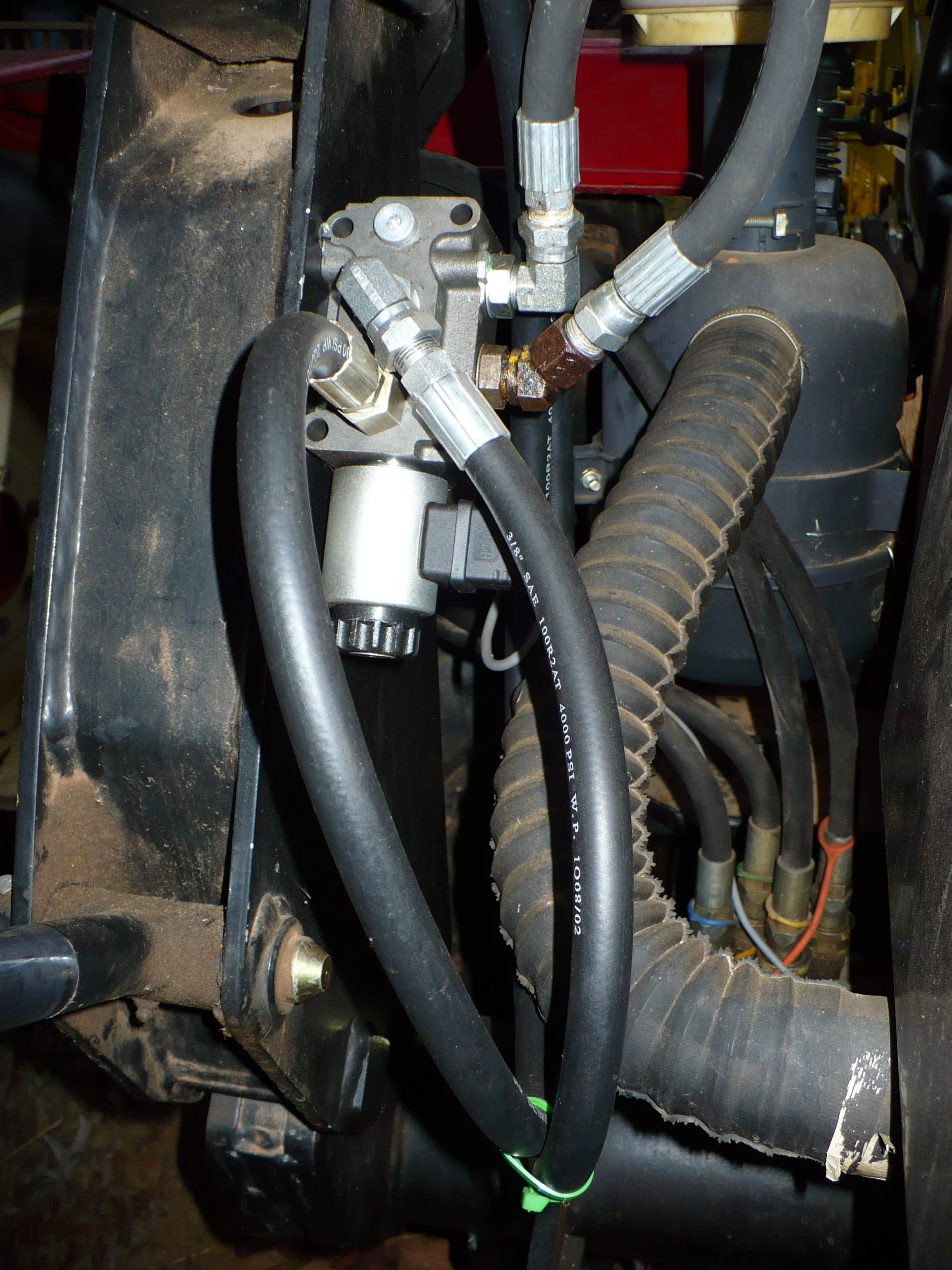

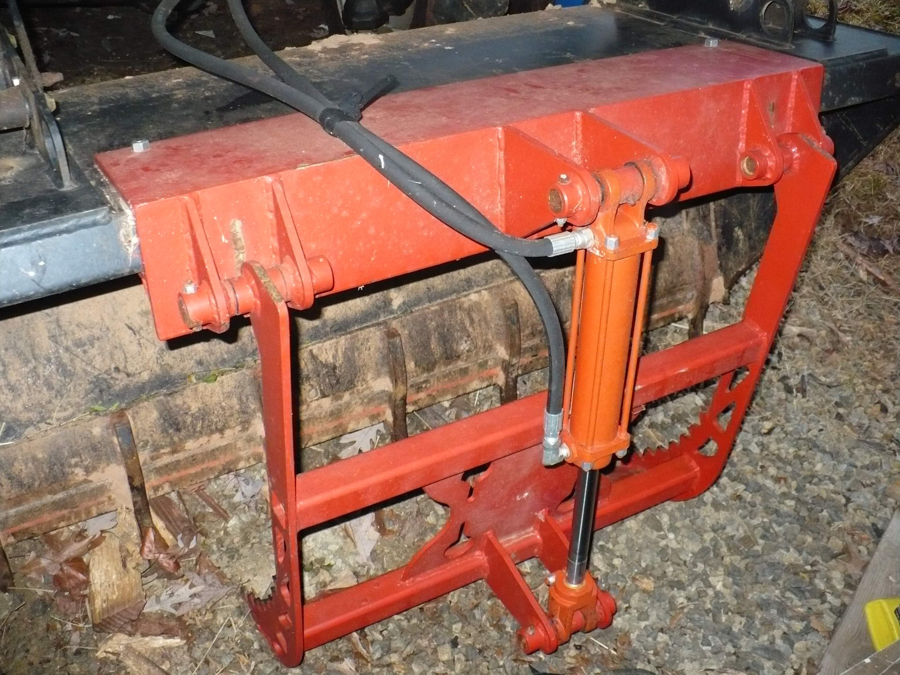

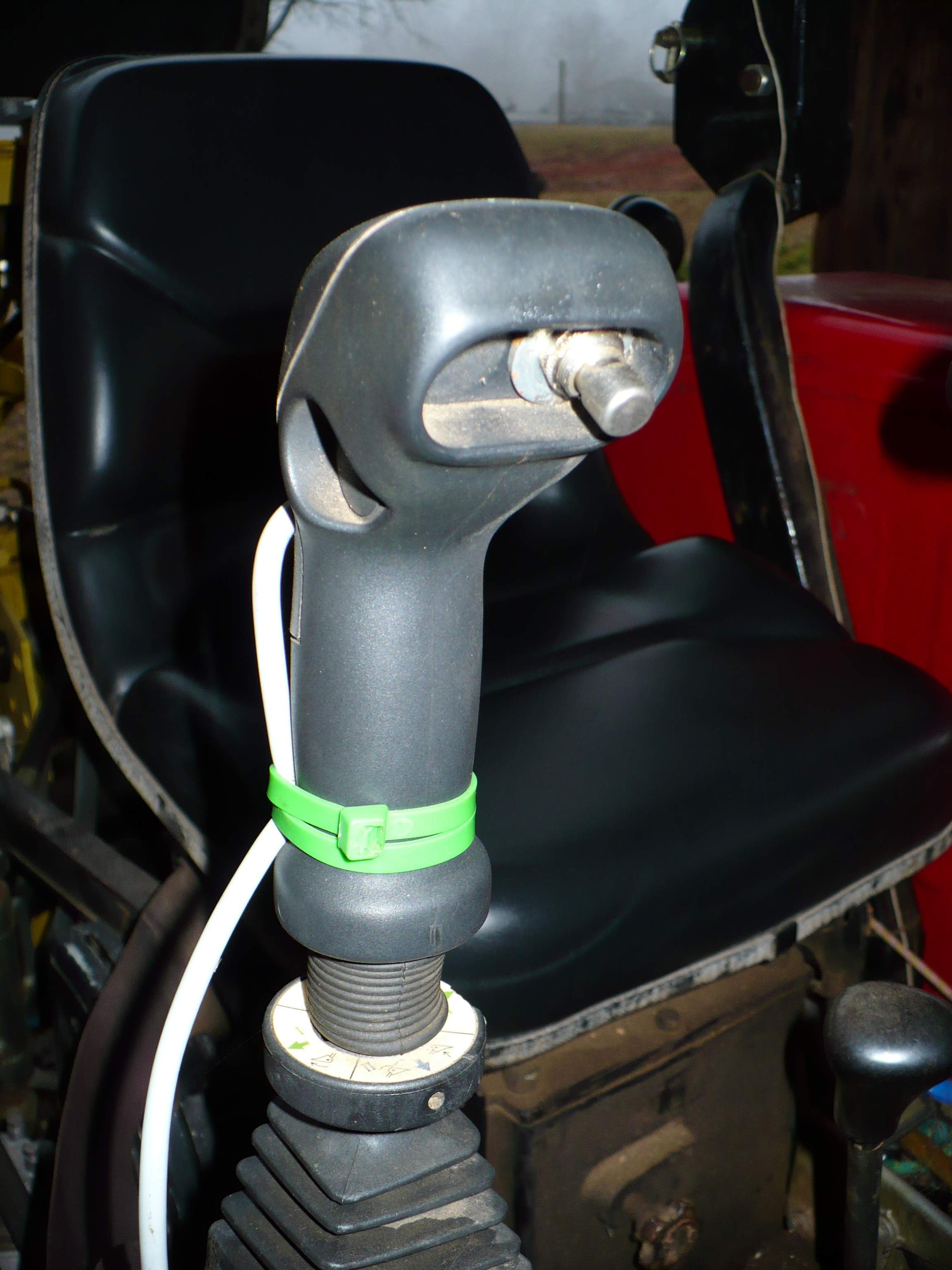

Is the "thumb" on the loader? We usually call that a grapple. I run my grapple from this diverter valve on the bucket dump circuit. Solenoid Valves 220-934 Detailed Information
The valve doesn't look like the picture but it just needs a switch to mount on your joystick and some 45 degree adapters to attach the hoses to the valves. (90 degree adapters will not thread in because the ports are close together) When you push the button the dump valve operates the grapple. This manual shows how it's done: http://www.hydraulicstore.com/images/pdf/Trausch_Dynamics_Selectplus.pdf

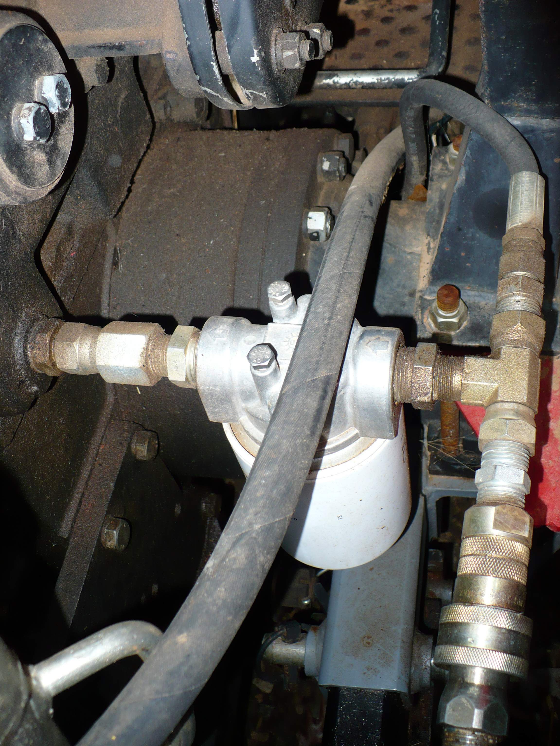

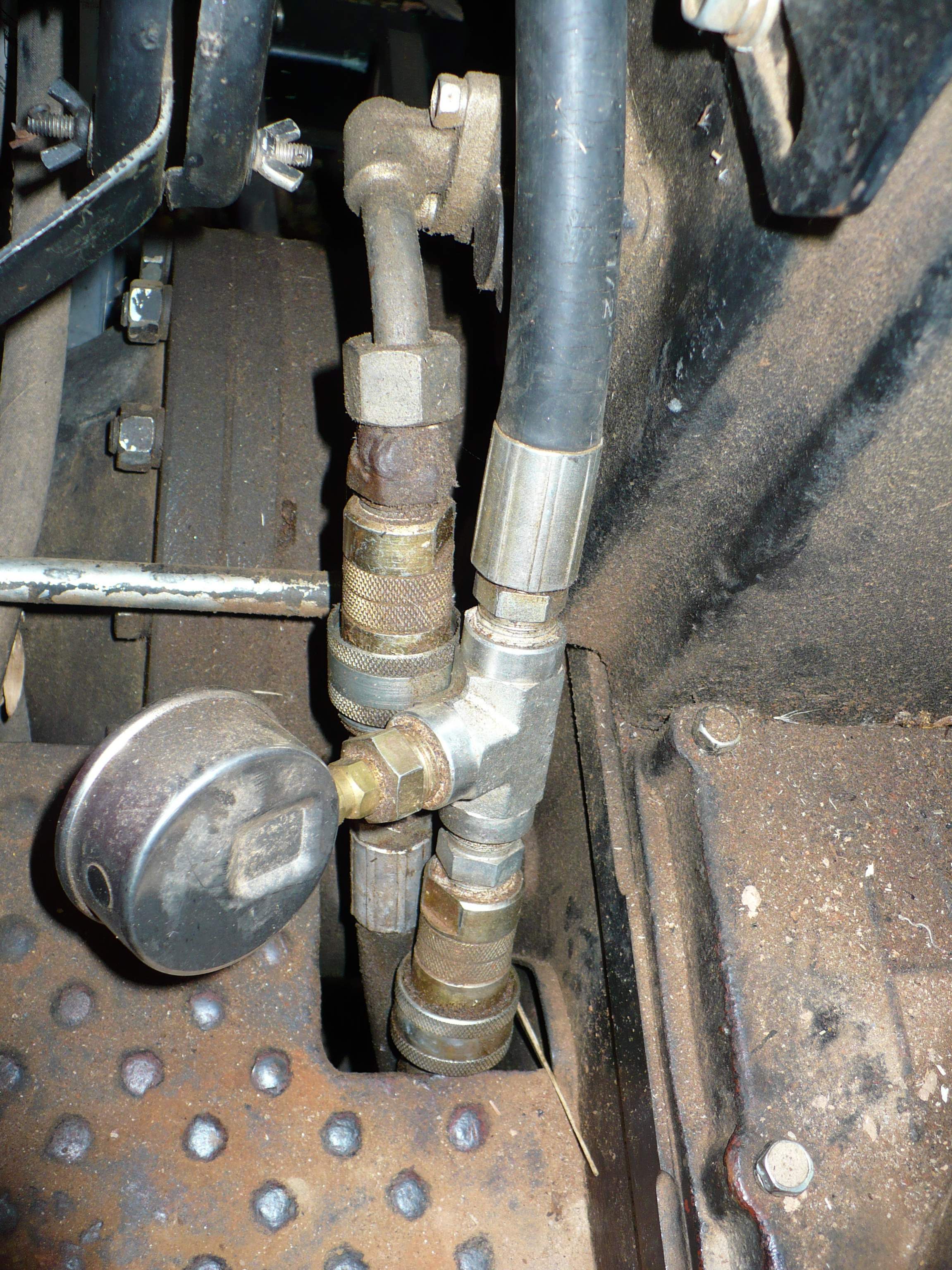

Set up a power beyond loop for the BH. The BH valve may need an adapter to separate the power beyond flow from the return flow. The power beyond loop is really a set of quick-connects in the hydraulic line that supplies the 3ph valve. With the engine off you divert that flow through the backhoe valve. You also need to add a quick-connect to the tank return for the BH valve return flow.
Run the hydraulic top link (or side link) from the rear remote.
Pics - 1. Bailey selector valve, 2. joystick button from NAPA installed in my existing handle, 3. grapple, 4. where I split my line for power beyond to the BH, 5. return quick-connect and low pressure filter.

Now I understand why you have to shift hoses. With a grapple, a diverter valve is plumbed into the curl circuit and the switch switches between the grapple and curl on the bucket.
If your FEL valve has PB, the I would plumb the grapple into the curl circuit.
I would then obtain a one or two spool valve with PB and install it as the remote valve , for things like T-N-T, BH, log splitter, or anything else that you might use.
The way you would plumb the remote would be from FEL-PB out to the input of the remote valve, and the PB from the remote to 3 pt . The out hose from the remote would go to tank. Install QD in the work ports of the remote valve.
To operate BH, you bungee one of the spools to provide fluid to the BH.

Purchasing and installing a remote valve with PB would be ideal.
Redo the diverter valve, and install the remote valve.
Once the BH is plugged in, there will be no switching hoses and all cyl functions. will work
