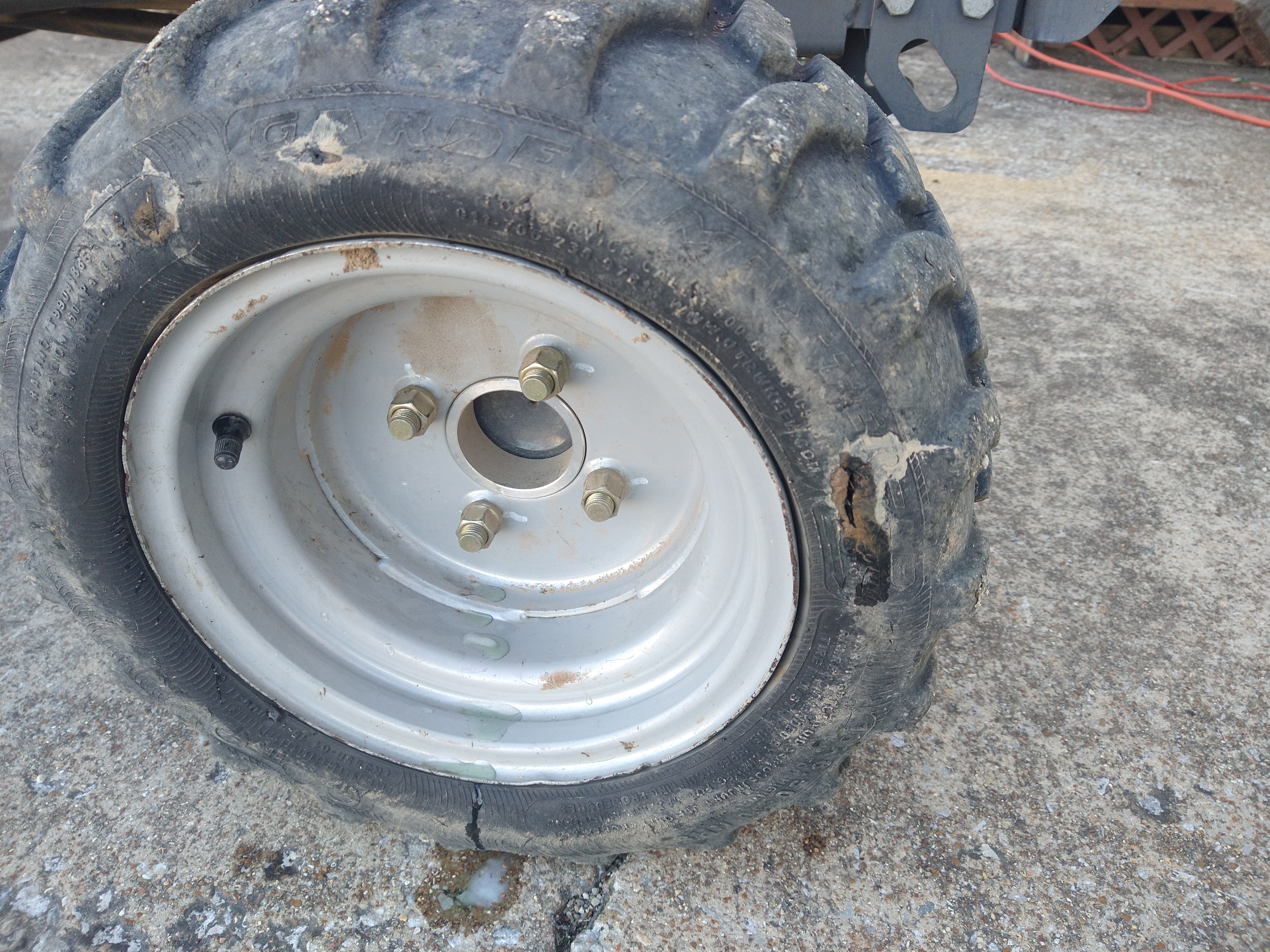

My daughter and son in law have a GC 1723EB and it seems to be a good little tractor. Since you added fluid to the tires I recommend you check them for what the ply rating is. They worked theirs pretty hard while building their barndominium. I assisted with some of the dirt work as well. I think the stock bar tires are truthfully just a garden tractor tire. 26-12.00-12 possibly? One blew like a balloon popped and of course fluid filled and all fluid was lost. They were 2 ply rating and they replaced with 4 ply. They they went through the same thing with the front tires. Those tires are fine if you rarely use it for more than a mower. They don't hold up when you start doing a lot of heavy loader work. The replacement tires have never gave a moments trouble. Something to keep in mind. Most probably won't work their tractor that hard.

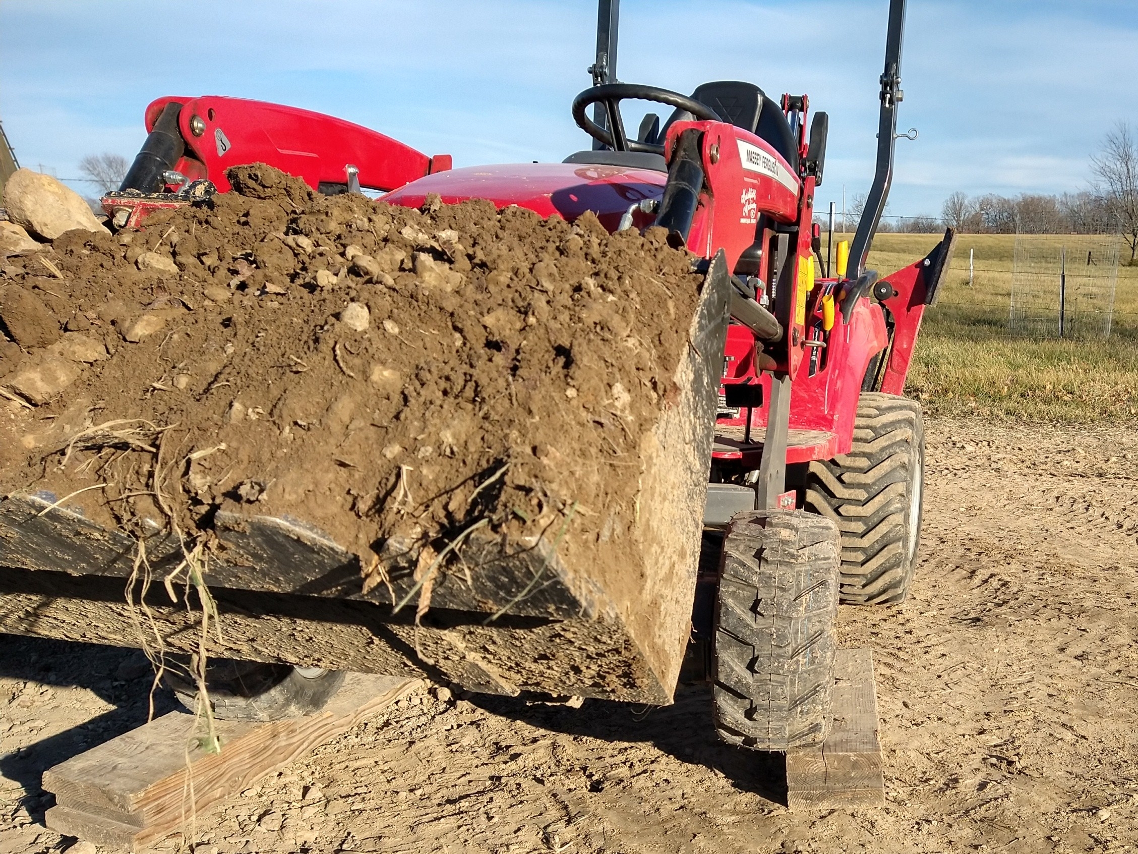

I work my GC 1725 MB ... Probably too hard according to some ... Came with 4 ply rated R4 tires front and back, got some sidewall cuts on the fronts from rocks, liquid filled ... Replaced with 8 ply rated R4's!
Over full load of slightly damp dirt and rocks, no squatting with only 1/3 of tire on board!

I was guessing at the 4 ply. I do know the original tires were 2 ply and not ready for any heavy work. They might be 8 ply as well. The originals were definitely 2 ply though. They have not had a moments problem with the new tires. I think had they anticipated the front would fail so quickly after the rear they would have put them all on at once. Photo attached of theirs. It's a slightly different tire. Not what is on it now but what they had to replace.
