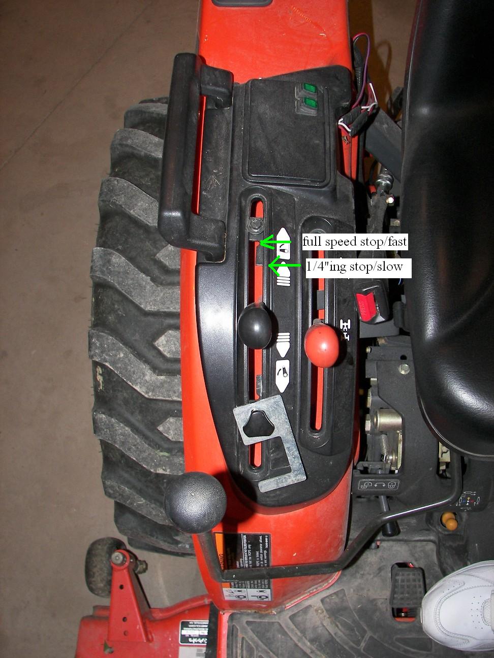

I recently bought my first Kubota--2009 B2320HSD. Since this machine was purchased used, I have no idea about the history.
I have participated in threads on 1/4" valve operation and although this type system is new to me, I understand how it is supposed to operate.
NOW---My owners manual states that this model, B2320HSD has the 1/4 inching valve, and mine DOES NOT!
The B2320DTN-1(narrow) has position control. The scale for the DTN lift, is numbered where mine only has arrows and two adjustable stops.
My B2320 definately has position control and I do not understand why:confused:
Could it be possible that the previous owner of this tractor made modification to the 1/4" system to make it position control:confused:

My B3200 is suppose to have 1/4 inching valve for the 3PH and I bought it new. I can't seem to make it work but I assume it is opperator error.
Anyone willing to tell me how it works?

The full range of travel control is between the stops on the control setting at the handle / lever. By default position, the handle / lever is positioned to the outter direction of the travel path of said lever. When you grab it to implement movement, one just moves it forward or back (up and down) without thinking about the lateral position. Thus the oversight of the feature.
Move the lever in (laterally) toward the driver and use that position and the normal range of motion (for up and down) for the 1/4" movement. Be patient as it is a bit slower in motion than the open position movement (default position).

There is also a good chance that the stops on the lever guide were not set properly from the factory. You will notice on the stops there are two 'steps', the one closer to the operator is for 1/4", the outer one moves the 3pt hitch at full speed. If you are pulling it against the inner stops and it doesn't move very slowly you need to loosen the little nut on the stops and move them closer until it does. When it is set properly you should be able to give the lever a quick 'bump' against the inner stops and it will only move a 1/4" at the lower link end. Also you can hold it against the inner stops and it will move slowly, or hold it against the outer portion of the stops and it will move quickly.

Hey guys there has a been a recent discussion about the 1/4"ing set up lately in another thread. Here is a link to it, go thru the whole thread because the are some other links in it about the set up.
http://www.tractorbynet.com/forums/kubota-owning-operating/180169-new-b2620-problems-2.html
I aslo included a quick picture of what is being mentioned about moving the 3pt handle out (away from driver) and around the 1/4"ing stop to move the 3pt faster.

Assuming everything is adjusted right, if you just hold it in the 1/4" position it will continue to move just very slowly(either up or down). If you bump it against the stop it will move a 1/4" at the lift arm. If it's not set right bumping it against the stop will move the lift arms 1-2" or more.

I am 64 years old and I have owned, no less, then twenty tractors! I think I know how a tractor lift system works.
First--My post is intended to possibly help someone that dislikes the QI system. Read my post again:thumbsup:
Second--It makes no difference if I pull the leaver to me or away because there are NO stops, other then the adjustable ones that have only ONE STEP.
Idling, or wide open, the lift works the same. I can raise the implement slow or rapid, 1/16" or 2" depending on how fast I move the leaver.
If you think I have QI ---Good for You---I have no problem with that:laughing:
/ 1/4" Valve Haters---Read This #20
Based on your description, you have the QI model. You can still be wrong even at age 64.
