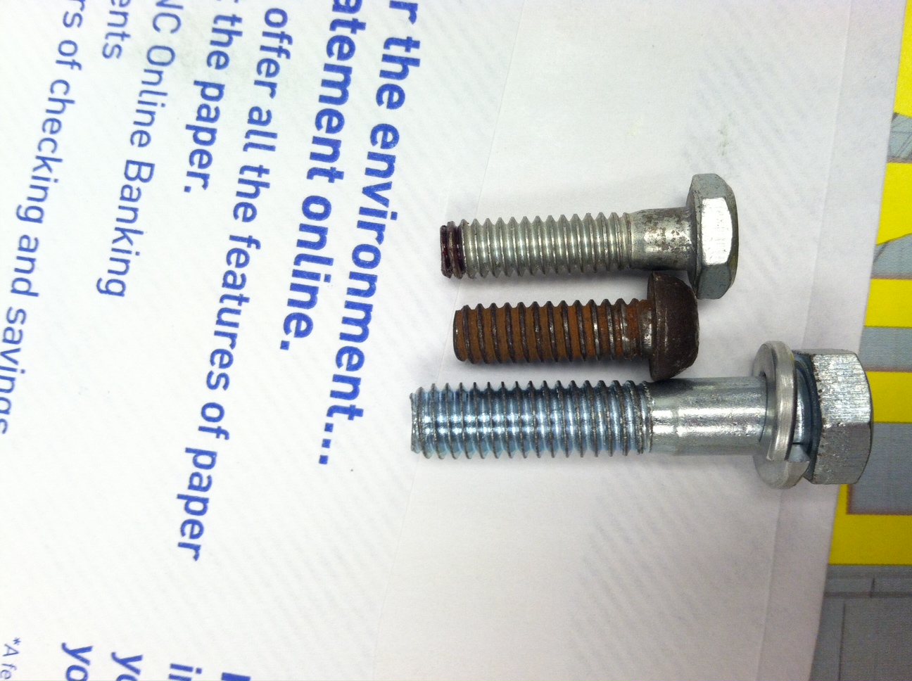

Here's a comparison - the old screw is in the middle, flanked by 1/4-20 and 5/16-18. The diameter across the threads measures right at .250 (I suspect that the screw was a little larger when new - note the threads are flattened somewhat from use), and 1/4-20 is smaller at .245". A 5/16 nut slips right over it.
If we rethreaded the holes with 1/4-20 I'm afraid it would result in a loose fit due to the smaller diameter. 5/16 would end up taking a lot of meat out of the nut plate but would probably work...then again there are about 50 holes to tap.

Oddball indeed.
Try this,
With a set of calipers, measure the root of the threads on that screw (minimum diameter...NOT on the threads, but in the valleys) and compair that to the 5/16.
Its NOT metric. 18TPI would be ~1.41mm thread pitch, and standard jumps from 1.25 to 1.50

Ok -
1/4-20 .207
1/4-18 .213
5/16-18 .263"
/ 1/4-18 thread machine screw? #11
Personally, I would just tap them out to 5/16 then. You are only talking about .050" of material. Thats only .025 per side...Thats not much loss of material.

Good suggestion. The mystery of it is what bugs me...who in the world was making 1/4-18 fasteners in the 1950's? Hasn't everything been UNF since the 30's? I have seen unique threads on early American cars, but this is a relatively "new" window compared to the cars.

Dumb question but are self tapping screws? Possible that someone like CamCar made them special per customers request just to have the "repair" / replacement business. I know CamCar made a lot of specialty screw products and I am sure other companies did also.
/ 1/4-18 thread machine screw? #15
Are you sure its not a #14 Type B point sheet metal screw? It prolly is. I bet the thread gauge leaves some daylight, correct?
#14 .25 1/4
Type B point: A thread forming screw for use in heavier metal .050 to .200 thick. Larger root diameter with finer thread pitch for light and heavy sheet metal non-ferrous castings, plastics, impregnated plywoods, asbestos combinations, and other materials.
i think you nailed it! or would that be screwed it for this thread.

Actually, its a perfect fit with the thread gauge. Also matches with a 5/16-18 threads when stacked on top of each other.
