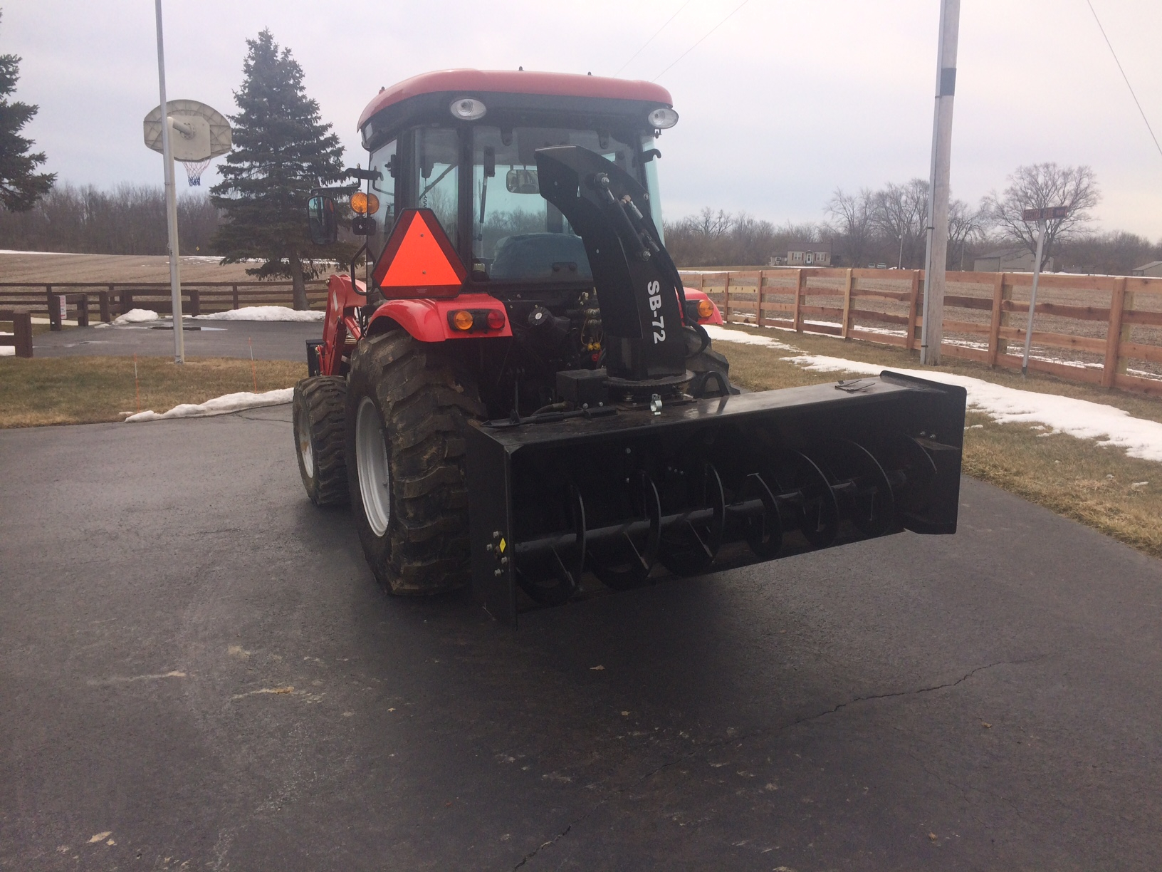

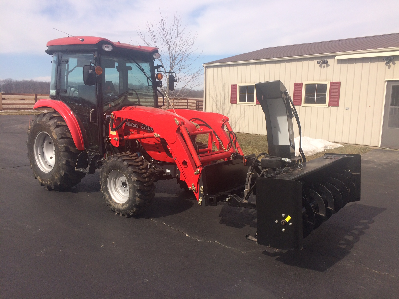

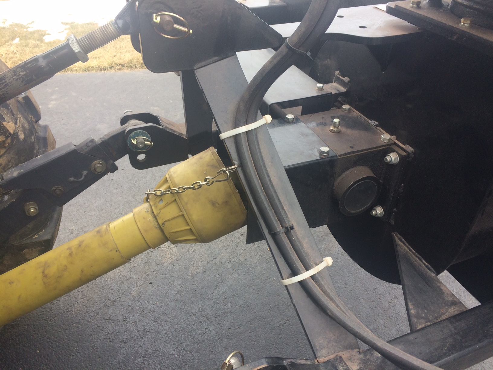

Hello

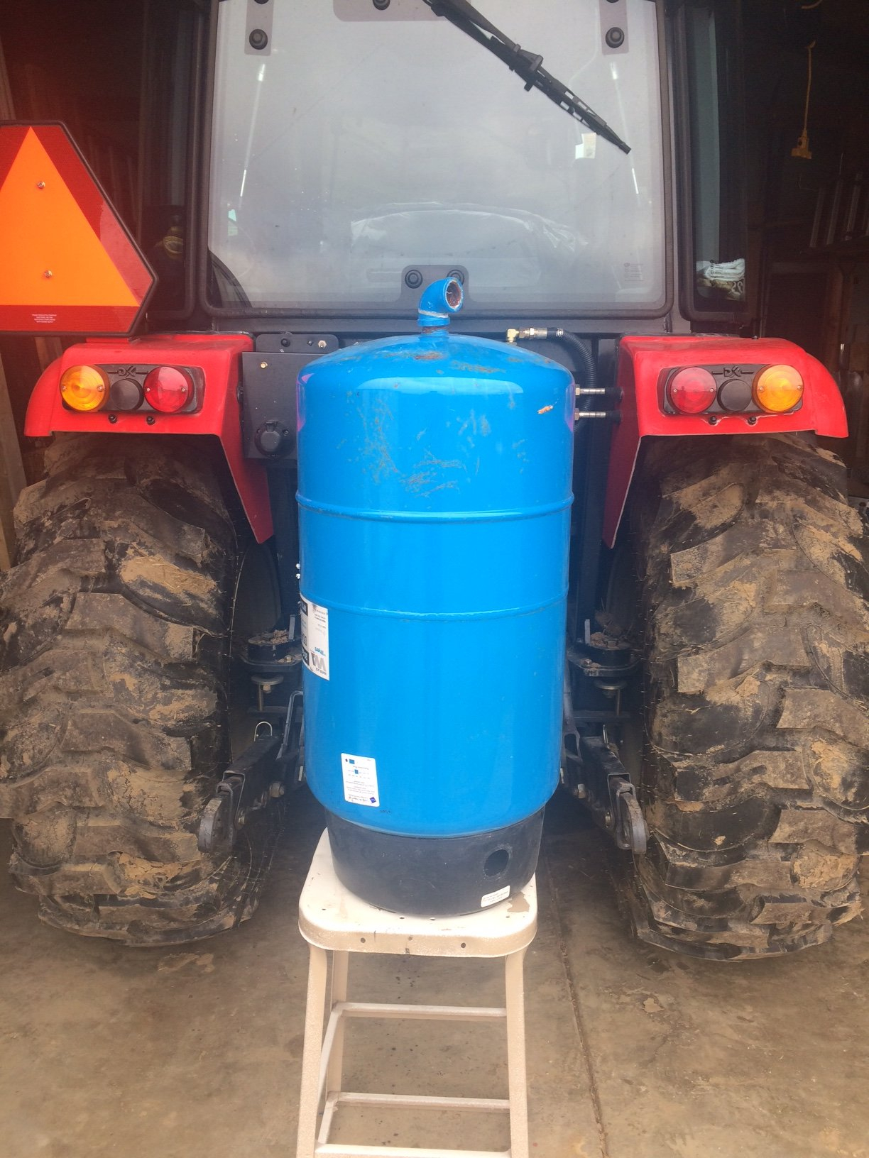

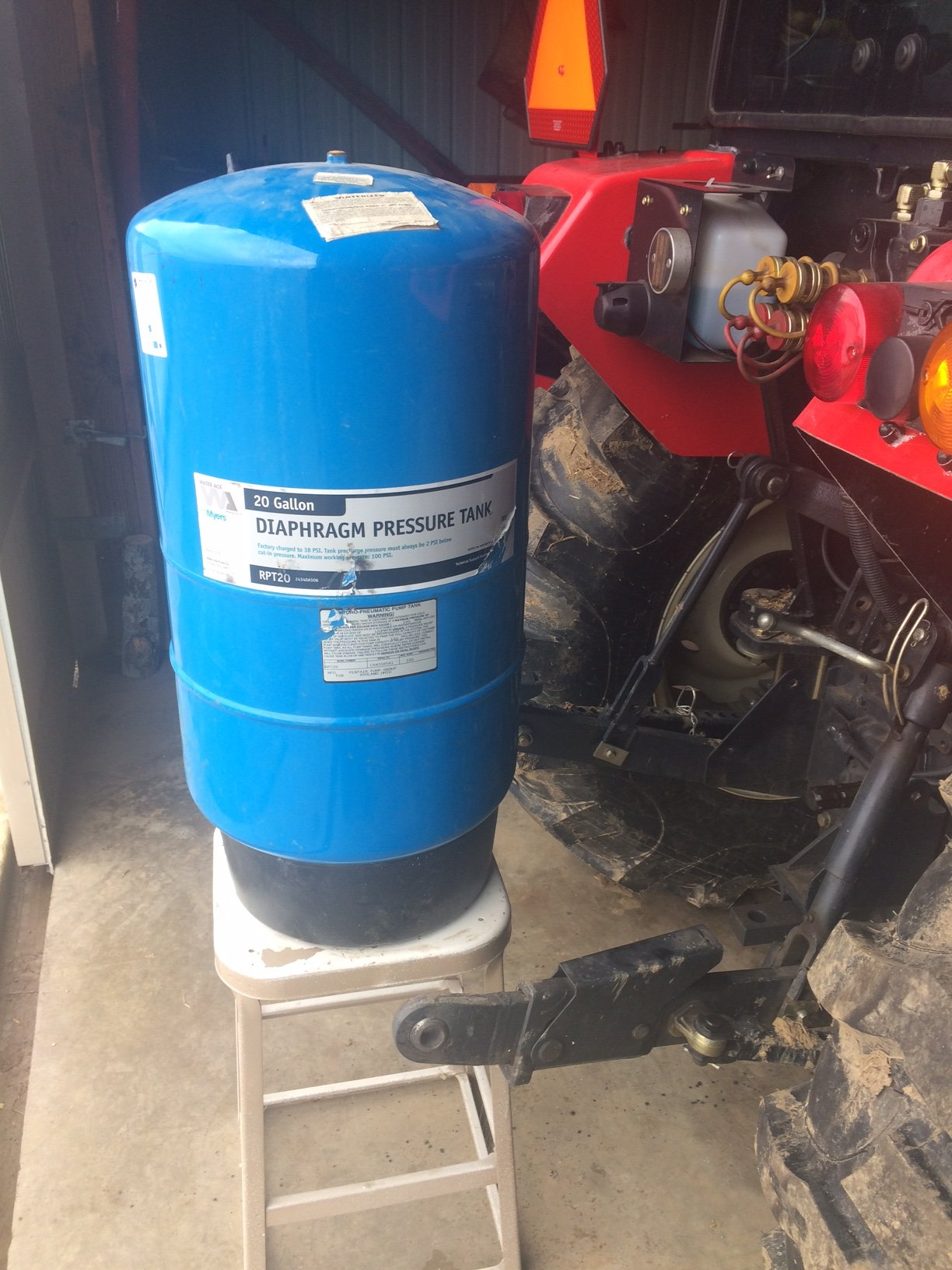

I know it’s late in the year for this project but I’ve been working on it over the winter. I decided it was time to convert my PTO driven, rear mounted snowblower To a FEL, Quick Attached, front end, Hydraulic Driven, Snowblower.....and I decided I wanted to make my own hydraulic reservoir/ tank because I didn’t like the Look of the “square” mounted units....I used a 20 gallon pressure tank from a “well system”. And designed/ made my hydraulic motor frame...it works great. I used a lot of ideas from those here at this Forum...and I thank you.

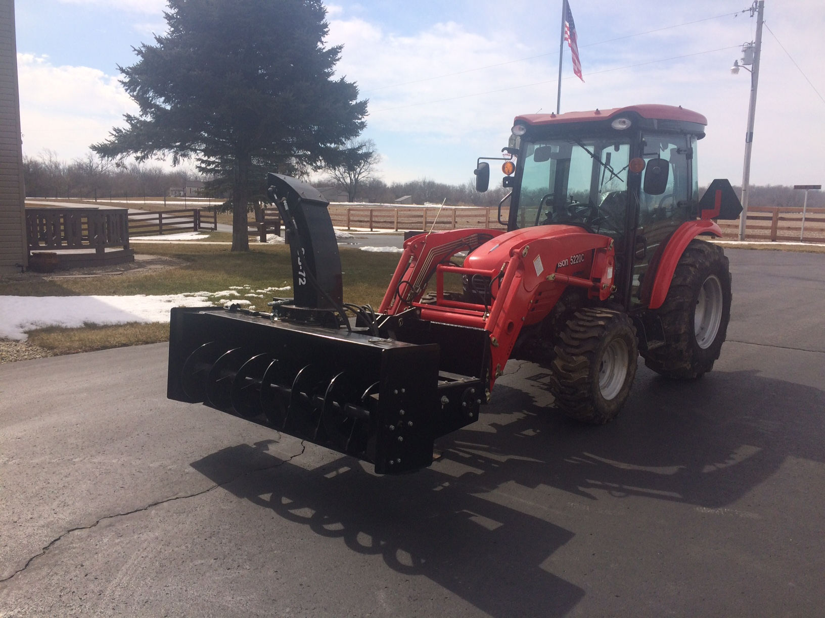

Here are some more pics.

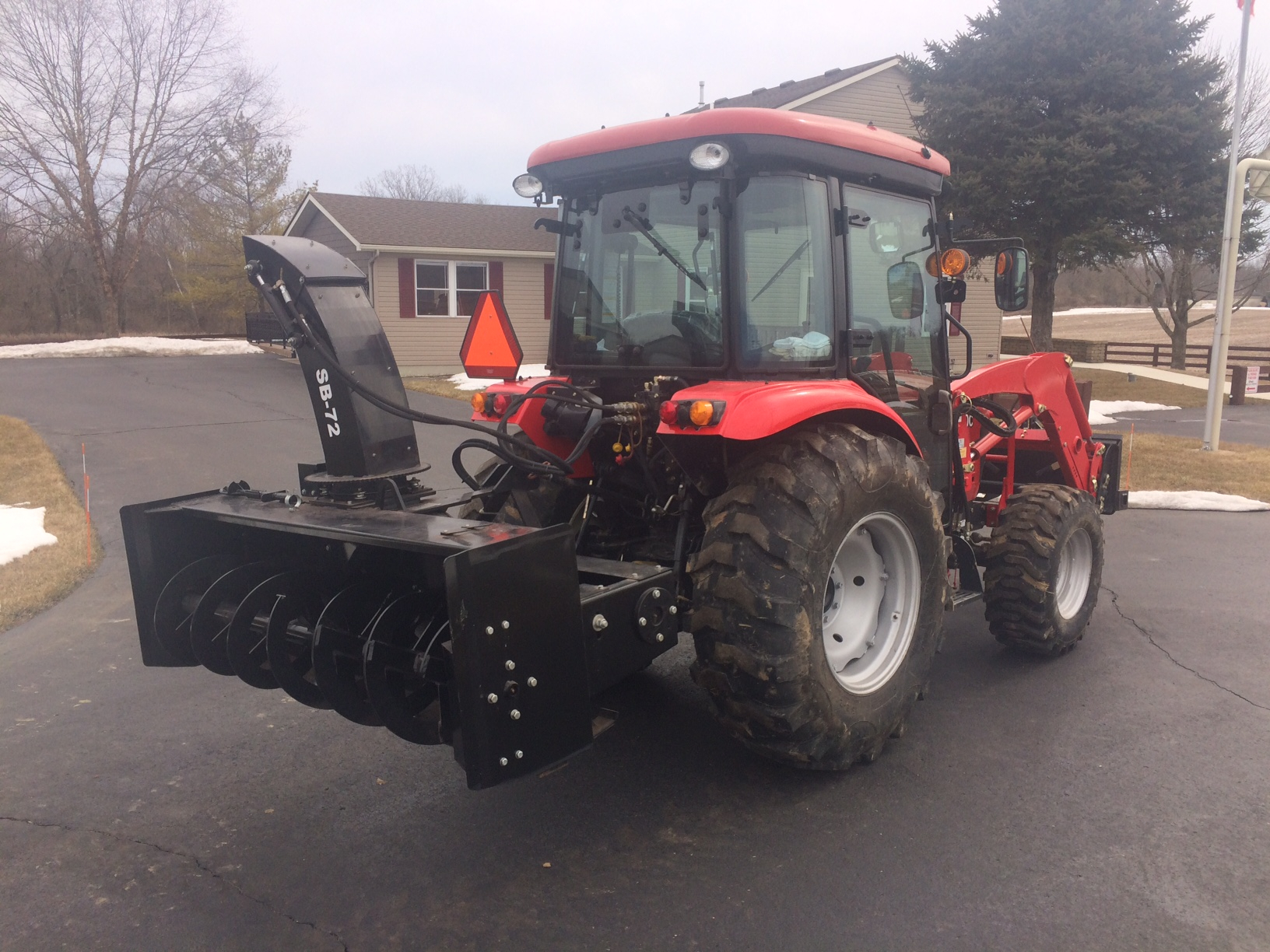

And some more snowblower project pictures

   / Front end snowblower conversion #6
Looks great. Do you pressurize the hyd reservoir tank?
I first air pressure tested at 35 psi....then filled it with water and let it set for three days...no leaks. It is now filled with 15 gallons of hyd oil. ....and no problems with over heating. I ran it on a 65 degree day, out in the sun, 2000 rpms for over an hour... the highest temp was 103 degrees ( with 15 gallons)

   / Front end snowblower conversion #9
I see now, it’s a thermometer. I thought it was pressure before. I don’t bother with temping mine, as I only use it in winter. I hit it with a infrared thermometer years ago, no issues. If I used it during summer I’d add a cooler unit.
   / Front end snowblower conversion #10
How do you handle chute rotation and deflection

#16
The chute runs off the tractor hydraulics... just had to make four longer 3/8” hoses.
#17
In the past I would run the tractor around 2000rpms to really blow the snow.
This is the tach study I did using the hydraulic system/ motor.
I an running 16 teeth on the hyd motor and 15 teeth on the snowblower gear box.
notice the 2000 rpm range...right on the money without over revving the gearbox or hyd motor

I've always been curious how you power these things from the rear. Do they make a long PTO shaft with special ends?
Beautiful, professional looking mods BTW.
   / Front end snowblower conversion #20
I could be my imagination or the camera angle but to me it looks like your sprockets aren't lined up. The bottom one is in more than the top one.
