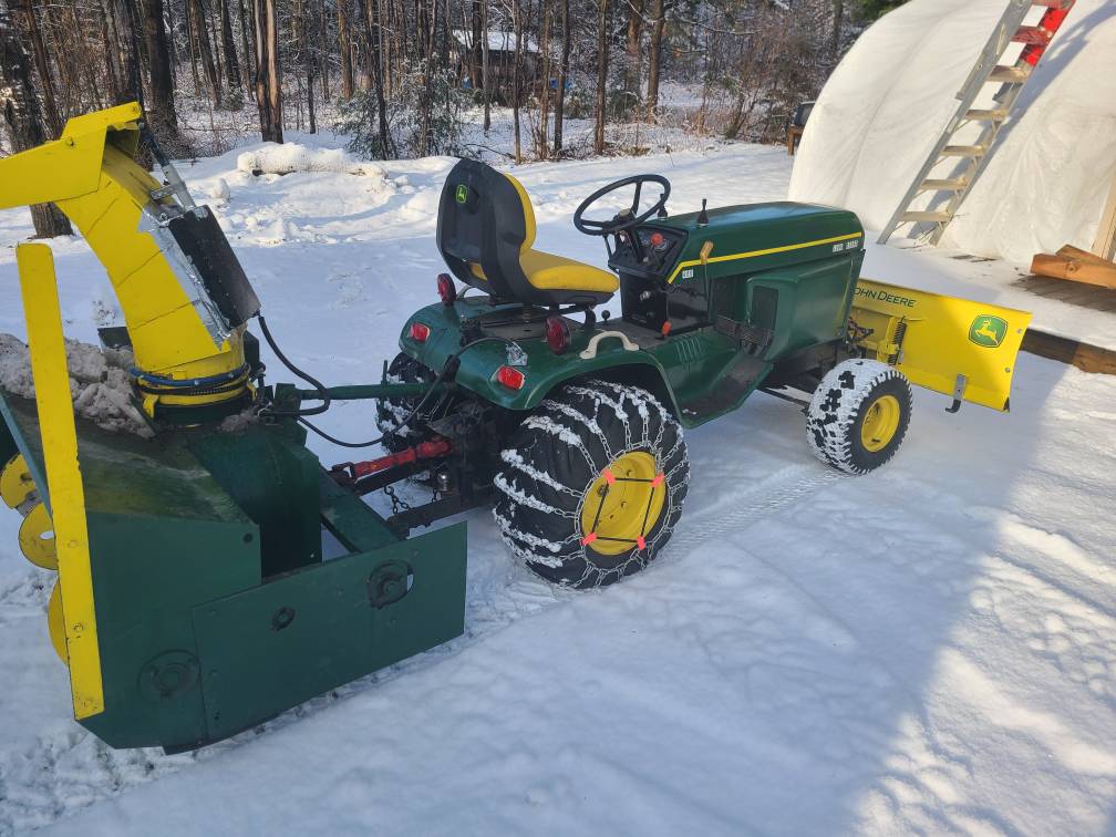

Hi.
I just got my first tractor. And i'm pretty new to this.

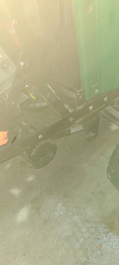

I have a John deere 400 1980. I'm trying to find a new snow plow . Do anyone know where I can find informations on what fit on it.
I cant confirm it but it look like the front attachment that fit on the 400 also fit on the x400 x700? Is it backward compatible.
Im looking for something like a quick attachment with hydrolic
I'm trying to figure it out for a few day but I dont know where/what/how to search....
Im trying to widen my search on the used market as there is not a lot of attachement close to where I live. And it's not always clear what I need.
The plow that is on it is unusable. Wrong angle. No spring and controlled with a winch. And it's almost falling in pieces ( bent everywhere and part are unsoldered.)
Thanks.

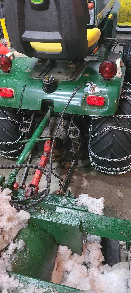

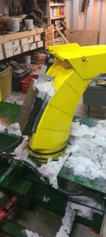

Can the 3 point snow blower be easily converted to front with a quick hitch?

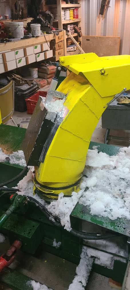

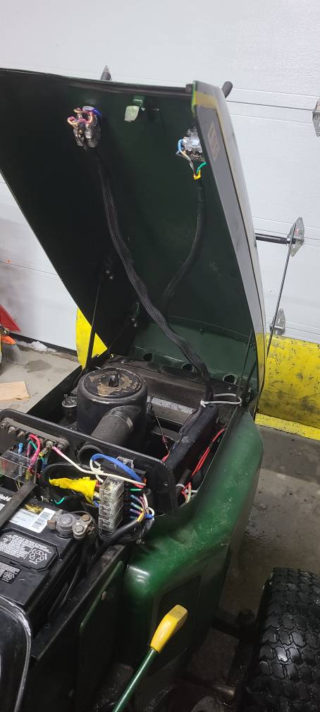

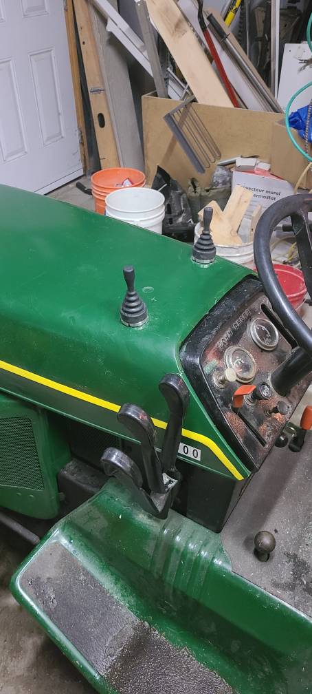

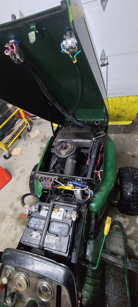

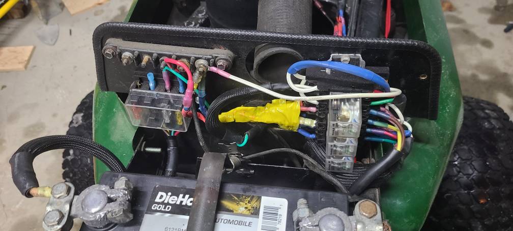

I installed a 4 way joystick to control the chute ( home made 12v with old power windows motor) it was previously controlled with 2 switch. And a 2 way joystick for the front winch. I had to learn how to wire dpdt relai and at the same time I add a fuse box .
The snow blower was directly connected to the battery so I installed a quick connect that look like a trailer plug. I had a hard time figuring where to put the joystick. On the hood they are working great!!.

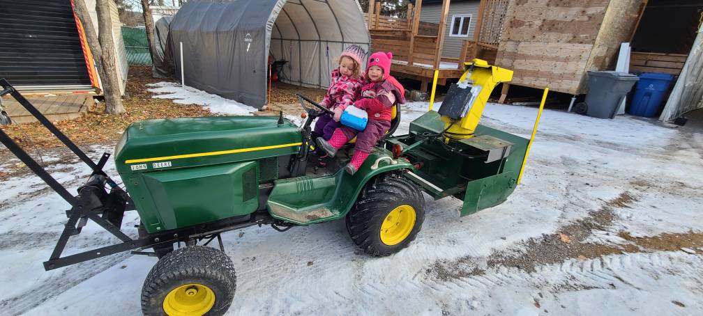

I'm also trying to finf a way to have my 2 daughter sitted somewhere as they always want to have a ride. But right now there is no safe spot :( and there is not enough place on my knees to be able to correctly drive it. Those who ave one know. This thing is crasy fast and I'm not used to the hand trottle

Funny story . First snowstorm I tried it today the pto stopped working. I though it was the strap. I started disasembling the front to realise it was the pto lever cable that broke. I made a temporary fix and I will try to find a new one .
I joined a few picture. I just got if last week. this spring I'm planning a paint repair job.

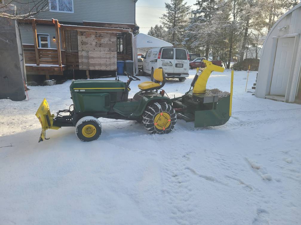

Thanks For the info again. I manage to find a plow that was annonced for a 420 (almost new);and it fitted right away. I'm still waiting for annother one that I ordered just before. It is rusty and the hose have seen better day. I'll sand blast it and repaint it to make it look like this one to sell it after. I will onviously not need two. 20201205_131353.jpg20201205_131326.jpg

I dont think i'll try moving the blower to.the front as I might need to resetup everything or have to weld a few thing. This blower is made for 3 point hitch. And it is heavier than the front one that fit on the 400.
I only tried it a few time and twice it was really wet and heavy snow and it worked better than I though it would. This tractor is a tank when you have chain and enough weight

Worked on it a little this year. Had second plow that i reversed. Then I learn to weld then add side to it. This reverse plow is the best thing I had on it. The pushing one dont worth **** lol. You can tilt it. But it's just pushing the tractor on the side instead of scrapping. Then I start a cabin that In mounted on the seat screw ( was able to prototype a buddy seat for my Kids) at least for now the top is helping when it's raining... I add some light .(front and back) but I think I might need to find a way to have a bigger alternator. The battery is slowly draining faster than recharging when engine is running. The picture with the black plow is before I finished the modification. I had tried it on the 3 point first. I redid about 90% of all wiring
This week i'm putting in a new alternator and a new air filter
Then finally I added about 20 pound on each front wheel with training weight that Inhad laying around. Could not find affordable wheel weight close to where I lives. It truly make a difference

It had a old strap windshield motor for the chute angle but the strap was breaking every year... I change itnfor a 12v actuator but this thing is slower than a eartworm. The engine is only 19.9hp. And the snow blower was custom fit. Not throwing snow very far as soon as it is' heavy snow you need to slow down a lot. But still worth every penny. Was probably made for a 25hp and up engine.
As of now it cost me around 3500$ us with everything I added.
Next summer ( i dont have a heated garage yet so it too cold to donit this year) I'm thinking of making quick removable framed pannel for the back. And top half door removable for side. And a 3 piece angle windshield ( maybe folded if I manage to find a way) with some sort of leather or flexible material at the botom to still be able to lift the hood. . Right now it's plexiglass as everyone is selling. When it'll break ill probably switch with the brand lexan(polycarbonate) I live in Quebec city and winter snow accumulation is about 300 to 400cm (10 to 12 foot ) I love the 400 it's the easyest thing to customize I know. Would not do those on a tractor I paid 30 000$ and up.
The only reason I think I might changed if it still work is maybe if I find a 4x4 around 25- 30hp.
