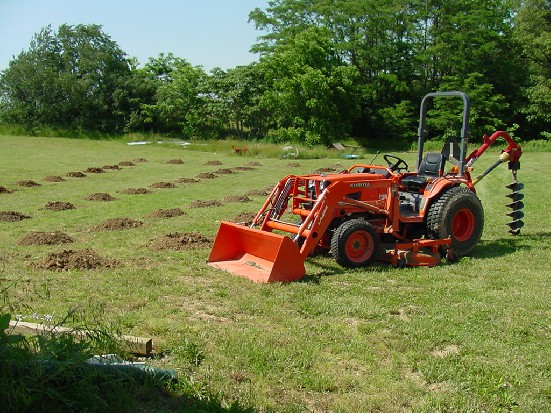

fiveacrefarmer
B7800 Kubota
Time to review Kay (Kubota B7800 HST)
Model Year: 2006
Kay is the hardest working girl I've ever met. I'd buy this tractor again tomorrow. I've used the following implements with these results: 1. 72" finish mower: Plenty of power, good turning radius, hard to work into the small spots. Only bogs down when I’m cutting too much too fast. 2. 60" brush cutter: Plenty of power, cut through saplings up to 1" diameter with no trouble. 3. Post-hole digger: full size auger went on well with adequate clearance even to load onto and off of the trailer. Good power and digging strength in heavy Oklahoma clay. Needed additional weight on the auger to break through sandstone... would benefit from rear hydraulics for this. Worked very well. 4. 5’ heavy duty box blade: somewhat mixed results. Quarter inching valve is a pain and is hard to keep accurate. Top link tends to loosen over time reducing the amount of blade cut. Compact type sway links on the three point make implement changes a chore especially with implements that are hard to wiggle around (like the box blade). Will bog down in soft ground if you hook up with too much scarifier tooth in the ground. Generally works just fine for the job. 5. 5’ loader: Perfect. No complaints whatsoever.
Pros: 1. Plenty of power
Cons: 1. Lights are a joke. They’re dim and poorly positioned for a FEL. Only work at night under a full moon!
Photo Uploads:

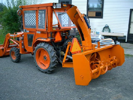

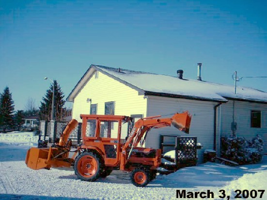

Model Year: 2003
I wanted a tractor with lots of PTO power but light enough to trailer behind 1/2 ton pickup. I use it in town in winter for snow removal with FEL and 72" rear snowblower, and at our country place in summer for grass and bush cutting, handling firewood, and miscellaneous tasks. It has the LA402 loader and I built my own cab for it. I am totally impressed with how strong this little beast is. The FEL is strong...I reshaped my garden lot in town by digging up and removing about 60 cu. yds. of hard packed clay. A heavier L-series of similar horsepower may have done better due to more weight, but the B7800 performed admirably. On the PTO, it really shines. It is very nimble...turns on a dime. The only problem I have had is the safety switch on the "GO" pedal once got loose in its mount, so the tractor wouldn't start. I disconnected the switch, put a temporary jumper wire across the harness and got it home, where I corrected the problem....an easy fix. Hence, only 4 stars for reliability. If not for that it would get 5 stars. I was looking for a "Plain Jane" workhorse, and I am totally satisfied with the B7800.
Pros: HST, high power to weight ratio, easy to trailer, reliability, manoeuverability.
Cons: none for me.

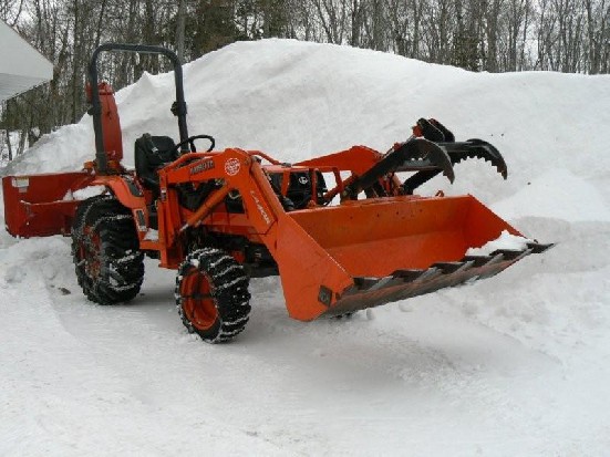

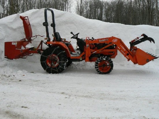

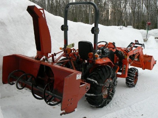

Northland
B7800 Kubota
Good value tractor
Model Year: 2006
I paid US$16K for my B7800 from a dealer in the Michigan UP. I use the tractor for snowblowing my driveway and trails in the winter. In the summer I use it for trail clearing and logging trees for firewood. I have a Tatro bucket grapple, 5 foot rear Agrotrend snowblower and a United 5 foot box box blade as well as a TSC carry-all and v-bar tire chains all around. The tractor has always performed reliably and has done everything I needed it to do. I have happy I bought this make and model of tractor. It's a great value for the price.
Pros: power, ground clearance, perfect size, value
Cons: lacking some features-position control 3 pt hitch set-up parts
Photo Uploads:

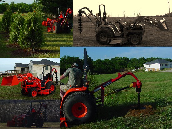

5.00 star(s)
Fug1000
B7800 Kubota
God bless my Bota
Model Year: 2007
Having never owned a tractor or even a riding-lawnmower in my life, I wasn't sure what to buy when I got my new 11 acre home back in 2007. Somehow, God blessed me and pointed me towards the Kubotas. I think the rude John Deere dealer I first visited helped in my decision a bit too. I as looking at one of the only 3 CUTs on a lot full of combines and huge tractors...I suppose I wasn't big enough for him....but that's another story. After a lot of reading, talking to my online friends and some eBay crawling, I decided I wanted a Kubota. I bought my B7800 in Springfield, Ohio at "Comptons" and the salesman Jim made me feel right at home. I was looking at a stripped down B3030 on the showroom floor but I was a bit hesitant about the price it would be for all the features I wanted: FEL and MMM and Turfs being the most important so Jim told me about the last B7800 they had in the "back" that just happened to be configured the exact way I wanted and he went and fetched it for me. As soon as he drove it into site I knew it would be mine! Now 3 years later, I can say, it works just as hard as it's good-looks make you think it will. I have not had a single problem. I maintain a 900 foot gravel driveway, and I plow it in the winter, I mow 6 acres finish and 2 acres with a bush hog. I have planted over 40 estate sized trees and dug about 100 fence posts. I've hauled gravel and dirt. I think the thing that really impresses me is when I go out to the barn to start it up in sub-zero weather, even if it hasn't been started in a week, it fires up every-single time. It has all the power I need and no matter what crazy job I come up with for it, it has never failed me. I can't say enough good things about my Bota. I honestly don't see how Kubota Inc. can stay in business. The tractors are of such good quality I can't see myself buying another one for 10 or 20 years! Let's see GM or Ford try to stay afloat with that business model!
Pros: Dependable, reliable, works hard, looks great.
Cons: Lasts too long!
Photo Uploads:
