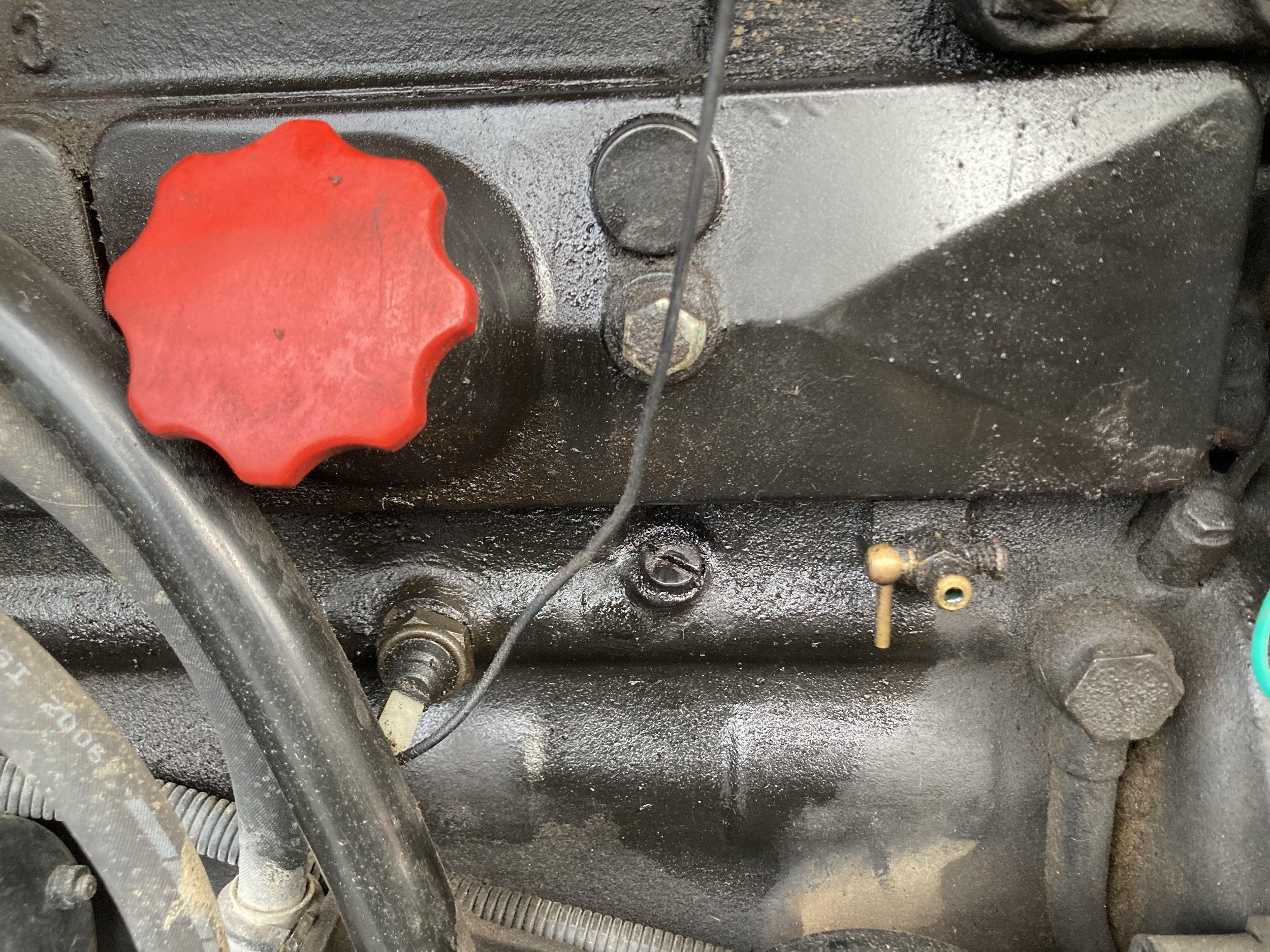

Apr 23, 2022 / Zetor 6340 engine oil leak #1 K KevZetor6211 New member Joined Jun 9, 2021 Messages 10 Tractor Zetor 6211 Hi, I’ve noticed some oil in the side of the tractors engine after about 30 mins work, don’t know where its coming from, I’ll attach a photo. 2006 Zetor 6340 Attachments AABE7632-1E9A-4252-8473-88BC80316286.jpeg 2.7 MB · Views: 382

Apr 25, 2022 / Zetor 6340 engine oil leak #2 P pycoed Silver Member Joined Mar 28, 2007 Messages 179 Location West Wales UK Tractor Zetor 7045; Yanmar YM1820;Wheelhorses C121, C101, A8;Cushman Turf truckster Looks like it's the breather plate the oil filler is attached to. My 7045 was the same, try using some Hylomar or Permatex on the gasket.

Nov 25, 2022 / Zetor 6340 engine oil leak #3 Joachim New member Joined Apr 18, 2021 Messages 11 Location Deutschland Tractor Zetor 5011, 2011, 3045 and 7745 I think its only a old O-ring rubber seal - just change it to a new one, best will be MVQ instead of the original NBR material.
