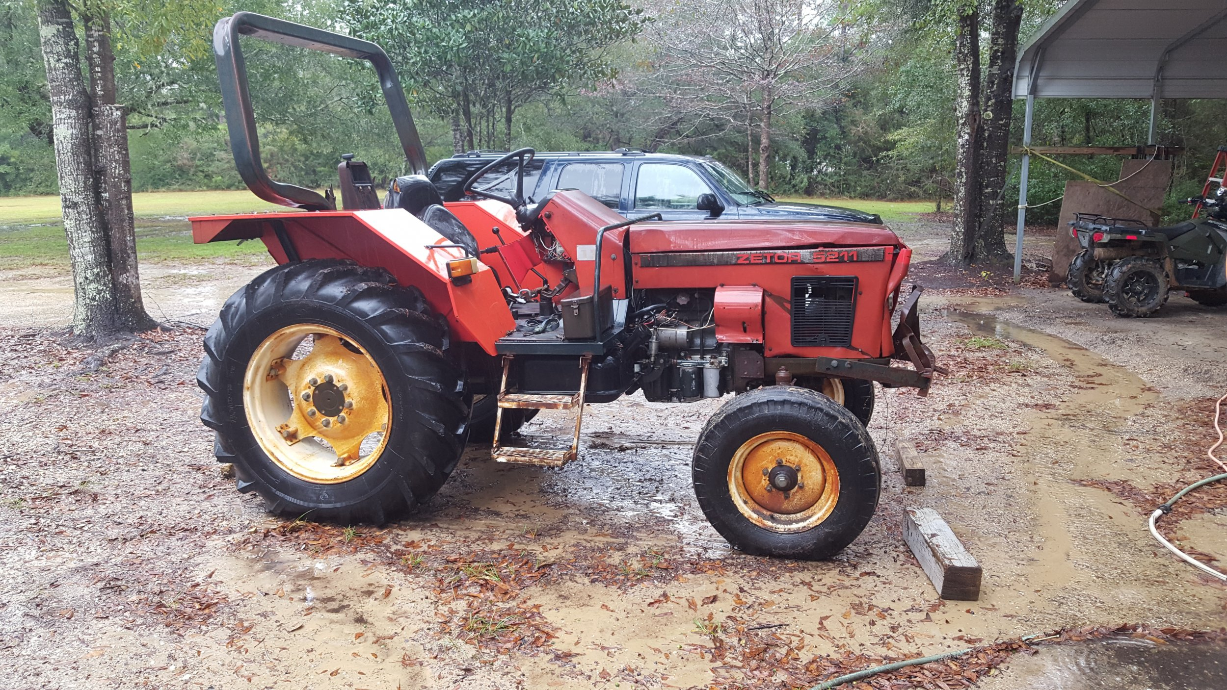

oh, the wiring can bring frustration, i pulled all new wiring through mine that i needed right away.
when i first got it, it was in rough shape.

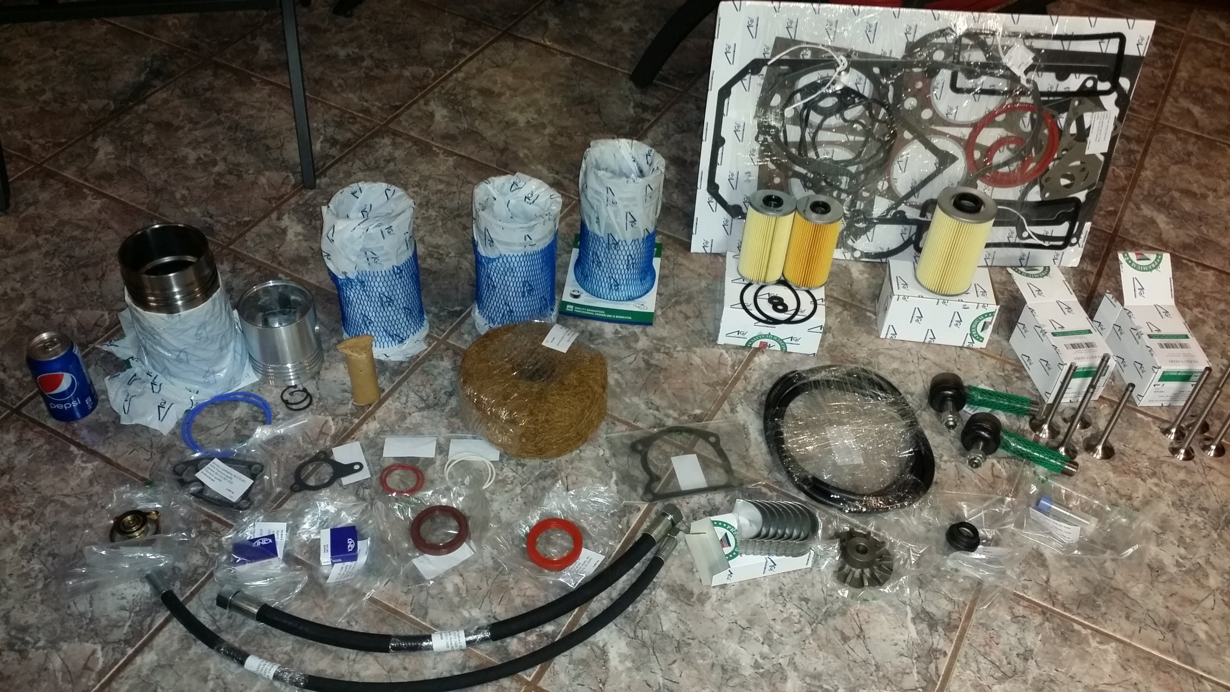

Ridgeway Enterprises is expensive. Look at "ATP Motor". Ordering parts from Czech republic is easy, much cheaper, even with transportation and customs. Usually takes 10 to 14 days.
The parts in the picture were US dollar 340, and delivery costs with customs and brokerage about 400 dollar US. total 740 US dollar.
