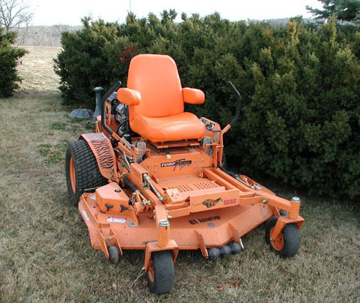

Richard, I bought a used 60 Inch Scag from a guy going out out of the lawn care business. It is an 2001 turf tiger with the 27hp liquid cooled Kaw. Paid $4800 it had 261 hrs and a broken seat (former owner was huge). I could see where the deck height pedal could be a problem for someone with bad hips. It is waaay faster than my yanmar with finish mower, can mow in 1/3 the time as before and cuts better. It was 2 years old when puchased just for a value point. It turned into a welding project on the seat frame and then an upholstery project.
