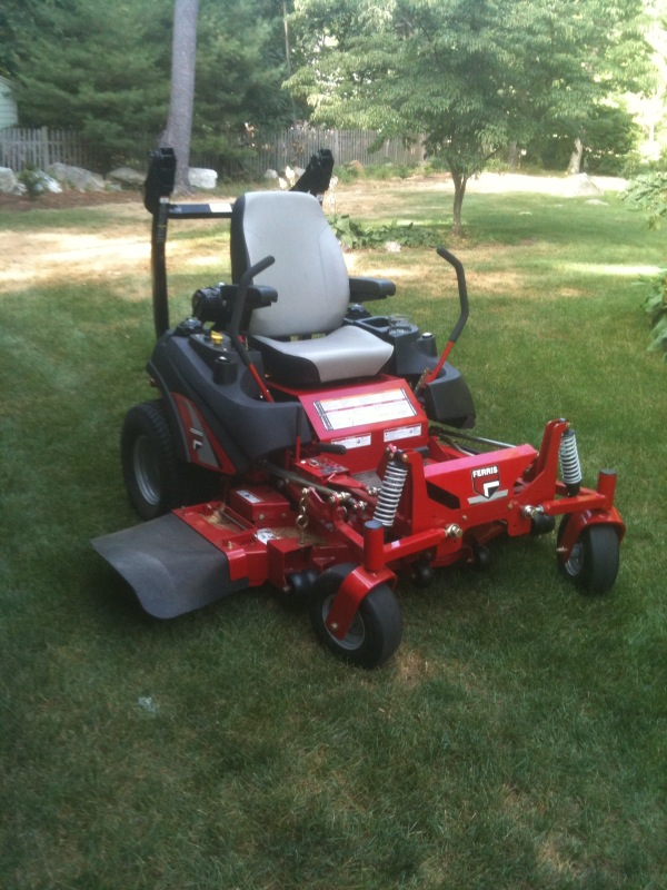

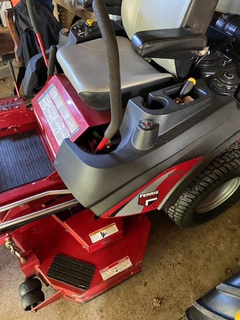

Really depends on the mower brand and deck/handle setup. For example my Ferris ZT has a 10 GA deck with a step, and the handles allow for a grab point. The handles when opened are sturdy sitting in U channel and don't move around.

Posting a pic or a link to a picture of your ZTR would make it easier to offer suggestions. I just finished one for my tractor yesterday.
/ zero turn lawn mower #7
Thanks shooterdon, that gives me an idea for mine. What I need is a safe step instead of using the front wheel which can be slippery. The deck is a no-no as it swings from chain.

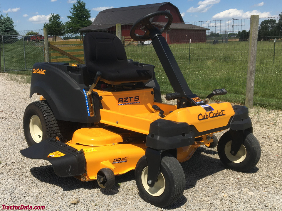

as it turns out I just made a deal this week, on a zero turn 2012 Cub Cadet RZT S50.
I have similar needs / requirements, as getting on / off equipment is a bit challenging for me (cerebral palsy).
The agri-repair service place that I purchased the machine from is now doing some custom fabrication for me to add (additional) hand controls for braking, forward, reverse (they will add to the existing bars for the pedals). They will also add a grab handle bar for me - probably off the rear - going up from hitch area (?), OR from the corner bolts near the front wheels. I will get the machine in a week or two, will post photos.

kydick - I think the fabrication would be fairly easy, although that is not my skill. I can get creative with ideas, and solutions, but I don't weld at all, so if I was to design it, it would be a bolt on handle. Since I'm purchasing the machine, I'll have him do it to sweeten the deal for him. Still considering adding a single, square LED headlight also.
Since the ROL looks to be not used. Can you reverse install it so it folds forward and provides upper support to grab to get on and off?
