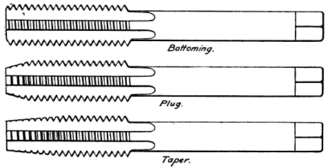

Not sure what a bottom tap is?
It allows you to tap to the "bottom" of a hole. The tap is not tapered it's squared off at the end. They are harder to start though.
Common types of taps:

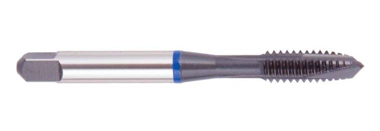

On taps I use spiral flute aka gun taps from McMaster Carr. The usual hand tap is like a wooden wagon wheel in comparison.

Here is a spiral flute tap it draws the chips upward like a drill bit.
And a spiral point tap it ejects the chips downward.
Either works about 20x better than the usual hand tap.
