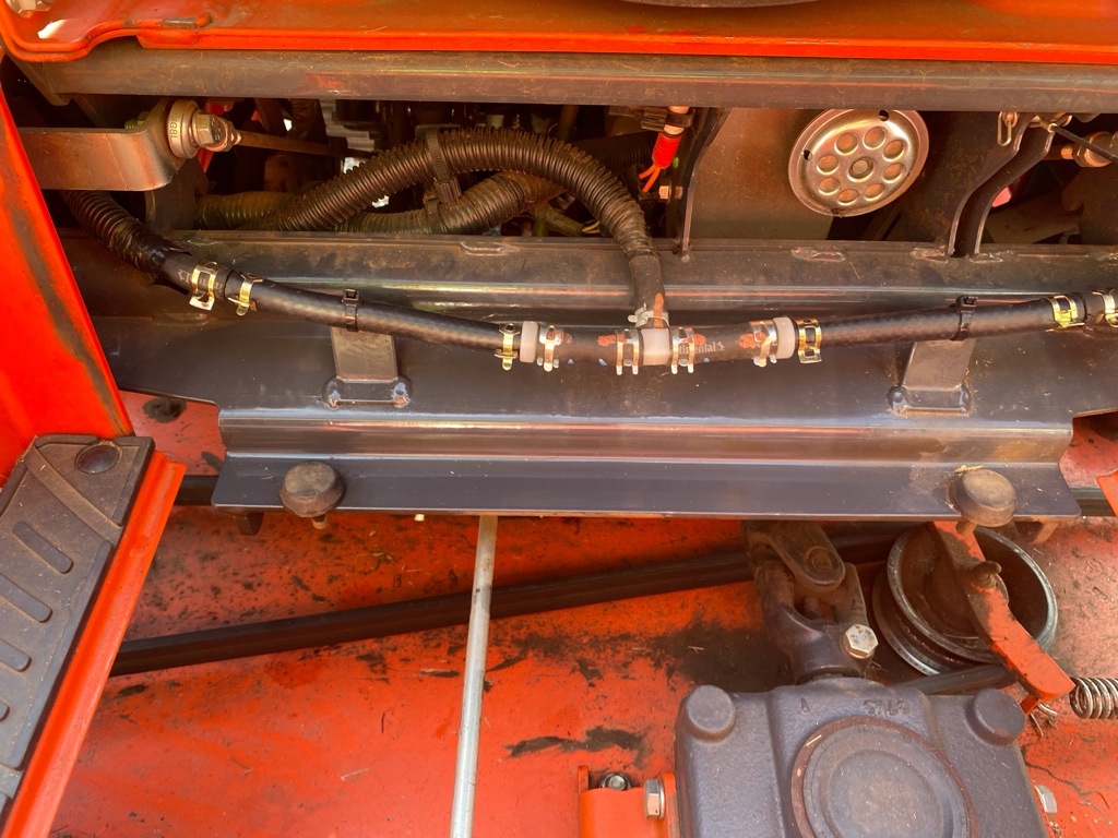

I finally got my ZD1211 outfitted with a 2 micron Racor Fuel filter, and deleted the small individual tank filters. About a 2 hour job.

After running the mower under load, the fuel supply wouldn't keep up with demand. I had to add a second electric lift pump.

Do have a parts list so I can do this to mine please
I have since returned the fuel system to stock because of (apparently) unrelated unequal fuel tank drawing issues.
Racor 215r2 filter
5/16" fuel line
Amazon 12v inline fuel pump
1/4" npt (?) X 5/16 Barb fittings
Maybe a 5/16 double male barb
Zip ties
/ ZD1211 Fuel Filter #7
Racor 215r2 filter
5/16" fuel line
Zip ties

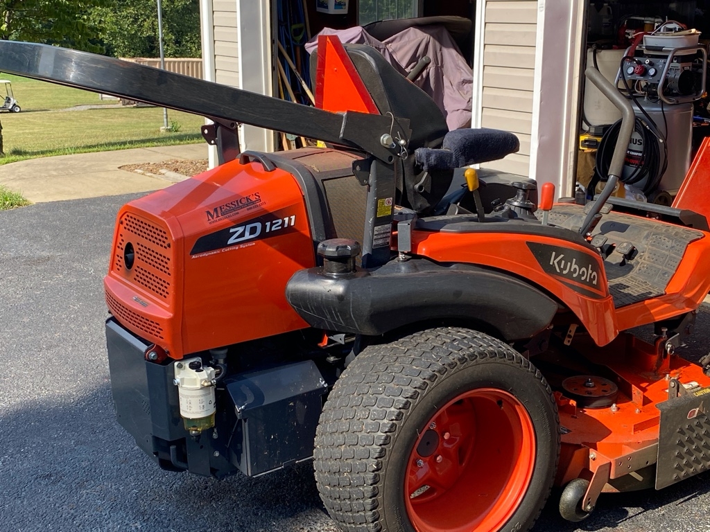

I'm certain that the Racor addition had nothing to do with my current equalization problem. It's all back to stock now, still not drawing off of the right tank with both fuel valves open.
What I have done : (no particular order)
- Blew out all lines, plus return
- Replaced aftermarket filters with oem
- Drained and flushed tanks (NOTHING found)
- Confirmed check valves working, and replaced anyway
- Replaced most fuel supply line
- Removed tank shut-off valves, Confirmed operation, cleaned
- Confirmed no dirt in tanks
- Confirmed tank caps are venting, clean (there has never been a vacuum detected in either tank)
- Confirmed fuel pump working, good fuel flow at EVERY point in the system (ie: good flow at bare tank, after shut-off valves, after tank filter, before lift pump, after lift pump, after final filter, at injectors.
What happens:
Right now, with both tank valves open 90% + of the fuel comes from the left tank. The left tank filter is always 1/2 full, and the right tank filter is always full. No amount of bleeding will fill the left tank filter. The mower will run fine off of each individual tank by shutting off the other fuel valve.
After my initial troubleshooting listed above the mower ran great for 30 hours, with fuel equally drawing and both filters full. Now it's back to the state of not drawing from the right tank.
The only fuel component before the injector pump I haven't looked at is the crossover equalization tube, but that appears to be simply a pipe connecting the tops of the two tanks.
I'm keeping the Racor for future use, but there are inexpensive knock-offs on the market that get good reviews here on TBN.
#12
I was going to just use the tank valves, or install a gated wye for convenience.
What happened was :
- With the left tank valve closed, I used up the 6 gallons in the right tank... Just like you'd expect.
- Closed right tank valve, open left tank valve. After about 30 minutes of mowing on level ground, the left tank is empty and the right tank is FULL. (?)
The crossover air equalization tubing terminates at the top of each tank, so there could not have been any siphoning of fuel. There has never been any suction or pressure detected when removing the fuel caps, so I'm ruling the crossover tube out.
The only thing that remains is the fuel return line (s), and apparently there are several. If the fuel return line to the left tank was blocked, that would seemingly explain my recent symptoms.
I have blown out the one return line on the rear of the overflow pipe, which T's to each tank. On the front of the overflow pipe is a smaller hose that goes to a "T", with one side going to something called an Air Breather, and the other side of the "T" goes to the injection pump. I just don't see how anything from the front of the overflow pipe could explain the problem.
