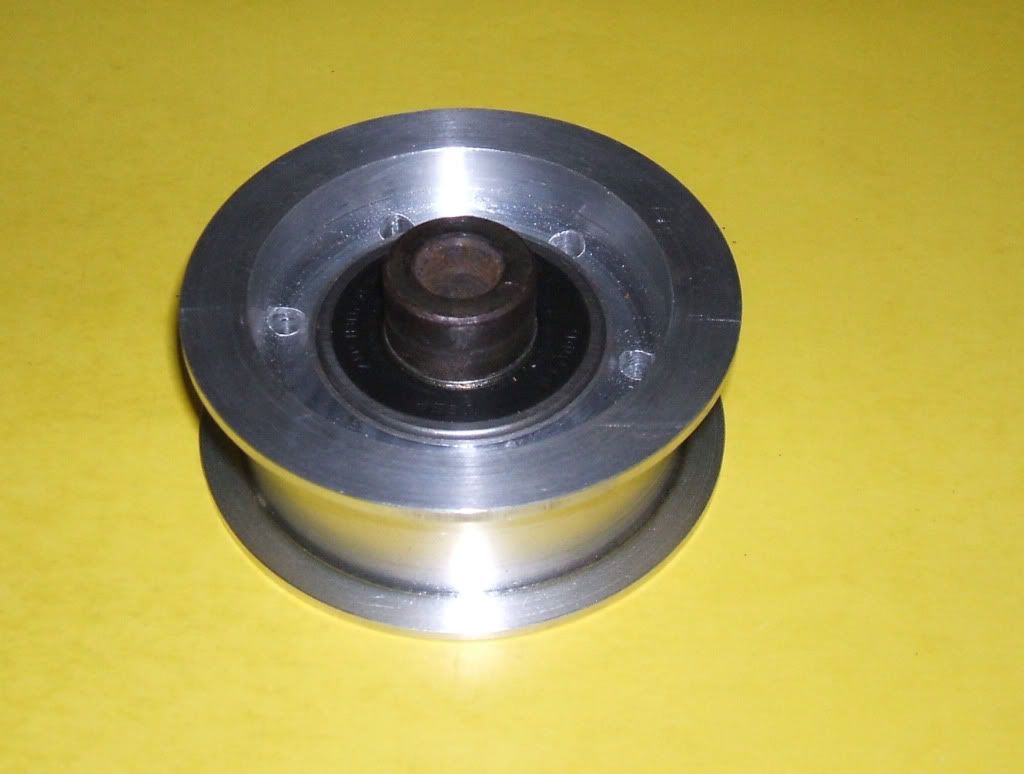

Normally when I order parts from MTD early in the week I get them in a couple of days but for some reason I didn't get the new idler in this week. So I decided to go ahead and make a new one which is what I was going to do in the first place. I needed to get the Cub out of the shed because I had put it up on jackstands right at the door thinking that the part would be in before I had to work on something else. Well here's what the new one looks like.
/ Z-Force drive belt idler #10
Your a heck of a chip spinner OM. That's a beauty of an idler.

Well the new idler just arrived and they have done away with the plastic and gone to steel with a sealed bearing.
/ Z-Force drive belt idler #12
Looks nicer than the plastic for sure. Now you've got a great spare or sell'er on eBay.
