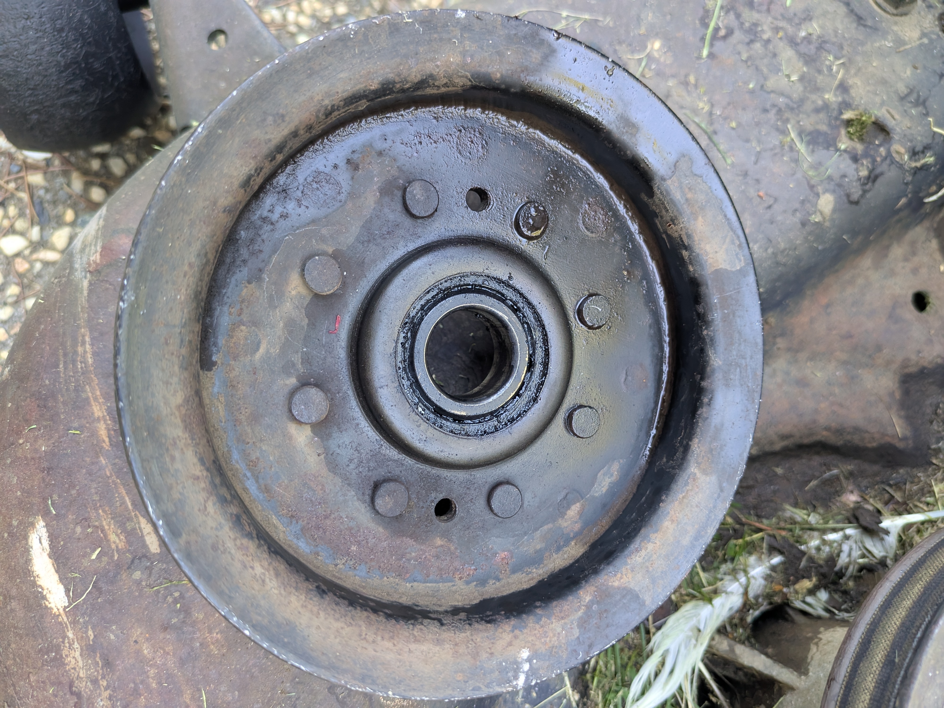

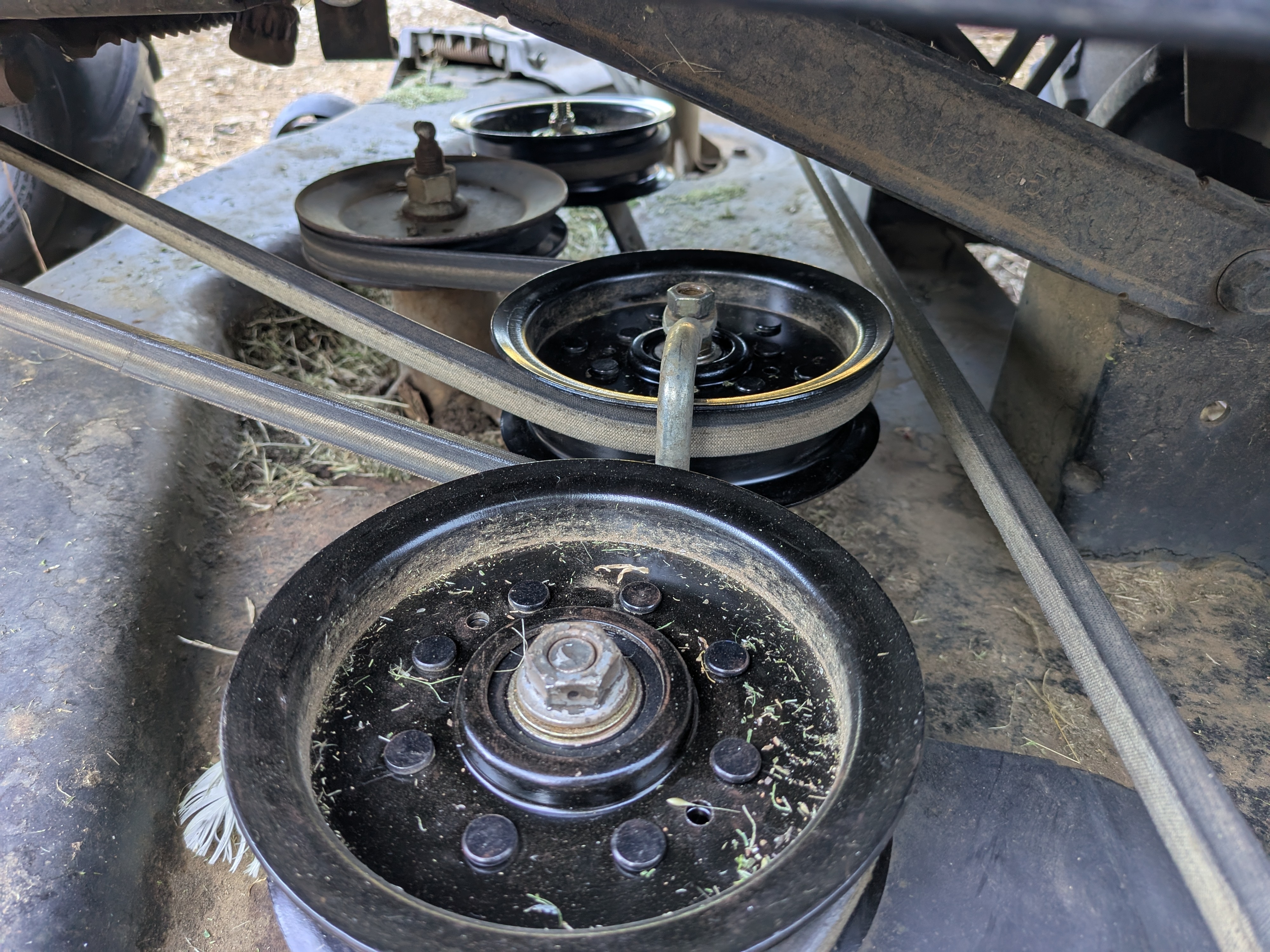

Had an idler pulley start smoking, luckily noticed before it torched the belt along with it
from what I can tell, the bearings don't look serviceable - no snap ring or anything top or bottom - am I missing something? Guessing you'd have to undo the eight big rivets ...
I just ordered replacements for this one and the other two idlers for $40, no huge loss, other than time and "I hate it when you can't fix stuff".

It's too late now, but those seals will ALWAYS let lubrication oil into the bearing after a small amount of use.
I make it a practice to clean the bearing first, then just give the top seal surface a squirt of chain lube and a squirt of motor oil. let that creep into the bearing past the seal, and viola! Extended life through lubrication!

I'll keep it in mind - maybe I can get the replacements to go another 18 years!
/ Mower idler pulley #4
"another 18 years!" get that.
Good chance the pully worn from the belt.

/ Mower idler pulley #6
I had a pulley like that a few years ago on a friends deck that wasn't available. so I drilled out the rivets, the halves separated, popped the bearing out and installed a new one. Bolted it back together and it lasted until he junked the mower several years later.
I think it used a standard 6203 bearing, or something like that, which I had on hand.

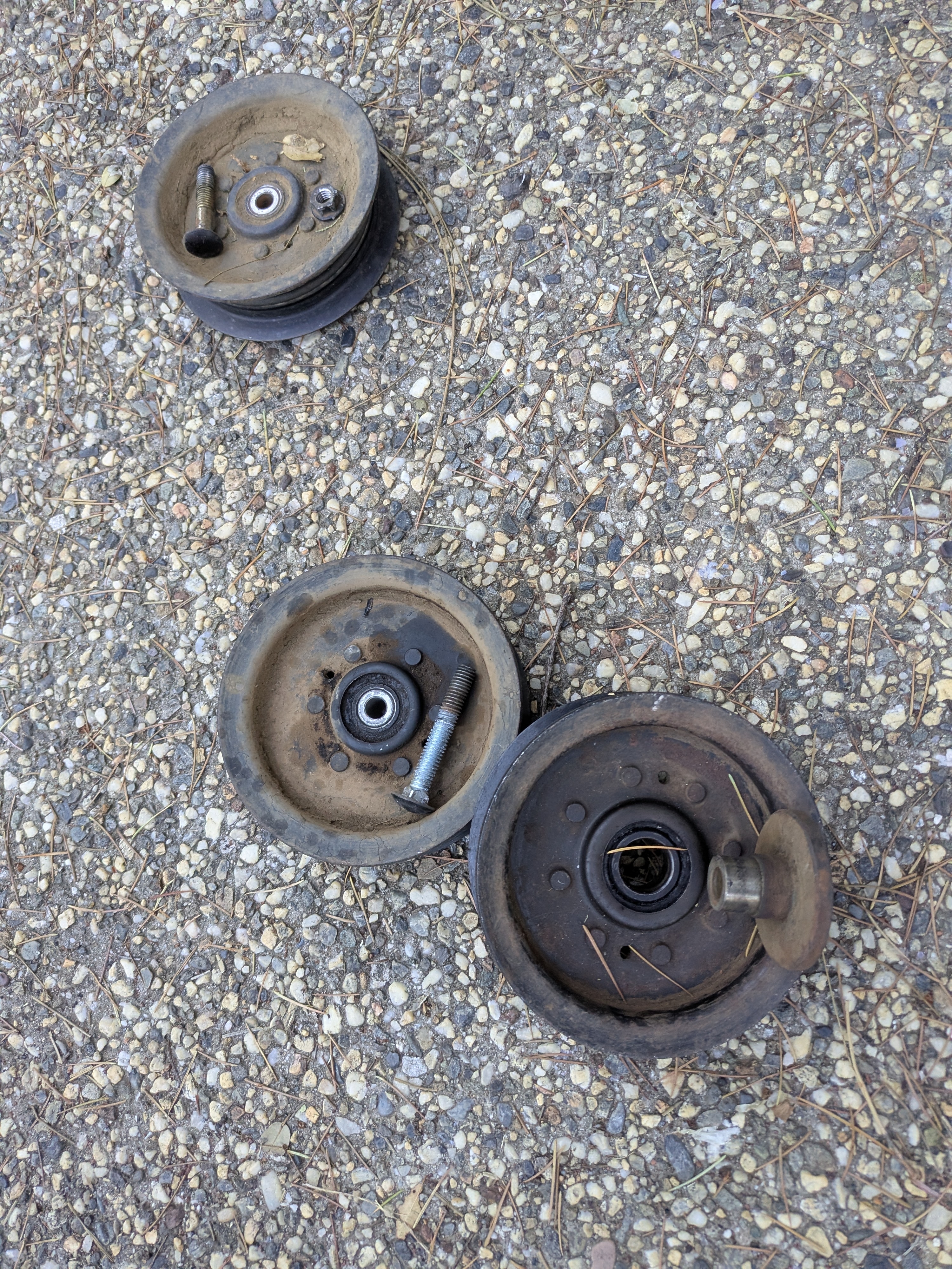

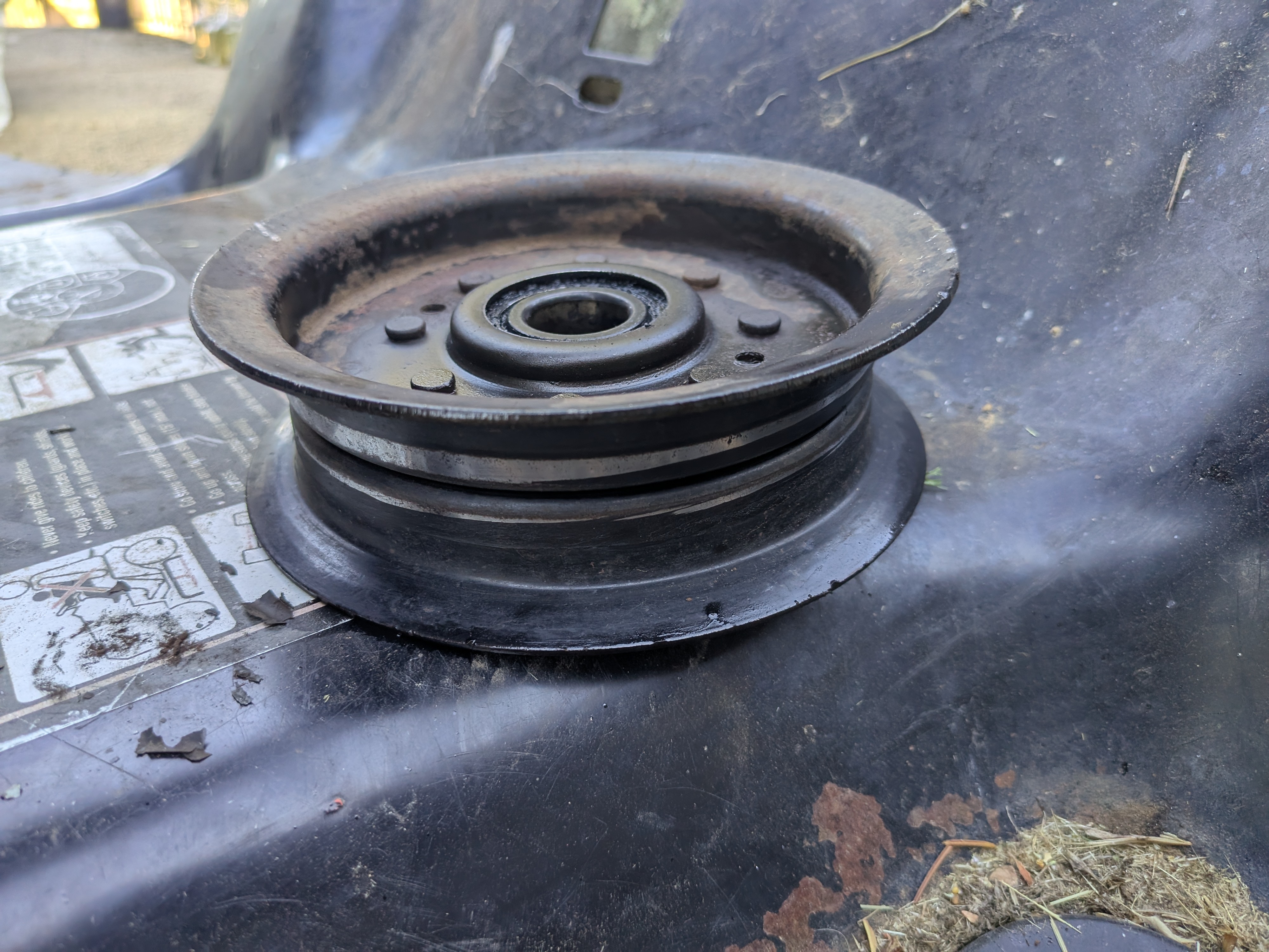

Out with the old
In with the new
The other two idlers were still moveable but I could feel they weren't doing too hot (wait a minute they probably were getting hot) too good either. Had to torch one nut to get it moving and used a cheater on another... about 30 minutes total and then a quick lube of the mower spindles and steering spindles.
The mower deck spindles are replacements already - ten years ago according to my ordering history. These ones seem to be working well still; unfortunately for the originals which didn't get lubed... ever. I know what lube zerks are for since then!
Did the same except I used steel rivets to reassemble. Bearing was cheap compared to the assembly.
/ Mower idler pulley #16
I didn't have any rivets (then), but had a bin full of bolts, so I used them. I considered staggering the rivet holes and plug welding the halves together, but went with bolts.
