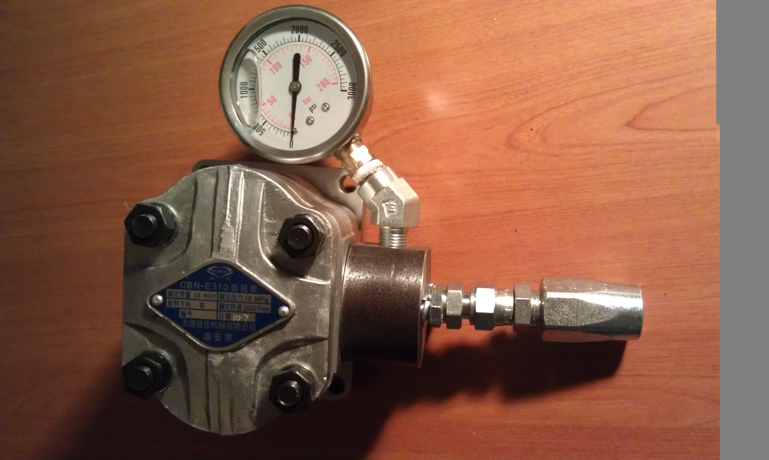

I made up a spacer and attached the gage in the middle. You could sandwich something like this between the normal Chinese hose connector and the pump. The location is not convenient but it's only temporary. Send me an email and I'll send you more detailed photos.
Ronald at Ranch Hand sells an adaptor like this and I believe it's used to convert to JIC, like my home made one.
The tapped NPT outlet on mine is roughly the size of the Chinese flow passage and this allows me to either thread in an NPT or else just sandwich it in between the pump and flanged Chinese adaptor.

The output ports on your control valve should be a straight 18MM metric thread. Into that threaded port is screwed an adapter that gets from that metric port to the O-ring face seal hose fittings used by the hoses. You should be able to buy a straight metric to female NPT adapter. I think it is 18MM X 1.5MM thread pitch, but you can take one of your hose adapters along to match threads. When you get the adater and gauge, you can just screw it into one of your working ports in place of a hose adapter and then send pressure to that port. Put the disconnected hose in a bucket incase you send fluid the wrong way:) and of course make sure the BH is properly supported before disconnecting ANY working hose...
I found the adapters thru my local hydraulic supply shop for about $8... Not specifically familliar with your valve but on my HW-03 BH, it has a single input checkball located directly above the pressure relief valve. You access the ball and spring by unscrewing a large straight slotted screw plug on top of the valve body directly above the relief vlave. If you have this plug, the metric adapter I mentioned above can be modified slightly to screw in place of the plug(same metric thread pitch), and system pressure can be measured at that point also. If you PM me an E-mail address, I can send you a diagram on how to modify the adapter to fit in place of that screw plug. I made a few of these for people a few years back, so there is a thread here with the particulars and some pice of the gauge installed on my BH...
