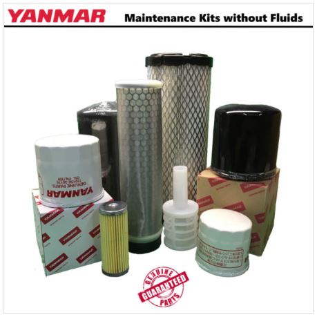

I have a YT359 bought the maintenance kit. The kit comes with one hydraulic filter which looks like the "In Line Filter" from the manual that runs from the rear of the machine to the front. There is another filter that runs from the right side to the left which the book calls the "Transmission Filter". Are these the same filter or are they different sizes? And why aren't both in the kit?

I looked up pictures of the kit on ebay. The two hydraulic filters should be the black ones with rounded edges.
The steering and transmission pumps are separate, hence two filters, and yes they are different sizes. Locate the two filters on your tractor and compare.

The kit I received didn't come with all of those filters. The small black one I got was a fuel filter just above the water separator filter.

I saved the box ends when I did my transmission / steering fluid changes.
Filter Hydraulic #198535-48080
Cartridge Assy. #1A7180-48210
These are both black and are mounted under the frame below the floor board and seat.
I am looking for alternatives from Baldwin and or Wix to see if they can be found outside the dealer network...probably cheaper.
