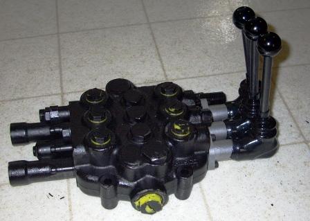

#25
Re: You\'ve warped me!
Some assembly required! /forums/images/graemlins/grin.gif The parts on the floor all came out of one bag; notice there are two more lever assemblies still in the bag. /forums/images/graemlins/smile.gif
Not quite expecting that one, but it beats the heck out of the rest of it that I am expecting. I held it up to the machine, it will fit; that cover will give me some issues, but I knew I'd need to cut it for the levers anyway. Now I'm thinking one large slot instead of holes.
Haven't unpacked the pump yet; hope it looks as good, and fits even better than the valve!

#27
<font color="blue"> For scale, how big are those floor tiles? </font>
7.25" CTC or 7" each square.
Assembled; it looks pretty good. The paint on the plastic caps peals off and gets all over, but I doubt enough got into the valve to hurt anything. If anything did get hurt, it would have been while I was tapping the roll-pin into the spool; should have used a press instead, but that'd been to obvious. /forums/images/graemlins/tongue.gif

#28
Assembled.

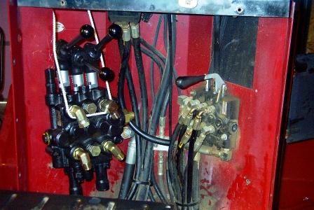

#29
This really tells the story. The dentened postions are sweet! I have not idea why, but between having the control of a mechanical valve and the feeling when you it "kick" into the detent; the whole thing just feels "macho" compared to the switch....and I haven't even put the hoses on yet! /forums/images/graemlins/grin.gif
It would have been nice if it was a bit smaller, like the 2 spool I was originally looking at (which was smaller in general too; not just the 1 less spool), but I couldn't pass the bargain on this one; especially knowing if I did, I'd want the 3rd spool sometime.
Notice it is much larger than PT's, but this one needs twice the flow rate as the loader, so I don't think there is one of that size that could have worked.
Afraid the cowling might have to disappear altogether, but I'm open to suggestions! /forums/images/graemlins/smile.gif

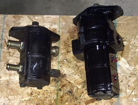

Old pump; new pump
One pump; two pump! /forums/images/graemlins/grin.gif
