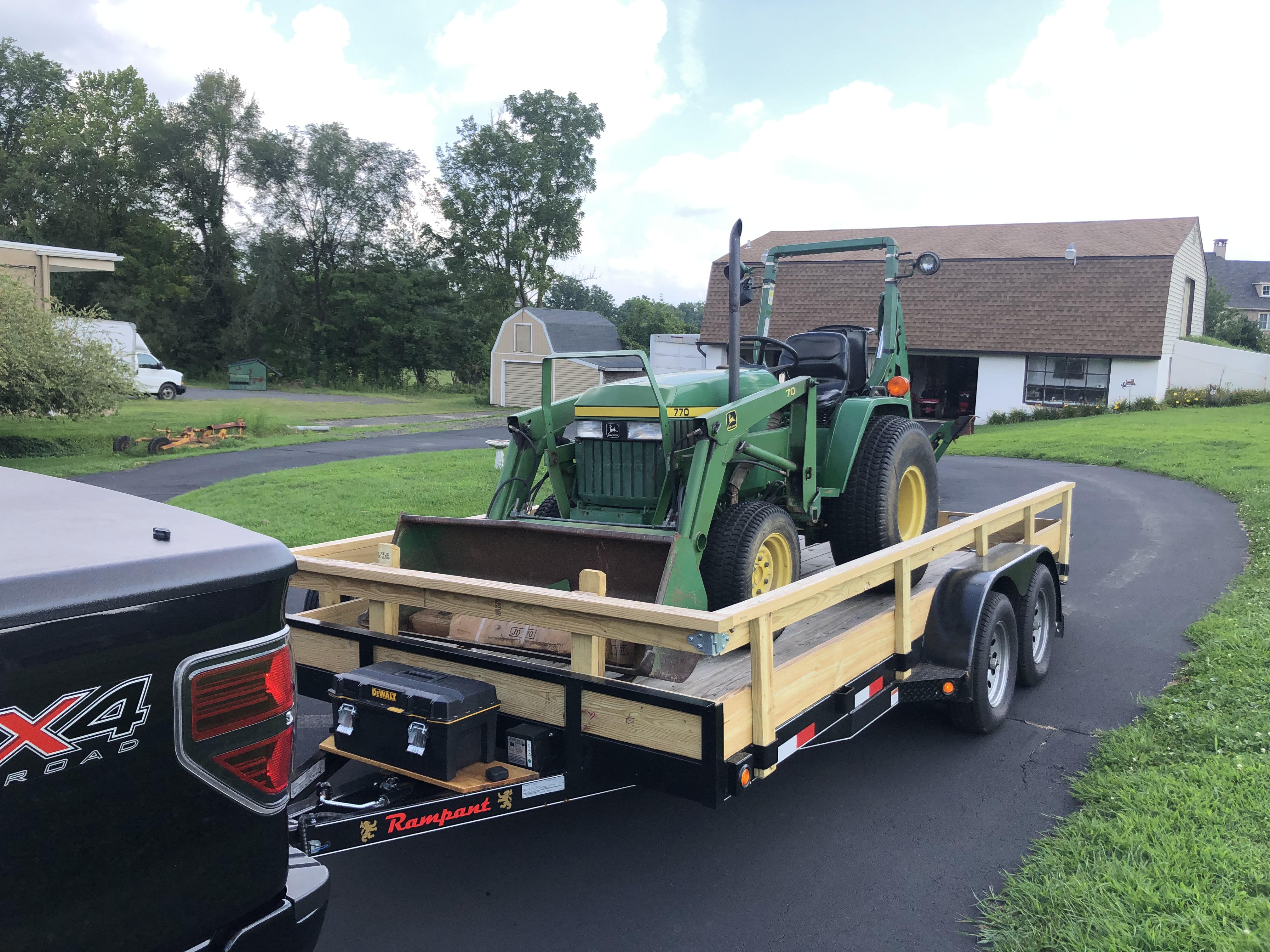

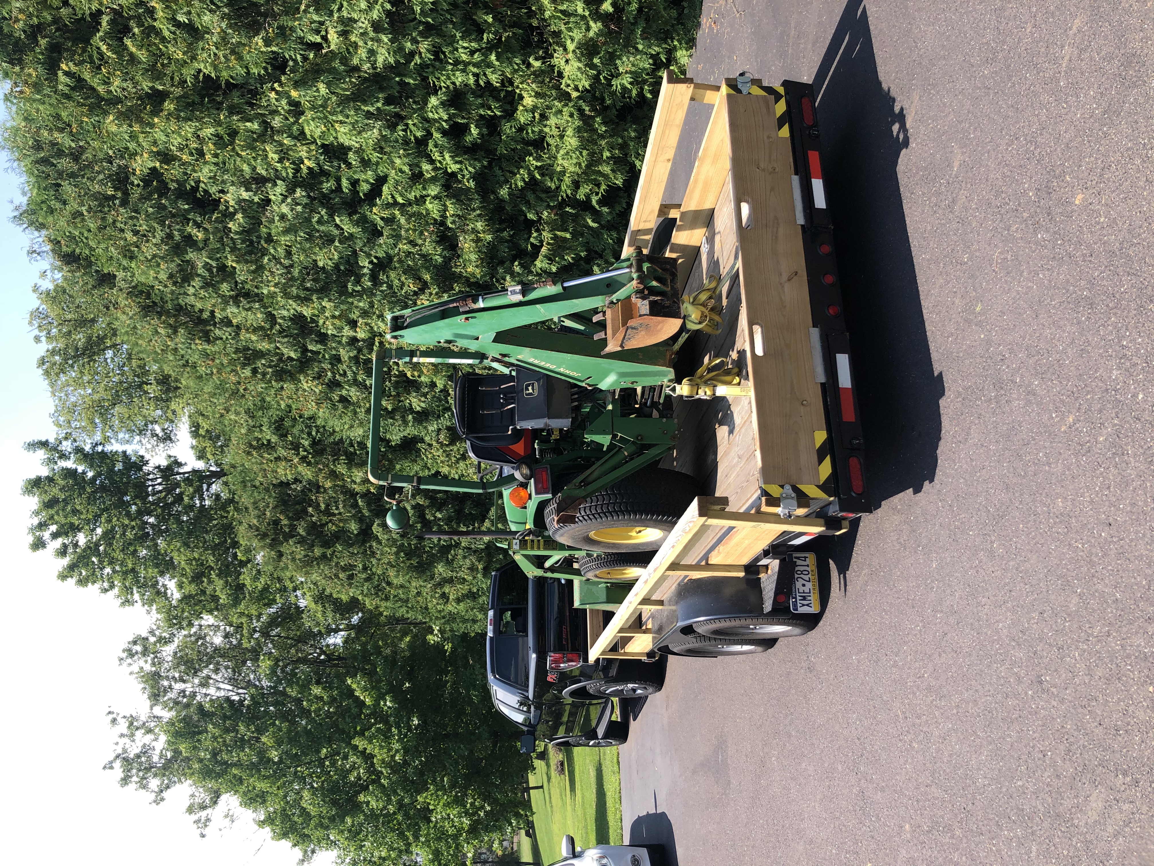

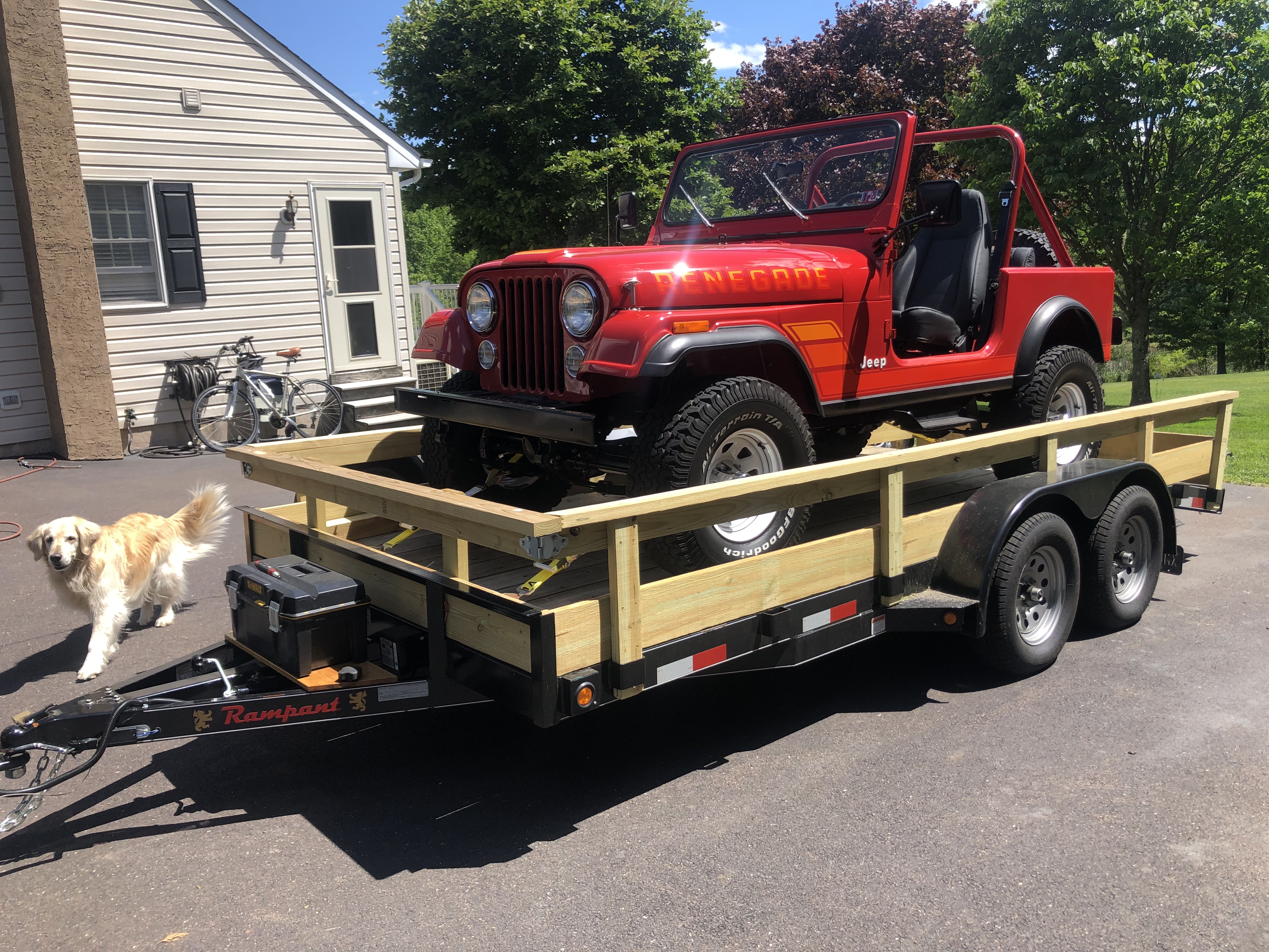

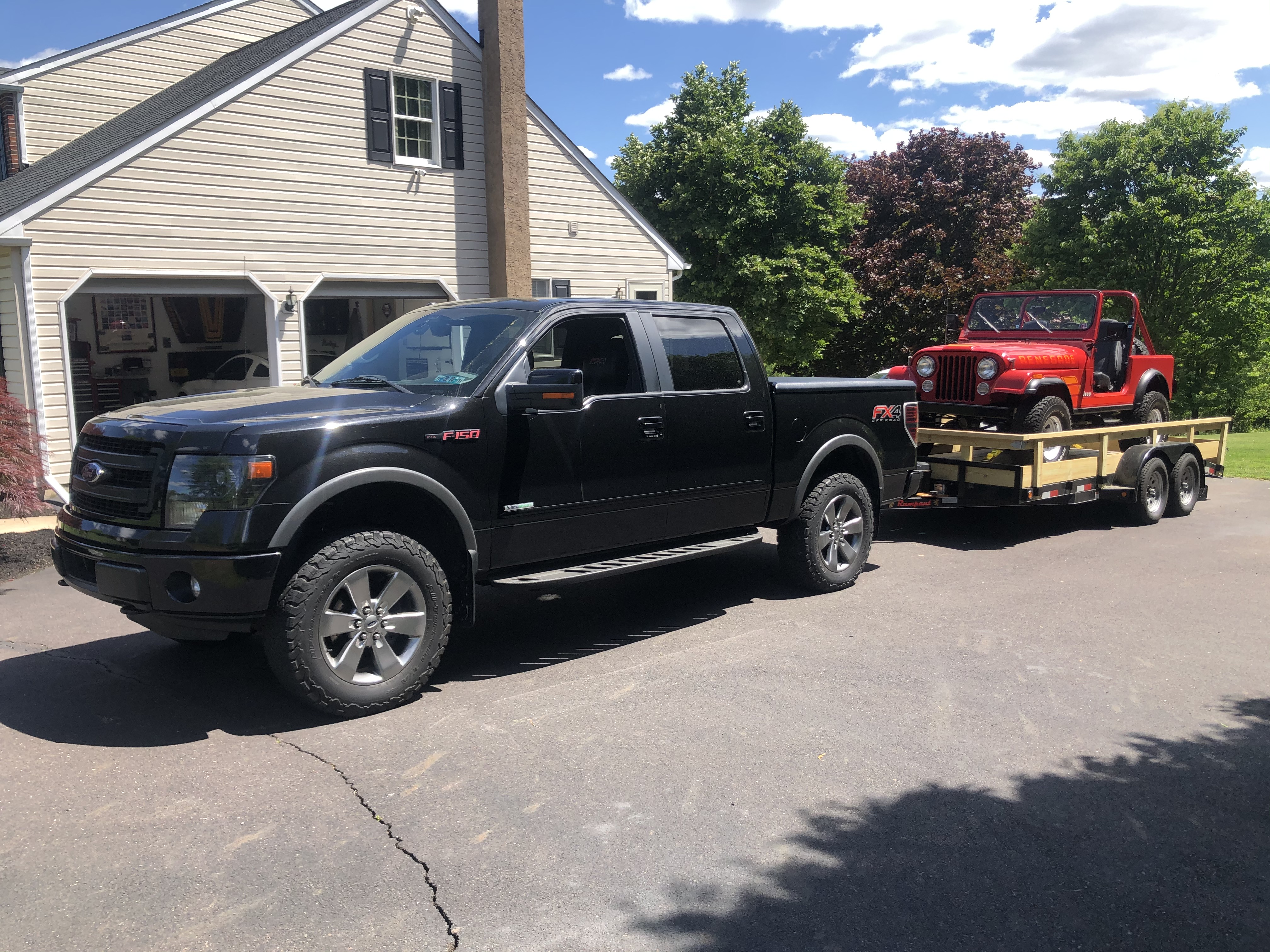

Recently bought a used 1989 JD 770 with 475hrs on the clock. My 2013 F150 pulls it nicely with a 16ft dovetail trailer I have from Rampant Trailers in NC. Use the trailer often pulling large supplies and my Classic tagged 1984 Jeep CJ-7 I've owned since new.

Nice looking setup. It looks like you spent some time on the trailer getting it setup the way you want, very nice.
