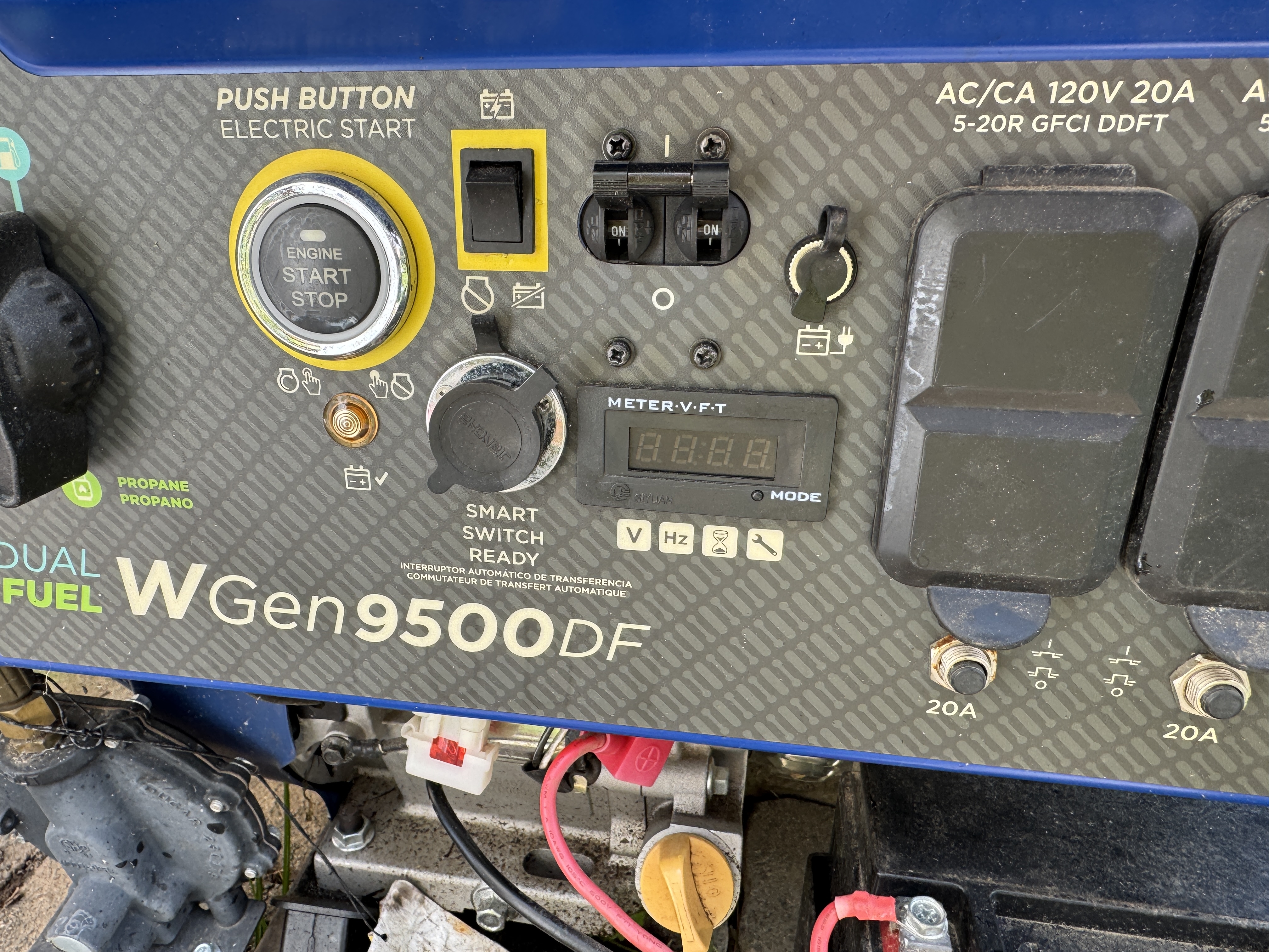

no joy this afternoon on a test
light under start push button should light up when rocker switch turned to on.
Doesn't.
won't start manually.
am thinking bad rocker switch, sprayed some contact cleaner in, no joy.
hoping a friend can take it apart tomorrow and we can determine where power is stopping.
there is a big blade fuse on the starter and that was fine.

Did you check the oil level?
   / Your last generator Maintenance Run #7,739
thanks, I did. Nothing loose, oil at full level
will check again today

what I am going to do after watching several YT videos is disconnect the low oil sensor.
apparently engine runs just fine with it disconnected and that part is known to fail.
The yellow wire is easy to find, just need to trace it back to disconnect plug.
not impressed with rust resistance on this unit, granted it's been outside for four years but has always been covered.
looks like I need to wipe down some of the front panel hardware with oil.
I do inspect the receptacles and have plugged and unplugged the 50 amp cord,plus DeOxit.
And I use a plastic/metal protectant on the frame.
but the rust around the push button breakers is unfortunate, likely due to our wet Spring here.
