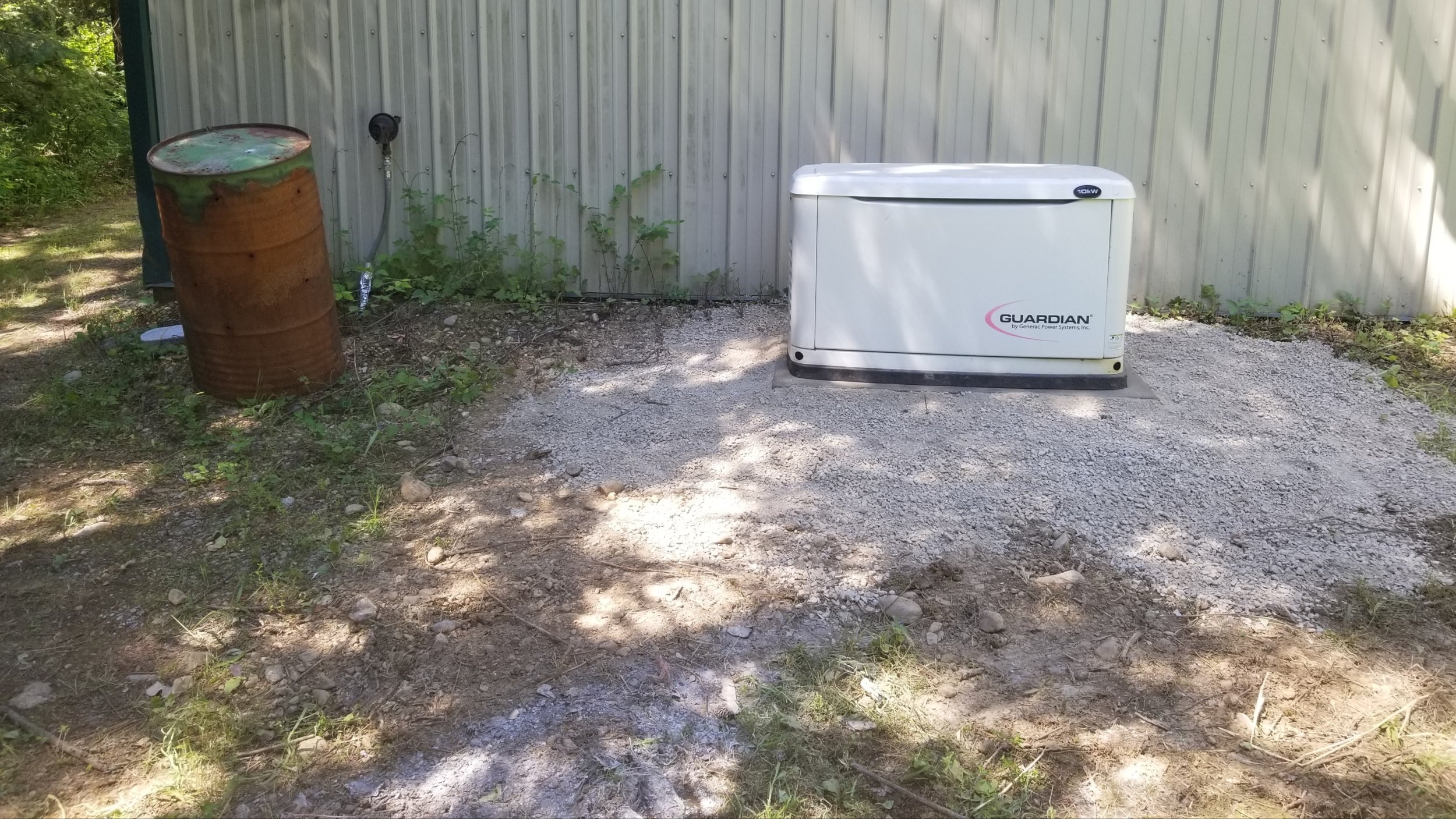

after 2 years of looking at a 2008 era 10KW generator sitting on the floor of my shop, i decided i really dont trust selling such an old machine. it was lightning damaged. all internal control wires melted together. i repaired it a few years ago All new wires, new mags, etc. it runs great. fires up in 2 seconds. It has 580 run hours, but is strong running.
but i was tired of looking at it gather dust. so last week i poured a conc pad behind my shop and set generator there. it will power my shop during power outages. i usually get called out for service calls during power outages, and my shop has a 12' x 12' roll up door...not sectional. it SUCKS to manually lift that beast. i used to have to roll out the 6.5kw portable and power the shop to open door, use lights, etc.
i will convert this generator to a 2 wire start switch. it WONT auto start on power outage. i will just use my existing manual transfer switch. i just have to remember to run an exercise monthly, as it will no longer be automatic.
I also ran 1” emt in shop to panel about 40’ away. Will pull wires wednesday.

Nice save g ! Good benefit to you, and one less thing going to scrap...... (y)
A thought, for anybody who is in a similar position (excess healthy equipment, looking for a home) - consider contacting your local (or, not so local, if nothing nearby) Amateur Radio Club.
Hams love to recycle, and there are often Nice To Do, If....... projects on deck with them. Last year, an AR Club I'd never contacted before (other end of Canada) went FAR out of their way to help me put a programmed radio into the hands of an ailing friend of mine.... so something a State/Province or 3 away is often Not Too Far a drive for them......
A retired friend of mine runs an HF Gateway (digital AR) but has no backup power to speak of for his station @ home, as one example of a pending-project...... Hams are smart enough (usually) that for a recycled ("It's fixed, but......") item from a major fault, they'd understand the risk, and more than likely use it to just charge a battery-bank regardless....
