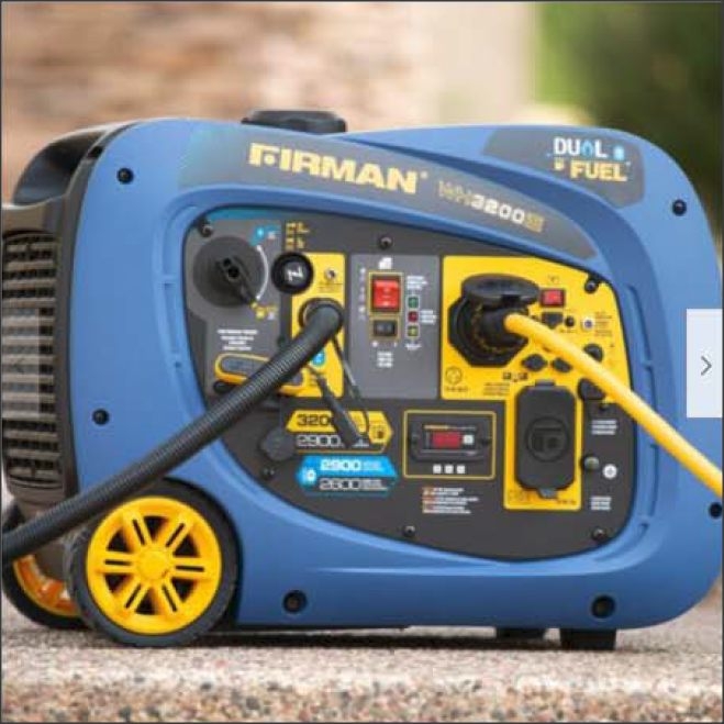

We had a six hour power outage last month during unusual for us, 14*F temperature and winds up to 55 mph.
Our Firman inverter dual fuel 2900 / 2600 W running on LPG did very well, and was easily able to power our needs.
IE. Running two refrigerators, three freezers, fireplace insert fan, kitchen lights, toaster, coffee maker, modem, router, Wi-Fi, couple of computers etc.
Obviously you need to pay some attention and not put toaster and coffeemaker on together at the same time while everything else is on.
It certainly is a big compromise and does not compete with a large full house generator, but it seems to work fine for us, since we do not get many power outages and usually our winters are pretty mild.
Based on my observations, it should run 24 hours on a 30 lbs propane bottle.
PS.
I have 8 kW low Rpm noisy Diesel generator in case of extended outage, but am reluctant to use it.

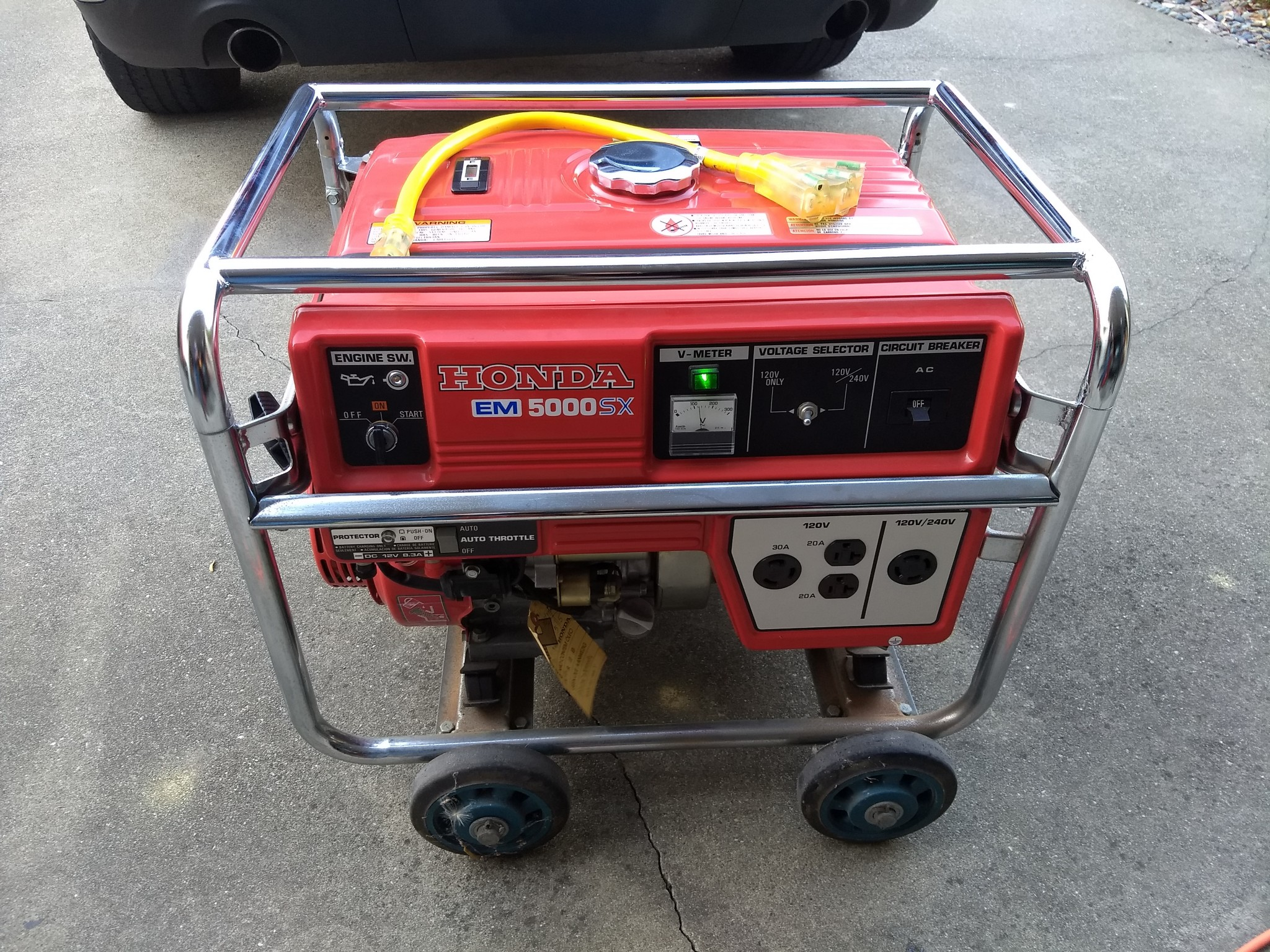

My 1990 Honda EM 5000 has served me well... powered essentials at 4 household during the extended power safety shutoffs.
The key was staggering the load so it all doesn't hit at once... by that I mean powering one or two refrigerators for 15-20 minutes before adding the next and so on...
I highly recommend quality 10 gauge extension cords when extending power to neighbors!
My log is 183 hours so not much and I do use stable marine for the fuel... It's kept under cover in the garage and chained and padlocked when in use outside.
Fuel on hand is rotated every 6 months.
The chrome gives it the classic look of a bygone era.

that's a nice looking Honda.
