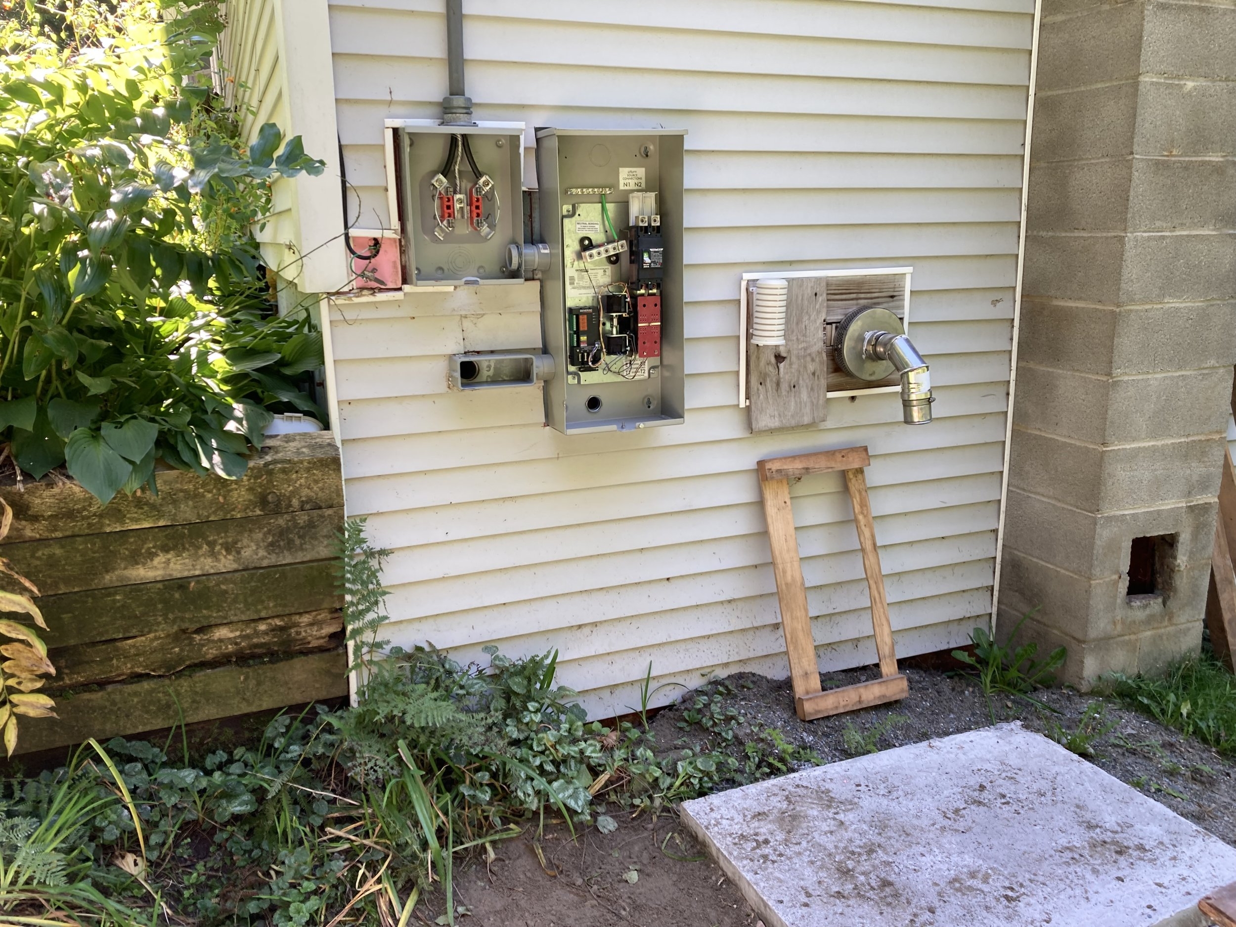

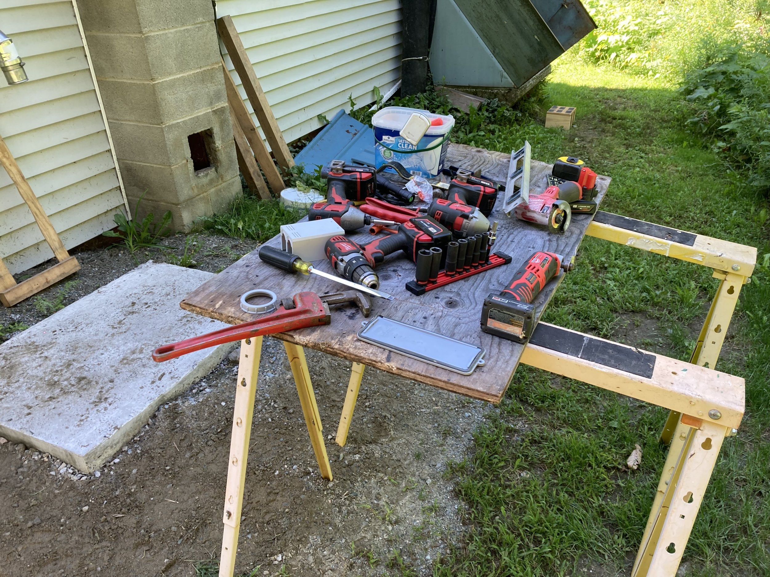

I just installed a whole house standby LP generator last summer. I had been using a portable generator for over 15 years and decided to replace because I got tired of trying to going out and pulling the starter handle. My very first run of the new generator happened in late fall and the generator ran for 47 hours straight……was SO happy that I had installed it. For the 47 of run I calculated that I used approximately 30 gallons of LP gas, well worth it in my opinio.
