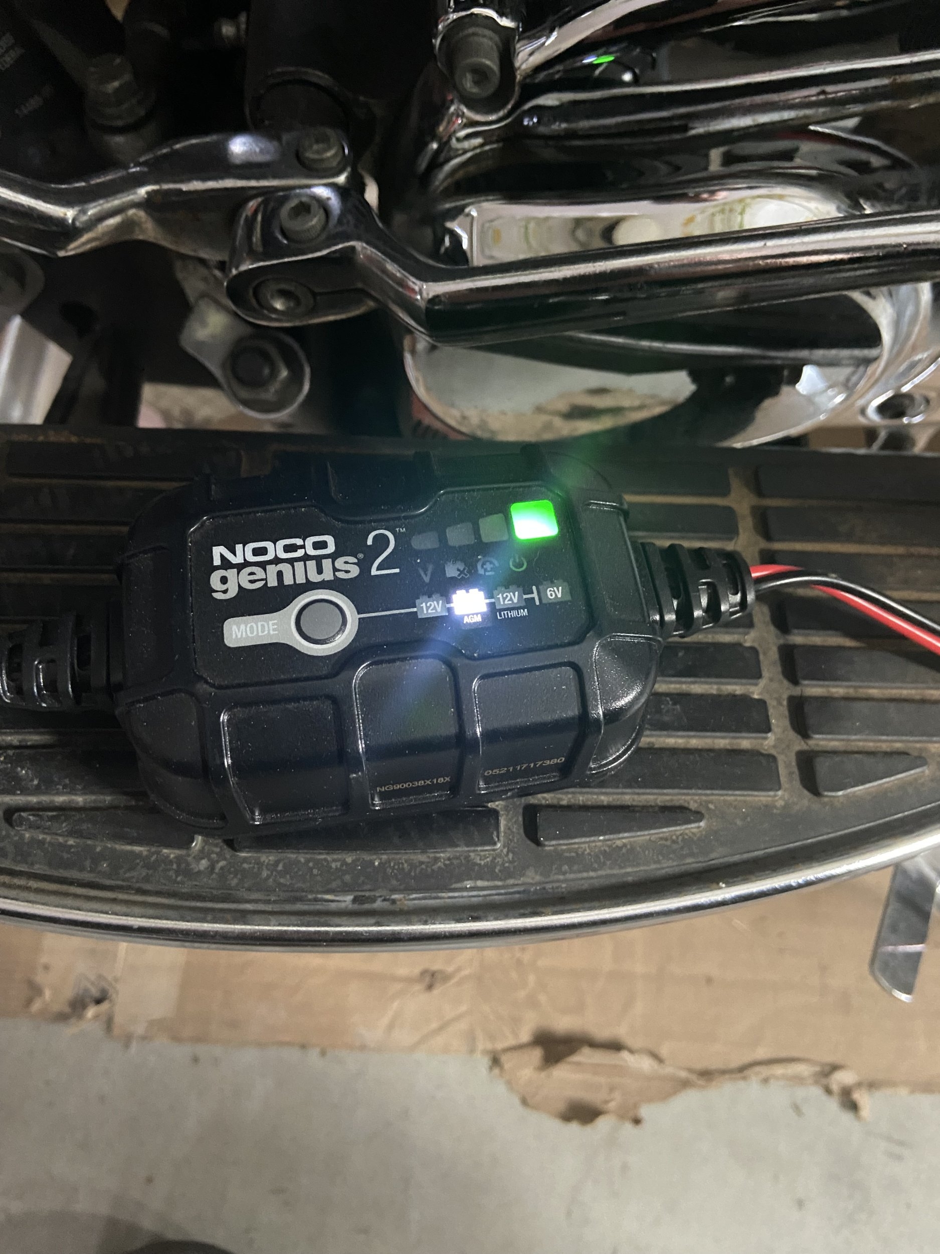

Most of mine are NOCO as pictured on one of my Harleys. But others like Schumacher, OptiMATE, Battery Tender, etc View attachment 842086but regardless of brand make sure that they are SMART maintainers.
Robin great information.
I have been using the Battery Tender Brand on all our battery start equipment and toys that do not get used weekly throughout the 4 seasons. 1 Auto, 1 Tractor, 2 PWCs, 1 Motorcycle, 1 Diesel Generator, and a 1 ZTR Mower. Fit all with quick connect fused lead to battery terminal lugs.
The Battery Tenders are various models from 3/4 amp, 0.8 amp, and a dual unit with 1.25 amp for each side.
We keep the Battery Tenders plugged into the 120 VAC receptacle 365/7/24 and only disconnect the 12 DC quick connect output going to the battery when using the equipment. (We do not disconnect maintainer on the diesel generator when doing monthly generator checks even though it also charges the battery when running. The maintainer monitors battery voltage and stops charging when the engine charge circuit is active above iirc 13.7 VDC).
We use good quality AGM and Flooded Lead Acid Batteries. All are "maintenance free" that do not have access to fill with water. The batteries on maintainers seem to last 10 to 17 years before needing replacement.
I got tired of changing batteries after 3 to 5 years, so started using Battery Maintainers with good success. Make sure to use good units that reduce the current when battery is at full charge so you do not damage the battery from overcharging. Most of our equipment and toys are not used from November thru April. During non-use periods, the battery internal discharge over time combined with some of the equipment that have a small current drain from engine control modules (ECMs) keep reducing the battery state of charge which reduces the battery service life over time. Likely if you are using the equipment each week throughout the year long enough to keep batter fully charged you will not benefit from a maintainer.
Some of the maintainers are over 20 years old and I have never had to replace one yet. I like the added battery longevity when using maintainers.
Some day I should calculate how much electricity it takes to keep the 7 battery maintainers on 365/7/24. I suspect it is still much less expensive then replacing batteries often. Good batteries are not cheap.

Noco seems to be a good brand, but I haven't been impressed with their Li jump-pack I bought - haven't done an instrumented load-test on it, but doesn't seem to have the cranking amps expected. I have spec'd something out of their commercial charger line @ work, which I do like.
Rgds, D.
Correction - that is a Schumacher Pro line charger I selected @ work.... checked on-shelf last night, twas long enough ago that I bought it, that my "perfect" memory wasn't working :cool: .
The performance of that unit, lead to another dual charger being bought from that line - does a good job of maintaining 2 group 31 agm independently, for 24v boosting applications.
