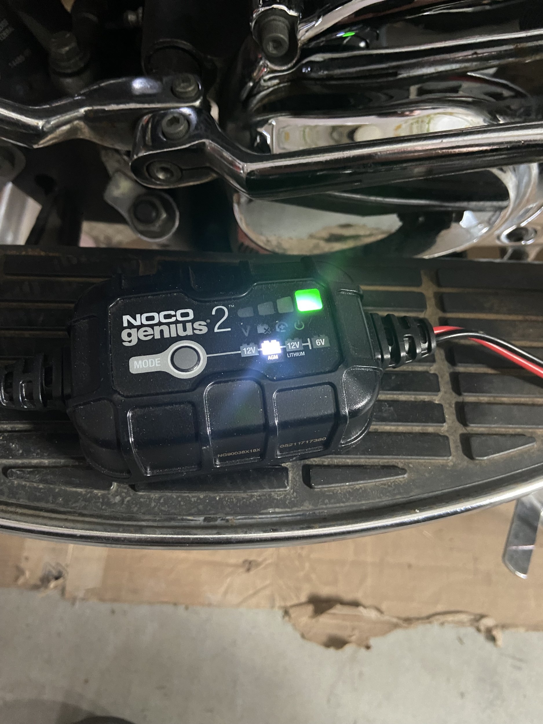

Most of mine are NOCO as pictured on one of my Harleys. But others like Schumacher, OptiMATE, Battery Tender, etc
but regardless of brand make sure that they are SMART maintainers.

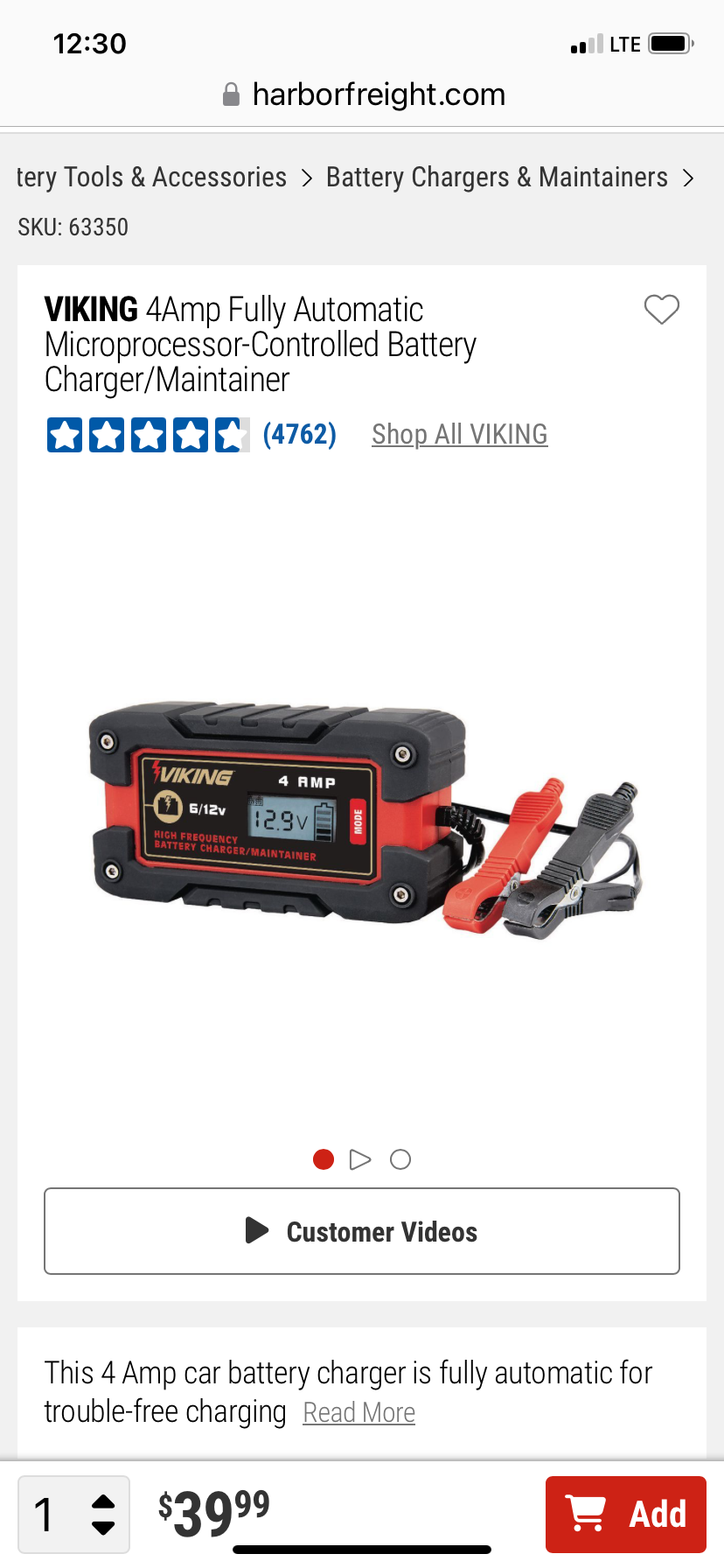

ps…. I have this Viking maintainer on my tractor that is stored in an ambient temperature but dry shed. I bought this about 5 years ago because it has a winter setting. Perfect for my tractor as it keeps the battery warm during the winter season as a bonus!! One downfall of many maintainers is that they stop working/charging when temperatures drop to about-20C. My one gripe against NOCO, but atleast they publish that in their description 🥴

Most of mine are NOCO as pictured on one of my Harleys. But others like Schumacher, OptiMATE, Battery Tender, etc but regardless of brand make sure that they are SMART maintainers.
Maintainers are probably worth an entire thread alone; obviously relevant to any engine, but esp. sitting-idle gens.
Like your list, I prefer to stay away from mystery brands for long-term maintenance hookups..... esp. with electronics on-board, there is not much choice about using a maintainer, but short-term regulation and long-term reliability are a concern.
Noco seems to be a good brand, but I haven't been impressed with their Li jump-pack I bought - haven't done an instrumented load-test on it, but doesn't seem to have the cranking amps expected. I have spec'd something out of their commercial charger line @ work, which I do like.
Speaking of Harleys... neighbour that I ride with, asked How Long Do Chargers Last ?.... good question, but I mention it more re. any of them could use an independent check with a known-good voltmeter now/then.....
A selectable Winter mode is nice...... mimics the Temperature compensation built-in to Alternators.
I had a Winter mode on a weatherproof Ctek that I used a LOT.... enough so that I wore out the mode-select switch.... probably just needs me to find the RoundTuit, and source a pcb-mount switch to fix it....
