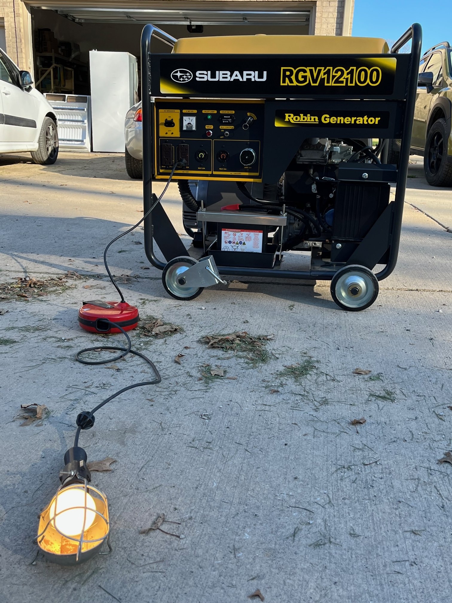

Ran this unit for an hour yesterday after @5 months. Started up with no issues.

I’d say you’re lucky. Better to run it sooner/oftener if possible. The last thing you want is to find out it wouldn’t run when you need it to. 😉

You’re doing things right for sure. I just got the sense that the previous poster was bragging about how well everything went, with no mention of any kind of plan. See how he exercises that big generator….with a lightbulb?

We do have a Eaton branded 20KW whole house generator; this one automatically exercises once a week (also without any load). It did come on about two months ago when we had a power outage for a couple of hours and worked well. The 12K Watt peak and 9.5K Watt continuous rated presently defunct Japanese built Subaru is a highly regarded unit, and is a pure back-up. The check interval was extended this time due to move related issues. Next test will be sometime early 2024. I start is up every couple to three months typically and never had any issues. It is also on a good diet of ethanol free gas.
The last post which alluded to my bragging failed to note that the lamp used was a puny 7 watt equivalent LED bulb. It was turned on and off at @5 min intervals and the idle down feature of the generator worked flawlessly each time the lamp was turned off. The voltage regulation of the generator is exceptional and the "same" puny LED lamp has been utilized mostly when exercising the generator, other than a few occasions where two 1500 watt heaters are plugged in for additional load.
Separately, the generator is equipped the same Yuasa 500 CCA AGM battery I had installed when I purchased the generator in 2017. Due to routine maintenance, I don't typically have issues with my vehicles including lawn/garden and power equipment. They work as intended, touch wood!

Nice wattage/coverage.
Find a protocol that works for you; stay with it till it doesn't.
Gasoline is a big variable. W/O going to racing gas etc, e-free has pretty much been wiped out here, in the last year :((n)
