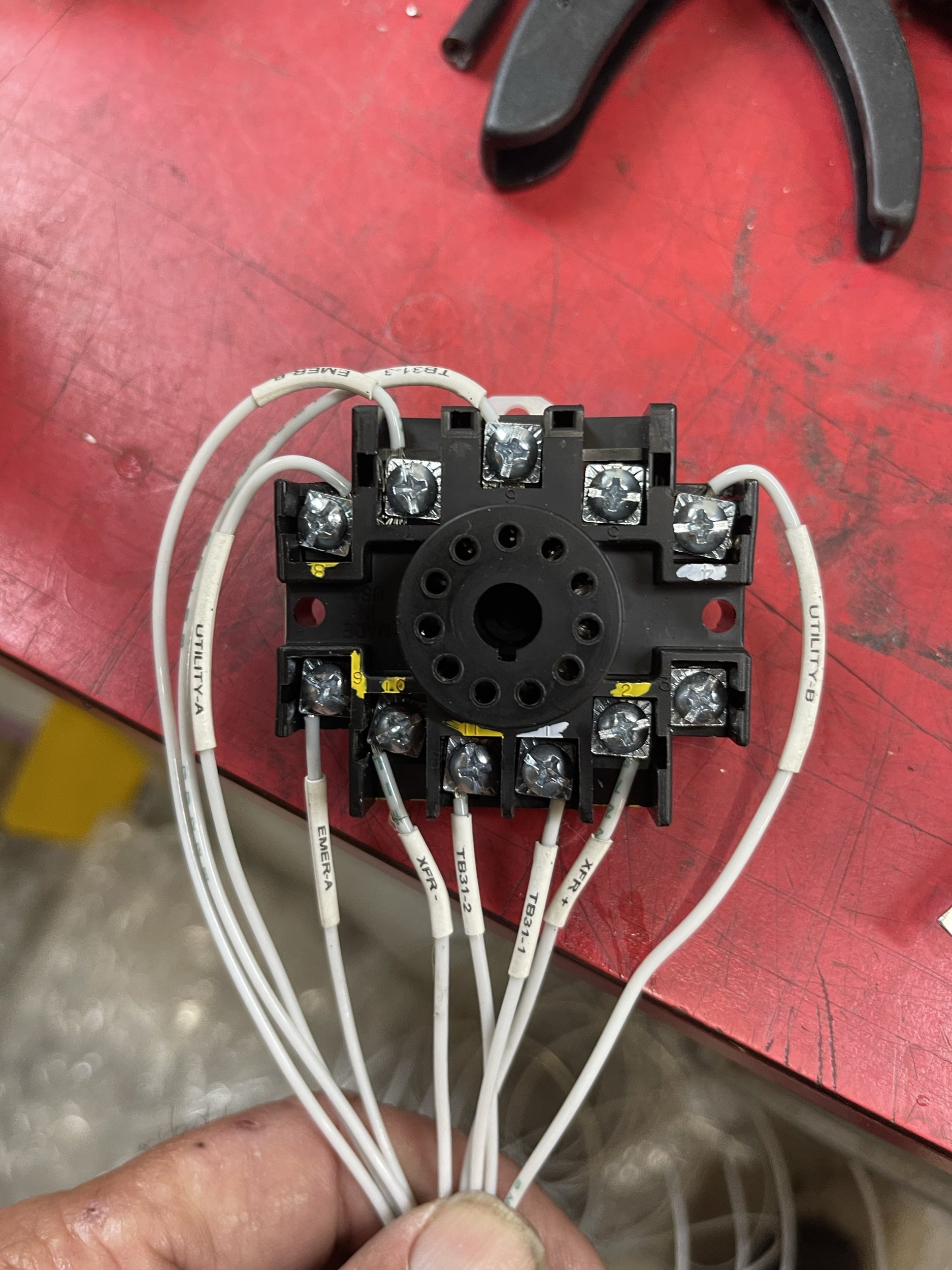

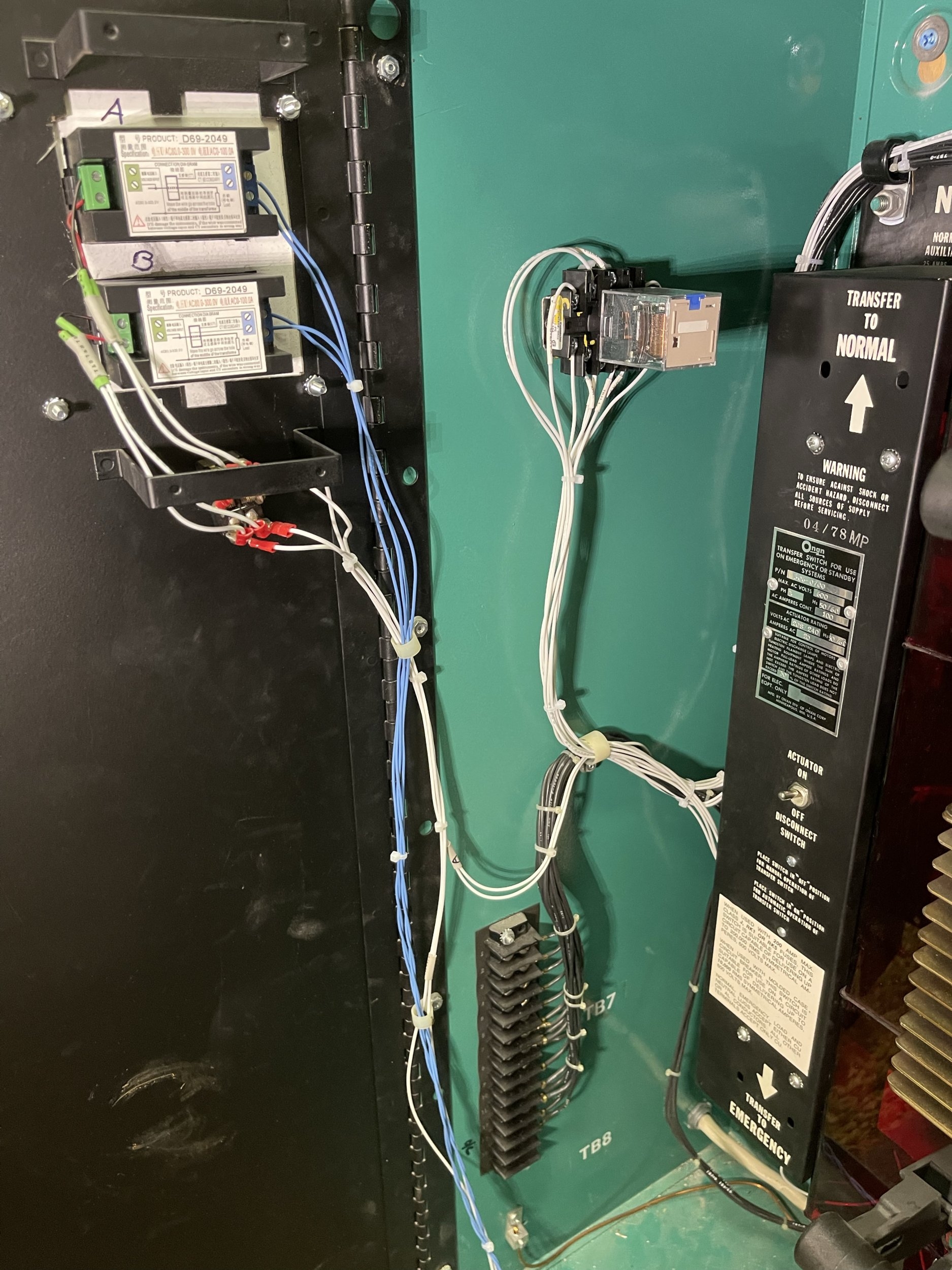

All done.
I had a 3PDT relay with A 12vdc coil, socket and DIN rail, so it was off to the races.
Here is the relay and the socket wired up-
Here it is installed in the switch-
All of the white wiring was added.

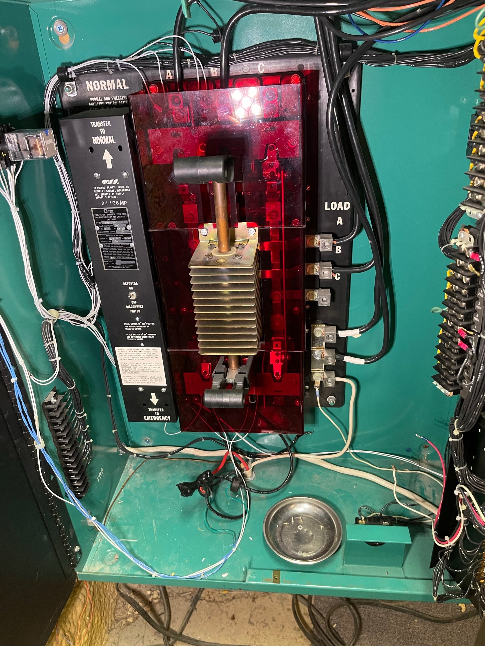

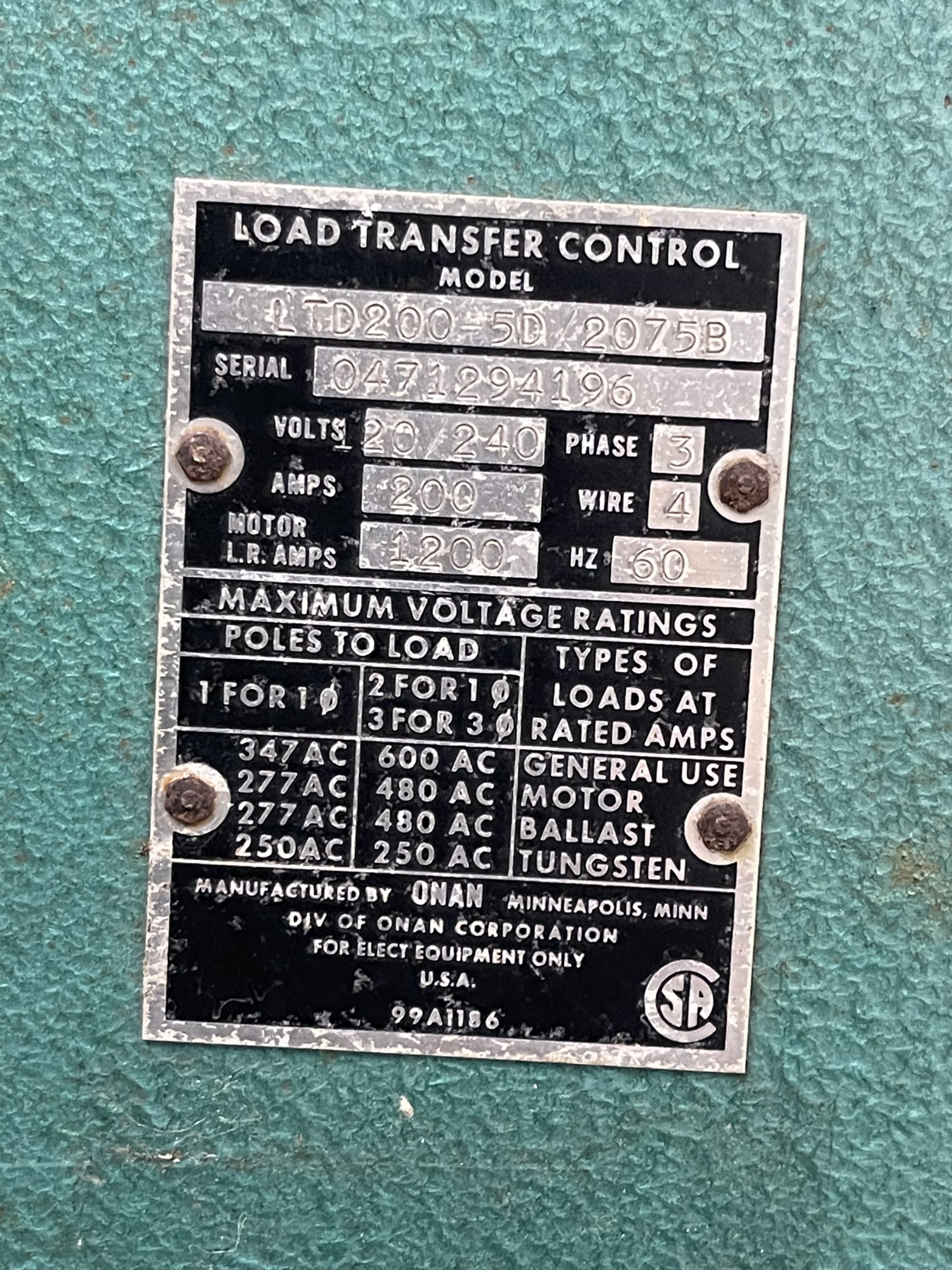

And if you aren’t familiar with an Onan OT switch-
This one was a 3 phase model that i converted to single phase when I installed it at least 3 decades ago. I used it because I had it left over from a job that canceled.

why is the main copper bar heatsinked? I am not sure I understand why that would get hot, is it because the actuator stays active and gets hot?
   / Your last generator Maintenance Run #6,226
I don’t think it’s actually a heat sink. It draws less than 1 amp of 240v, and is energized for less than a second to make the transfer, it opens a switch at full stroke that cuts off the power to it.
It does actuate with authority, I’m wondering if it increases the magnetic field.

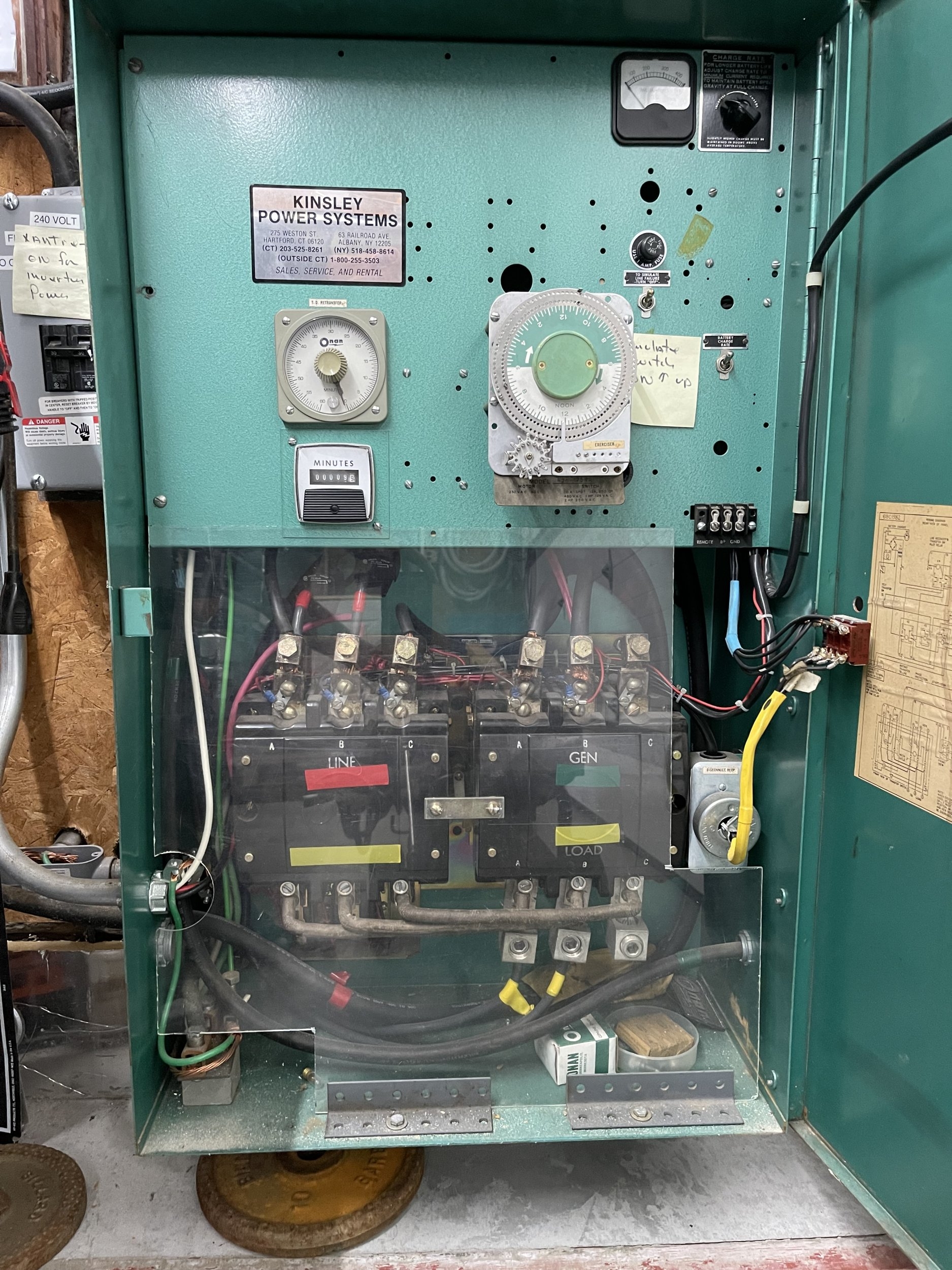

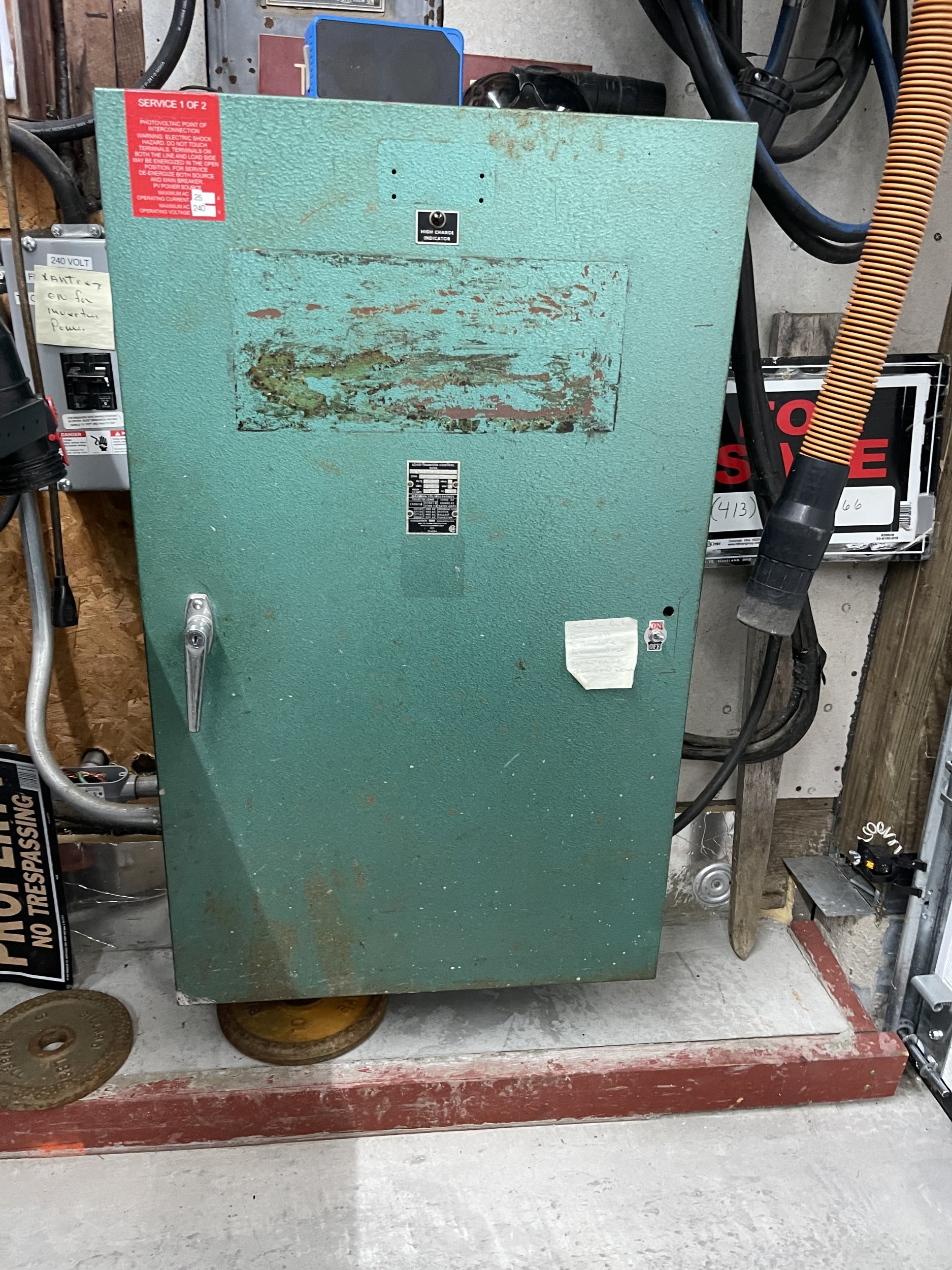

I also have an OLD Onan 200 amp 3 phase transfer switch in my house. I also use it on single phase.
It came out of a local college years ago and is old school technology.
When it transfers from line to gen or back it’s a loud clunk.
Not much to go bad in there.
It has an Anderson full power plug for my 24kw PTO generator if I need big power.
Another backup for the backups backup, backup.
