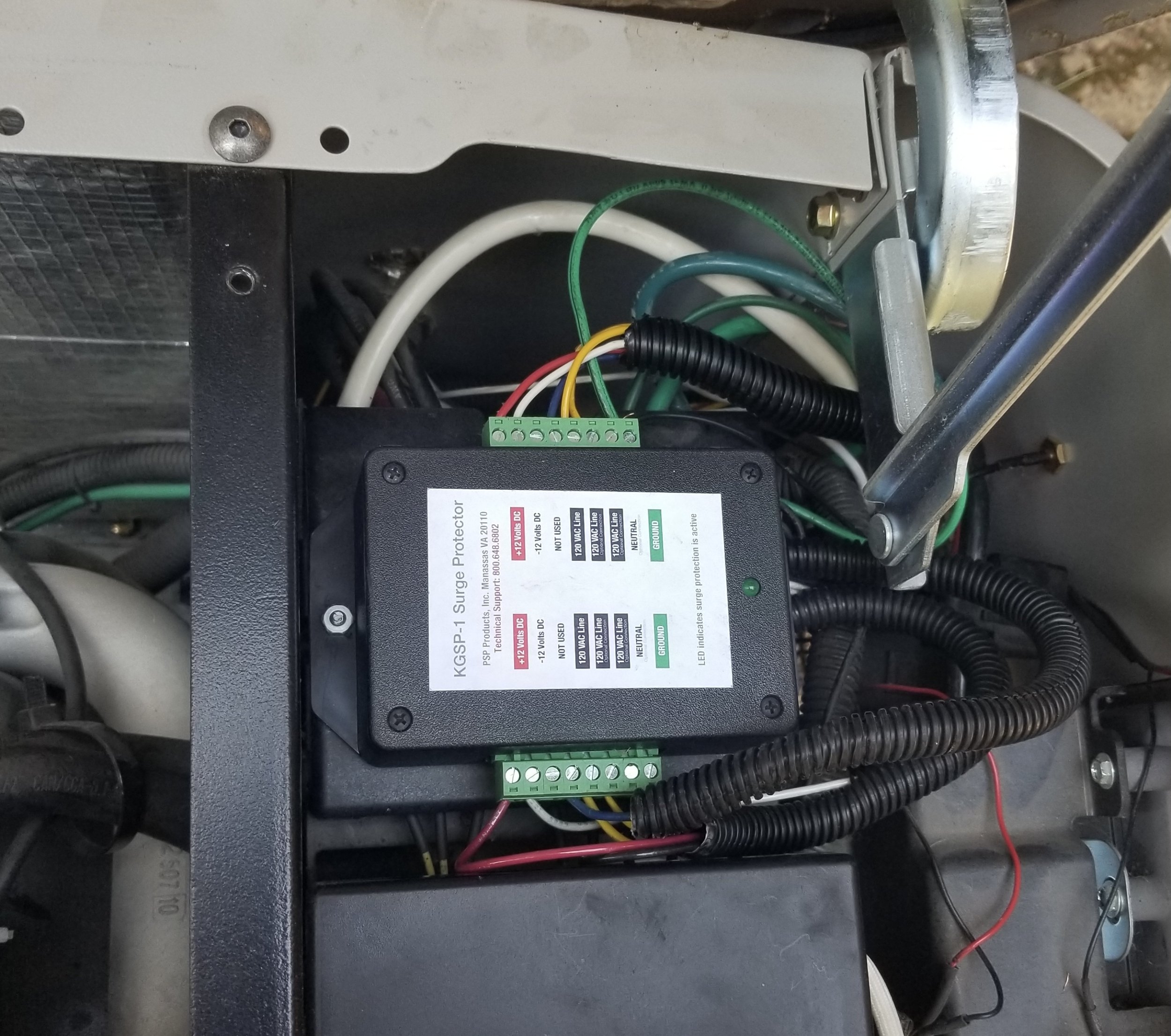

i just added a surge suppressor to protect the control wires on my generator last week. the power side already had protection.

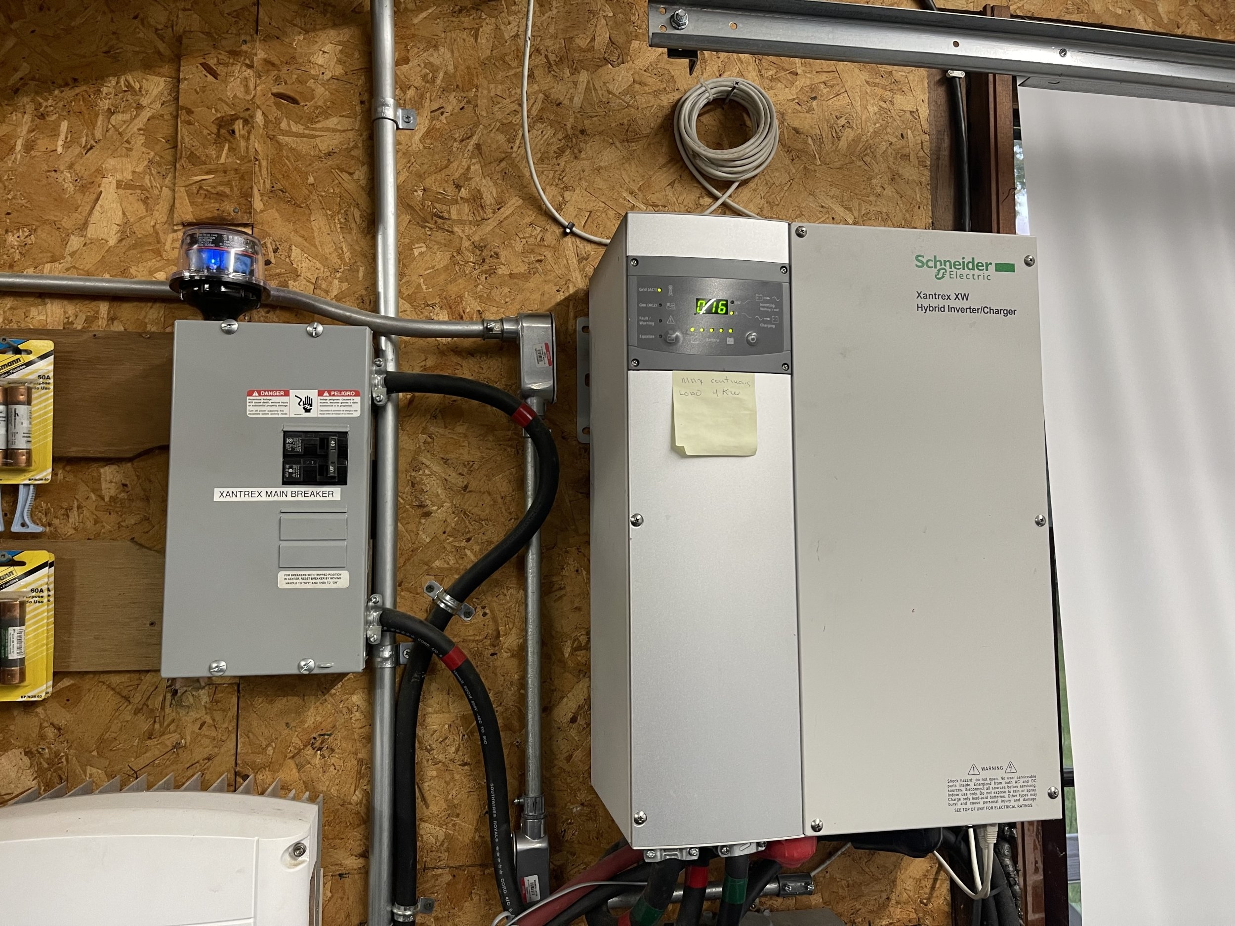

What brand surge protector do you recommend??
I installed (2) MidNite surge protectors, one for the entire house on incoming line and another for my Xantrex inverter.

The nice thing about the Midnite surge protectors is when the led light goes out you know it has done its job and it is time to replace it.
Good quality protection.

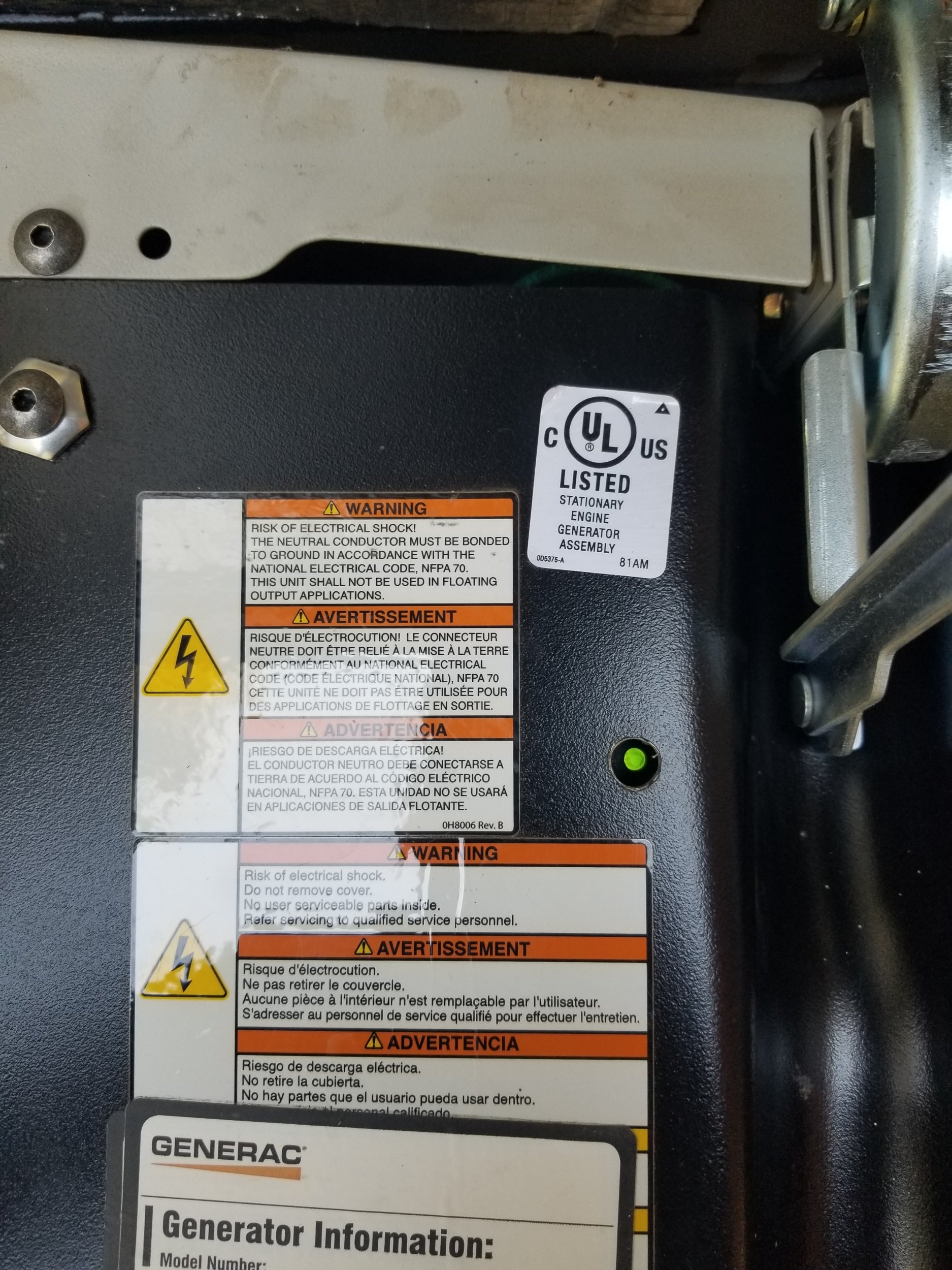

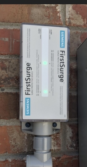

I have Siemens First Surge 140K suppressors on house and shop, and i installed a PSP Products control surge suppressor designed for generator surge protection. I ordered a plastic view port to cover green alert light.
the first surge has 2 green lights when functioning. The one pictured isnt mine, mine is indoors.
Thanks for the confirmation!!
It’s good to know I made a good choice.
