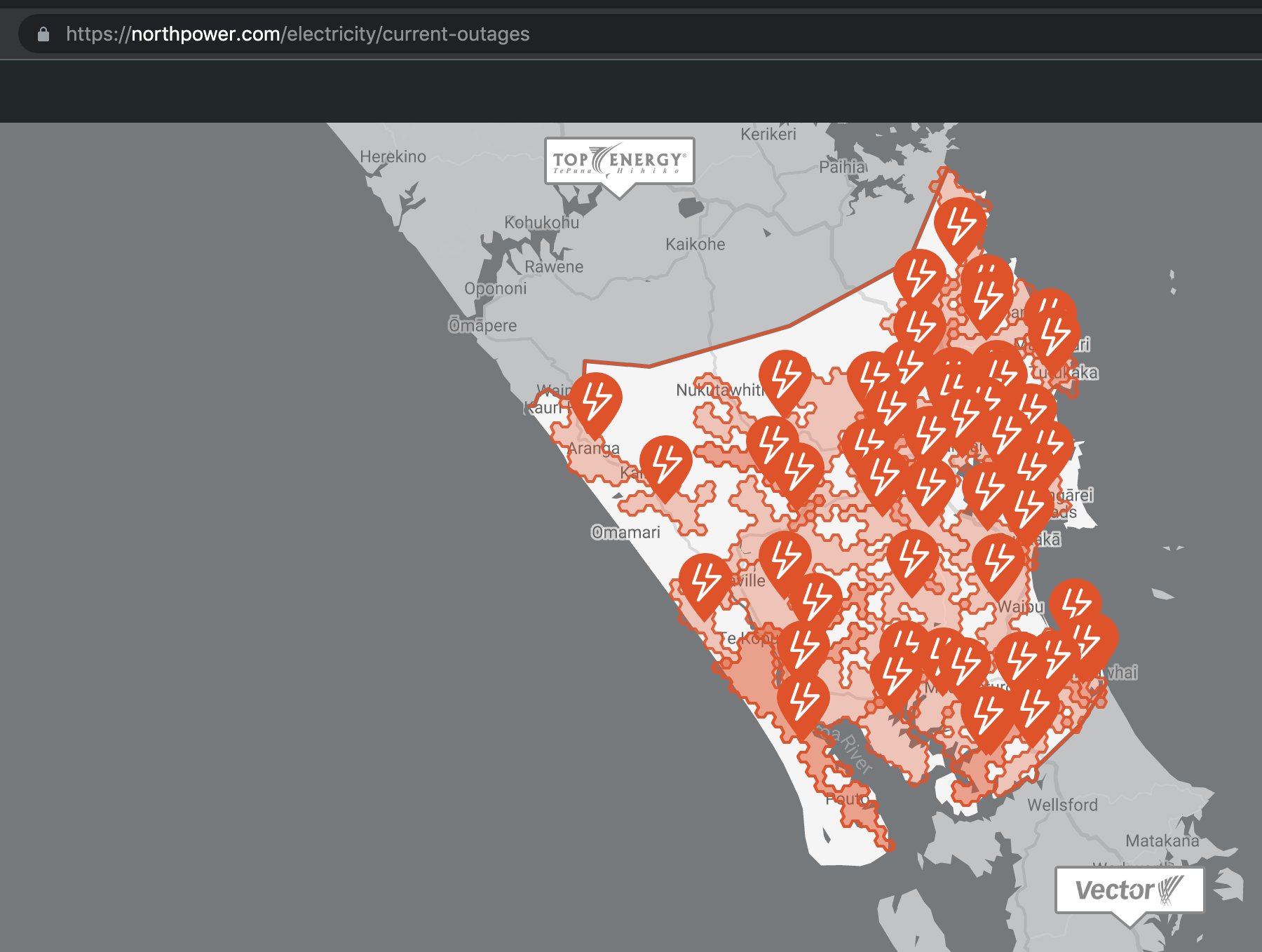

Incoming cyclone generator preparation report: Two smoke shoe box didn't want to run, crud in the fuel filter bowl and carb plus mason wasp nest in the air intake. Running ok again after cleaning. Used a heatgun as a test load.
Wind is just starting to freshen here, we have strong wind and heavy rain warnings. Nothing like what's going on up north: Attached image shows outages for one of the networks north of Auckland city.
