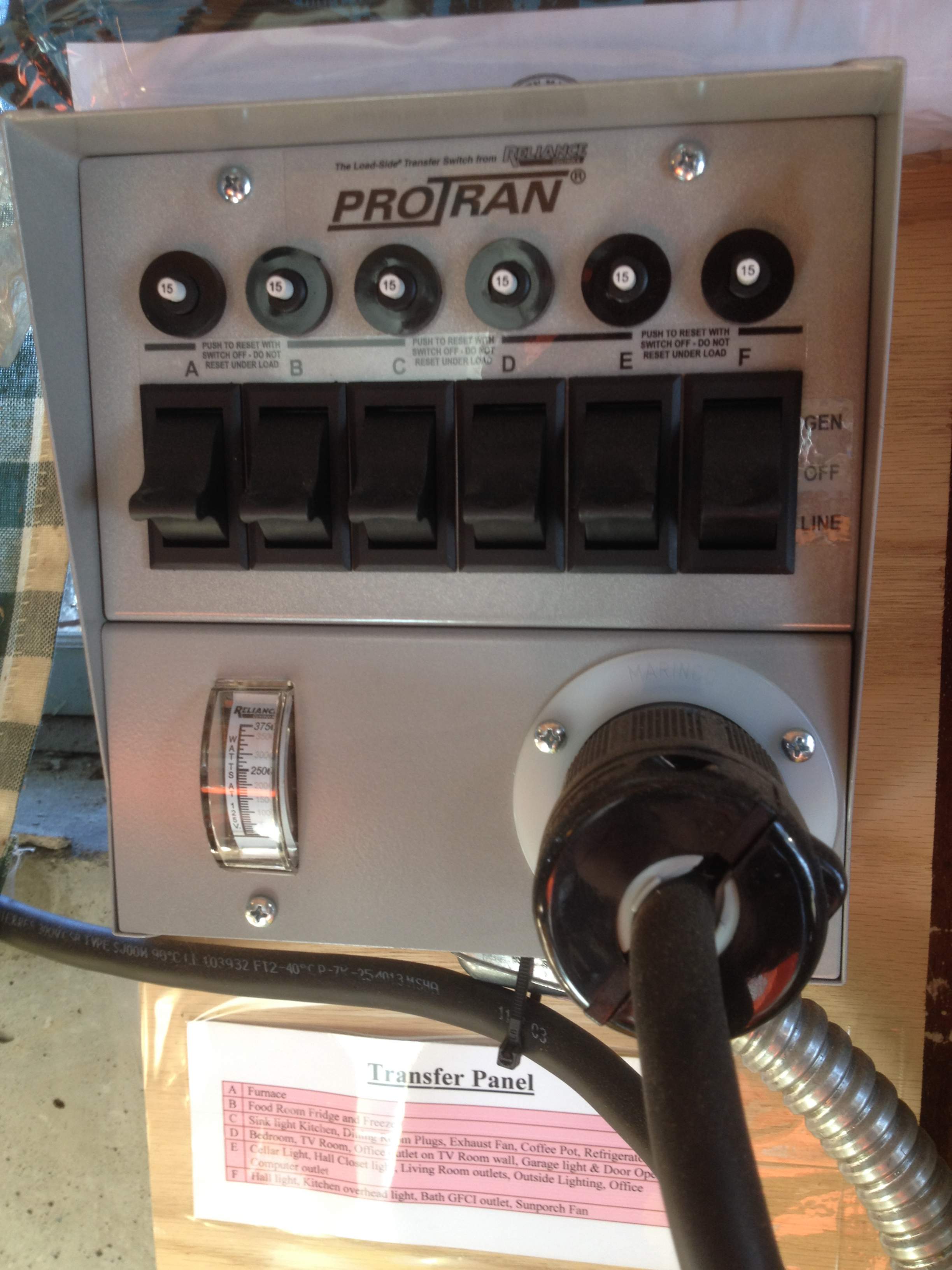

You are opening the main breaker as part of the test and practice to ensure your Mrs can start and load everything ?
Or the main breaker has to opened when ever one or both of the generators are being used with the six circuit panel ?
I am opening the main breaker to simulate the failure of the power grid. Once she gets everything running, she just flips the transfer switch box's six switches from Line to Gen, and each power up. In the case of a 'real' power failure, I would not touch the main breaker panel. I would switch the six over to generator. When the power comes back on, certain lights on non-generator enabled circuits will turn on, letting me now to switch back to Line in the transfer panel, and then power down the generators. Quite a seamless and easy way to switch in/out the generators. 272.jpg

Thank you for the update . Myself and most others are pleased and feel better knowing the generator is properly connected . There are some really dangerous people out there who flip main breakers and back feed through a welder plug.

My brother does the back-feeding, and I have told him that I will not have him live with me if the electric company takes his house after he electrocutes a pole worker. Seriously, he runs extension cords to the things that he cares about, and does not back-feed, but I told him I could install a panel like mine in under an hour beginning to end. Don't know why he thinks it is not any easier than just running extension cords to fridge, etc.. Makes little sense to me.
